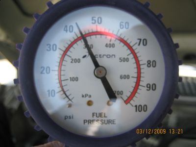

Dear Rasmataz, I've attached a photo of the reading for the fuel pressure. I love this gauge!!! So easy to use and accurate.
https://images.2carpros.com/forum/automotive_pictures/316478_IMG_1449_1.jpg
The pressure only read at 43 psi and never 34 psi at idle like it states in the manual. Do I pull the vacuum line off of the fuel reg. to get the pressure to go down to 34 psi.? The injectors all read 8.5 ohms across the terminals(10-14 ohms @ 77*F is the spec.) All harnesses have battery voltage present and all injectors make the 'clicking' sound as the solenoid pulses on/off. So no problems there. Any other thoughts? Thank You!!!
Mar 12, 2009 at 11:39 AM
  • 75,992 POSTS
My engine starts up fine but the idle is very rough and the engine stalls. Did you check the EGR and PCV valves to include the TPS
Pressure gauge looks pretty-Okay when you remove the vacuum line from the pressure regulator the fuel pressure should increase and when vacuum hose is connected this is where the regulator should regulate 34 psi-In the event the pressure is still high while vacuum hose is connected -check the fuel return line if its clogged up-blow thru it with compress air. No clog replace the regulator
