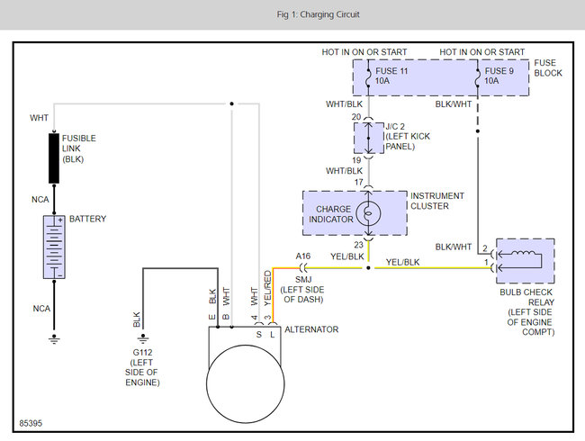

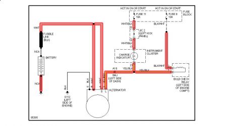

I have a 1997 Nissan Pickup that will not charge the battery. I have replaced the battery and the alternator and both test good. Can anyone help?

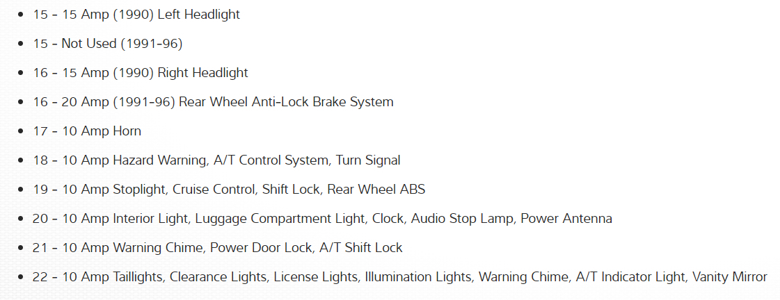

There are two fuses and a fusible link that need to be checked to make sure they are not blown.
Here are a couple of guides and a alternator wiring diagram so you can do some quick tests.
and

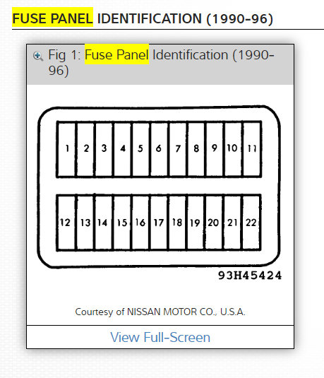

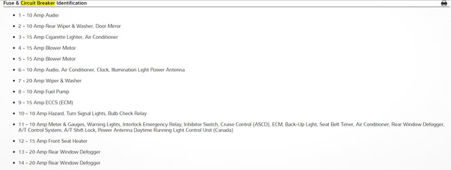

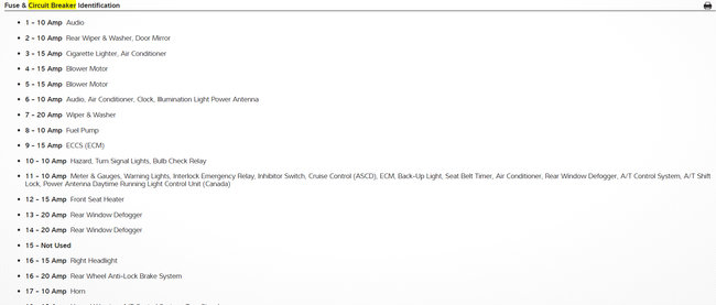

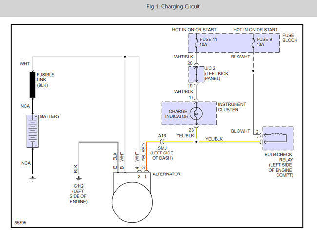

Check fuse no. 9 and 11 if okay-look at the charge system EWD If both tested good than you have a wiring problem or the charge indicator
https://images.2carpros.com/forum/automotive_pictures/12900_nissan_charge_1.jpg

Disconnect the alternator and check for power at the yellow and red wire do you have it if not check the charge indicator and check bulb relay-

the Charge Indicator light comes on with the key as it is supposed to, and then is extinguished once the car is started. The Bulb relay is another story, how do I test this relay?
Aug 28, 2009 at 4:06 PM
  • 75,992 POSTS
Do you have a multi meter if so the coil side should read 40-80ohms, switch side infinite no meter swap it with a like one.

I checked the fuses 9 and 11 and I checked the fusible links. The battery charges on a charger to a perfect 12/6. When the battery is fully charged the alternator is putting out 14.4 volts. But over the. Of a couple of days it dies.

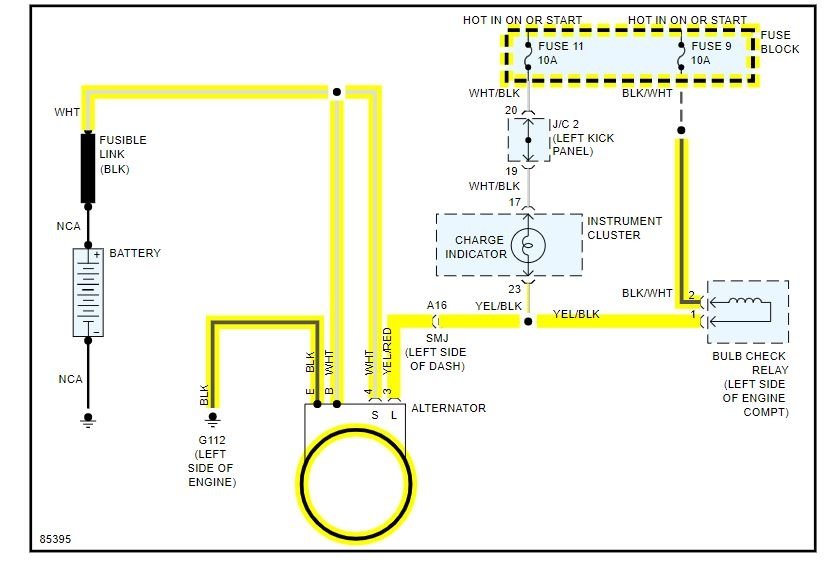

Does your meter have an amp clamp to measure current output back to the battery? You need this to monitor the output.
The other possibility is the belt and tensioner. If you have a loose belt or bad tensioner, you will have voltage but very low current output.

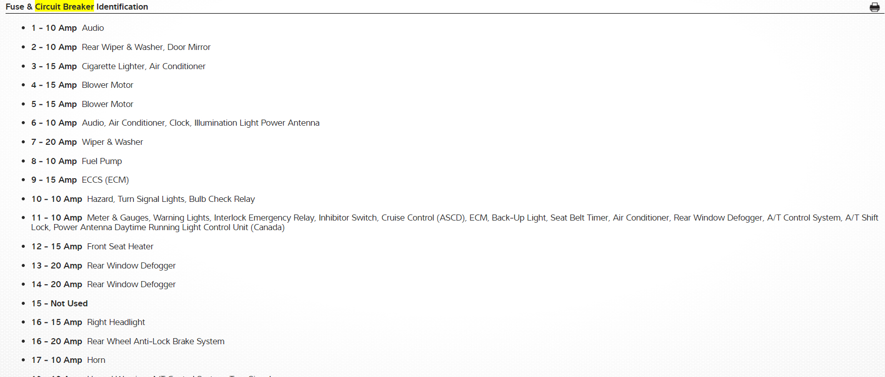

Verify that both white wires at the back of the alternator have battery voltage as well. Check the fuses I highlighted.
Lastly, when you check the charge rate with the engine running, switch your volt reading to AC volts and see if you have a reading.

second alternator, new battery, alternator does not charge at all, charging warning light never comes on, the bulb in dash in fine have checked that but warning light does not even light up when key is just in on position. Is there a relay for this warning light?

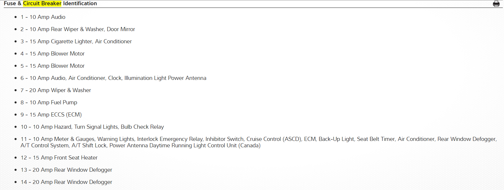

There is a fuse #9 and #11 and the battery light must work as well here is the alternator wiring diagrams so you can see how the system works and the fuse locations with a guide to help you check for power.
Check out the diagrams (Below). Please let us know what you find. We are interested to see what it is.

Fusible link checks good with ohm meter so I checked the fuses and found corrosion on #11 cleaned it all up charges great! I love this site.

Not sure why I'm unable to view your reply!? I did locate the fusible link (ohm checked good). Upon further troubleshooting discovered connector on top of alternator was not locked which broke the ground connection to battery lamp. Locked it into place and works great now. Thank you!
