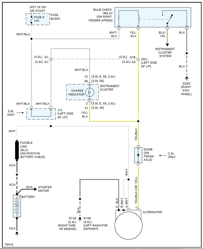

I'm installing an alternator in a 1990 Nissan pickup, 2.4 (130k miles) and want to be sure I have the wiring correct. Where might I find a picture, diagram or schematic?

What's wrong with the old one. Here is the wiring diagrams and guide to help test the connections.
Check out the images (below). Let us know how it goes

Died, failed tests, installing replacement, not sure of wiring.

Just reverse everything you did,when you remove the old one, shouldn't mess up-its gravy
