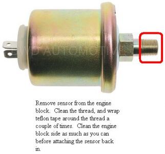

I have an oil leak above the motor mount on the passenger side and its coming out of a sensor there are two wires going into it and oil is just pouring out of where the wires go in. Is that a sensor? Or what is it and how do I repair it? Thank you!

While it is most likely the oil pressure switch, I wouldn't for sure not knowing the Nissan model you have.
Please provide me the model and the engine size. For example: 1985 Nissan Pulsar NX 1.6L 4-cylinder

1985 Nissan 720 pickup, 2.4L, 4cyl engine. I hope this helps. Thanks again.

https://images.2carpros.com/forum/automotive_pictures/55316_85720plug_2.jpg
That is your oil pressure sending unit. Instruction is on the photo.
