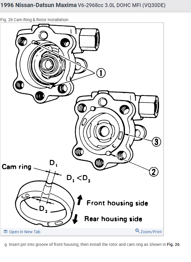

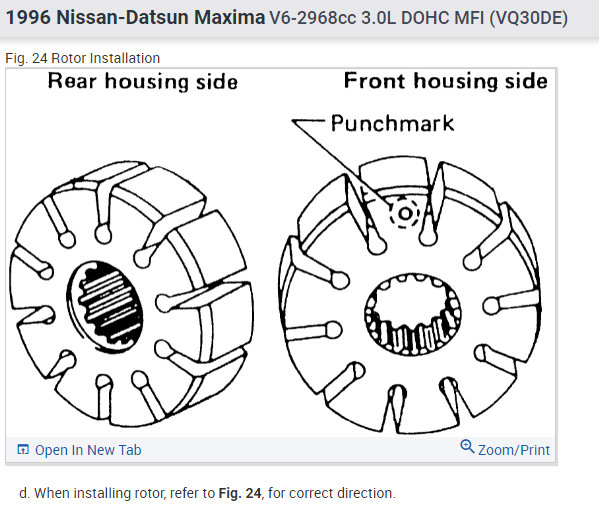

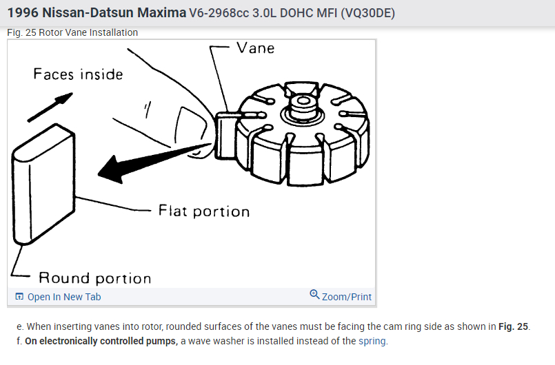

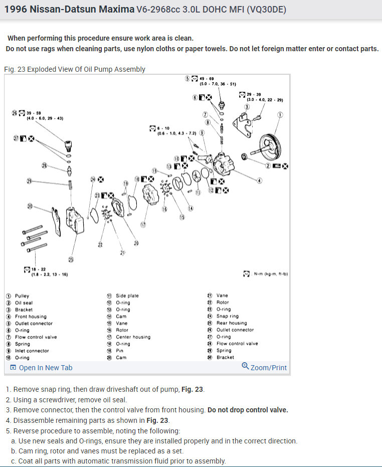

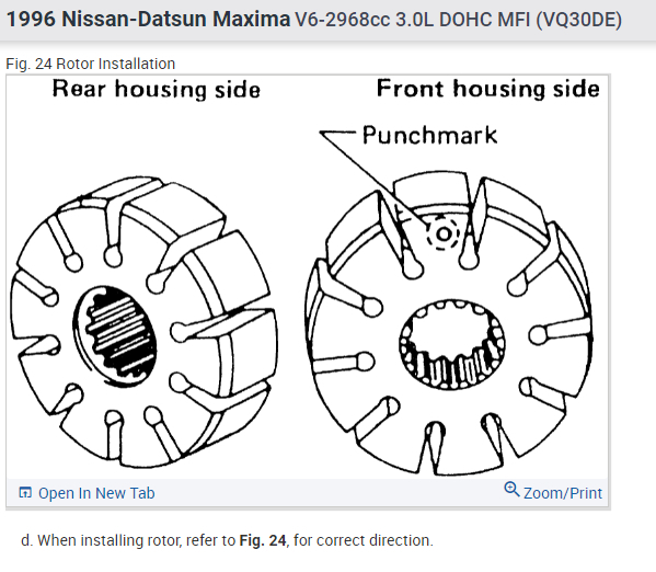

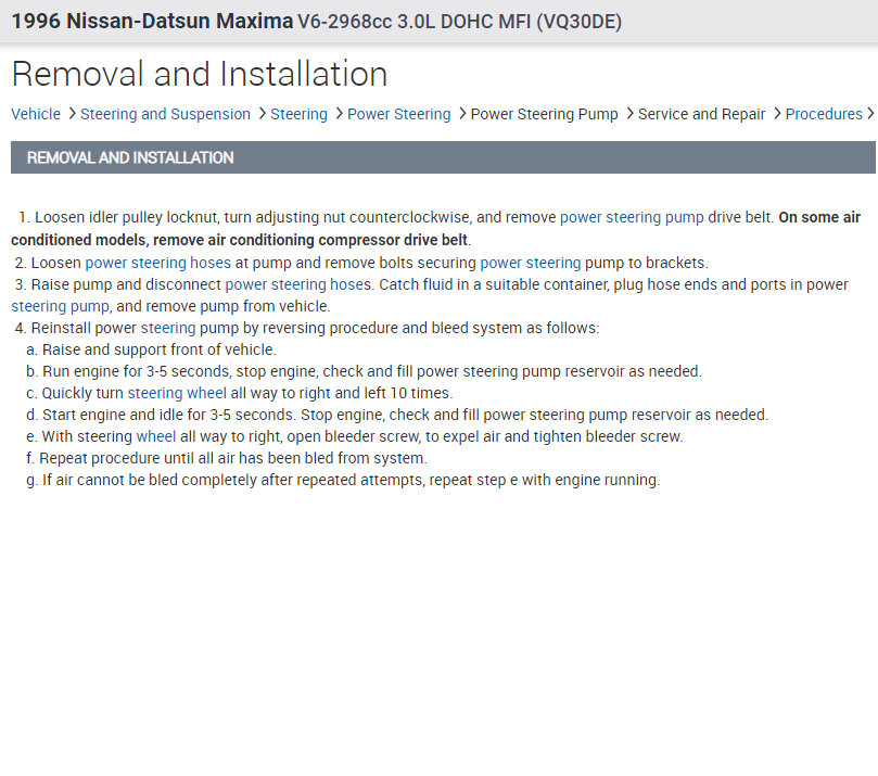

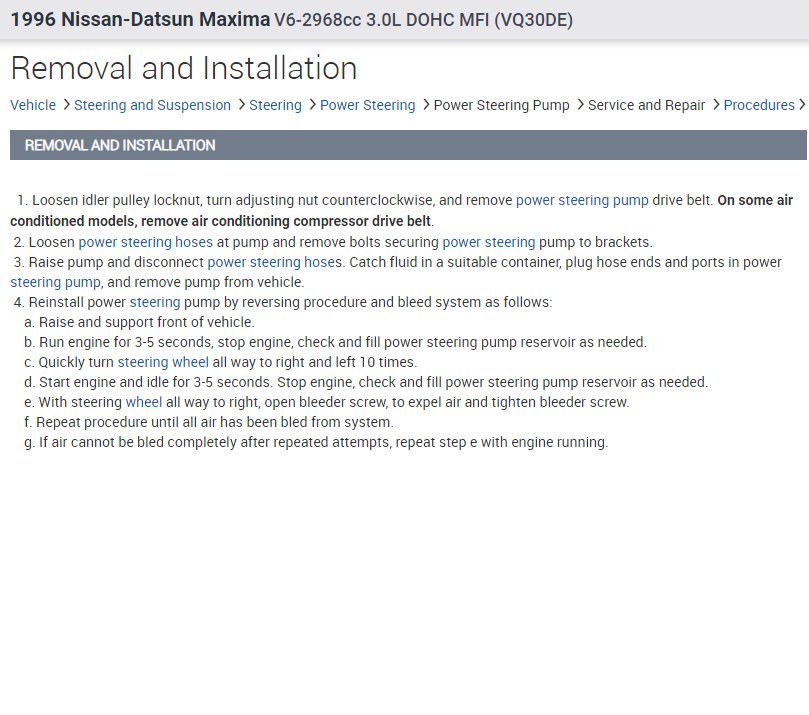

It sounds like you might have an issue with the power steering pump.
When the pump is cold it has difficult time circulating fluid but as it warms up the internals gets lubricated and you are able to turn the steering wheel easily.
Make sure that the fluid level is correct. As low fluid can trigger hard steering at cold temperature.
Are you hearing any type of noise when turning?
You might find these articles helpful:
https://www.2carpros.com/articles/power-steering-problems
https://www.2carpros.com/articles/how-to-replace-a-power-steering-pump
