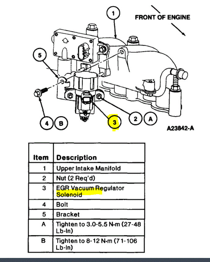

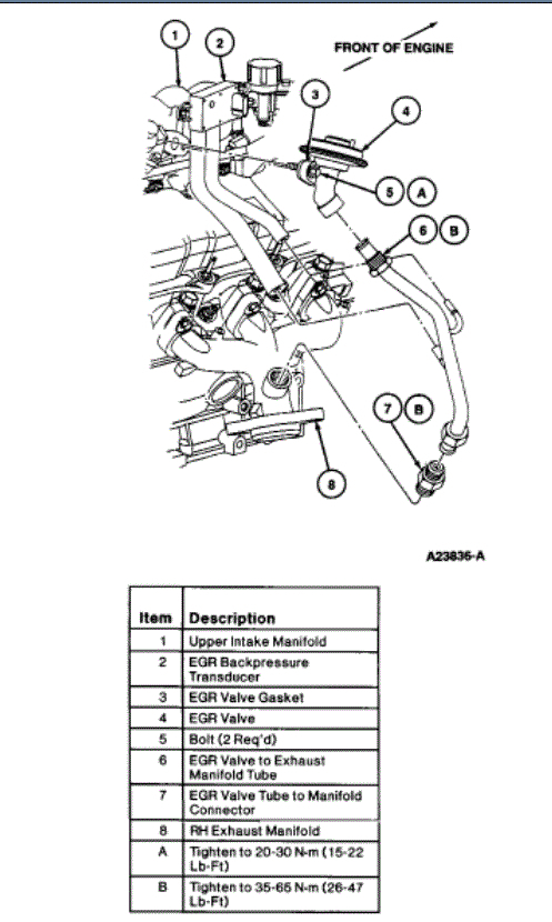

You are correct. It is related to the EGR. When you replaced it, did you inspect the intake where it mounts for carbon or any restrictions? Also, is there a vacuum to the EGR? The code is specific to the EGR being stuck closed. Also, is the code still present?

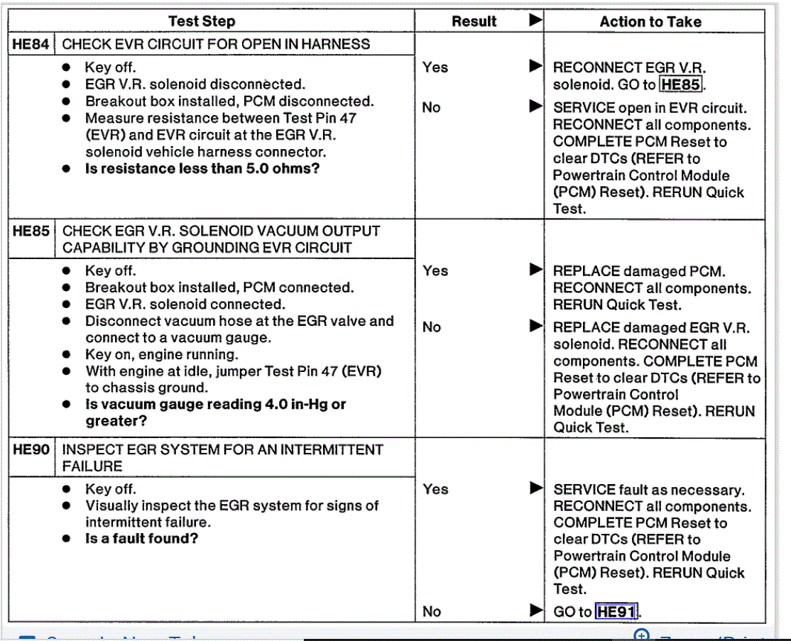

There is an EGR vacuum regulator that can be bad as well. If you look at the pic below, I attached a pic of it. Have you inspected that component for vacuum leaks or the connector for electrical issues?
See pic below.
Feb 17, 2022 at 7:17 AM

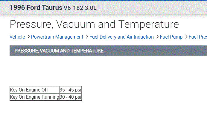

I went ahead a replaced the fuel filter, I then rented a fuel pressure gauge kit. I believe it should be anywhere from 37-48 range yet, idling it didn't go pass 25 and revving the engine it didn't get pass 31. Is it possible the fuel pump needs to be replaced? The car cranks over, starts, but the engine dies immediately. Besides a smoke machine is there a less expensive way to check if there are vacuum leaks? Oh, by the way I still have the same codes.
Mar 1, 2022 at 10:12 PM
  • 110,248 POSTS

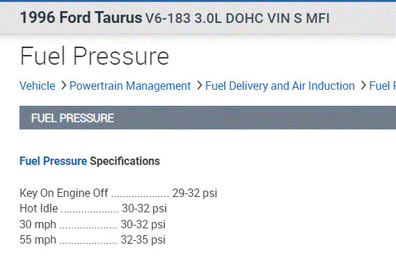

The specs indicate 30 to 32 psi at idle and up to 30MPH. I attached them below. The 25 is low, so it may be the fuel pump is just weak.
As far as checking for vacuum leaks, you can use carburetor cleaner. Here is a link that explains how it's done:
Let me know if that helps.
See pic below (pressure specifications).

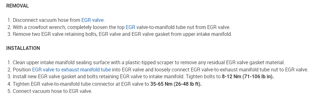

I am sorry to hear this hasn't been resolved. If the P0401 is still present, we need to do is remove the EGR valve and check things ourselves. There are several things that can cause the code, but the code simply indicated an insufficient EGR flow problem.
Has anyone confirmed the intake where the EGR port is clean and free of debris? If not, that is where I would start. If it is clear, then we need to next test for an electrical issue that can also cause the issue. Take a look below and let me know if you are comfortable doing what is listed.
However, I would start by removing the EGR and inspecting the EGR port for restrictions. Follow the directions in pics 2 and 3 which are how to remove and replace the EGR. Once it is off, then check where it mounts on the intake manifold for evidence of carbon or anything that can restrict airflow.
Let me know what I can do to help.

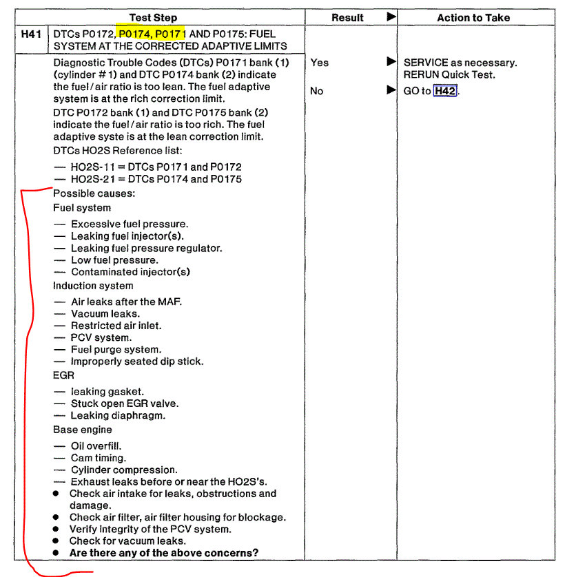

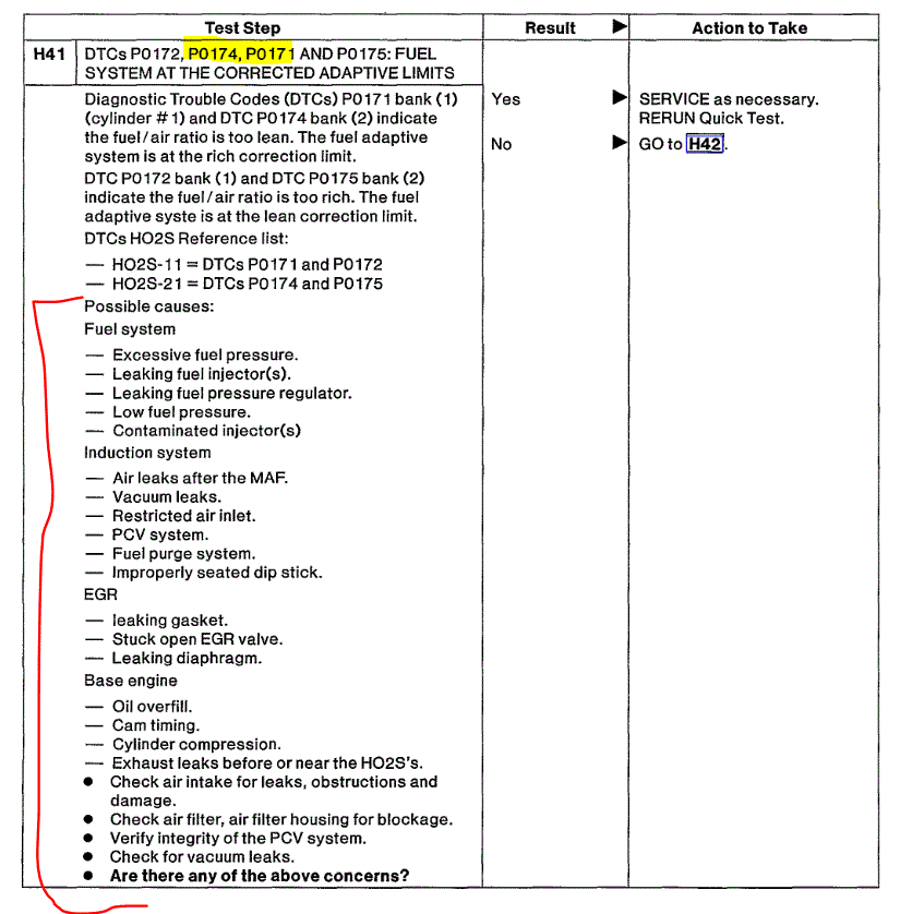

  • 110,248 POSTS
Based on the codes you provided, it's getting too much fuel. If could be a few different things. However, I suspect it is fuel pressure related. Take a look below. I provided the info below related to both codes.
The first thing I recommend is to check fuel pressure. The fuel pressure regulator could be bad.
See pic below.
May 17, 2022 at 12:50 PM

They replaced the fuel regulator, what about the mass airflow sensor. Remember, i have a new fuel pump, regulator, filter, EGR valve/solenoid, everything i recently described and now these codes, The purpose of me replacing the pump was originally because of those two codes. I mentioned earlier i rented a fuel pressure gauge and based on the numbers i determined the pump was bad. Now I am getting the 171 and 174 codes. Please any ideas, i am so frustrated because all the time the mechanic had the car they still can't seem to figure it out. Again, i wasn't charged, but how do i pinpoint exactly what the issue is?
May 18, 2022 at 1:09 AM
  • 110,248 POSTS
If the mass airflow sensor is faulty, it can cause either a lean or a rich fuel mixture based on how it's reading. Do me a favor, we can do this one of two ways. First, you can try cleaning the MAF to see if it takes care of the issue.
Here is a link that explains how it's done. Note that you should purchase a cleaner made specifically for the MAF.
https://www.2carpros.com/articles/mass-air-flow-service

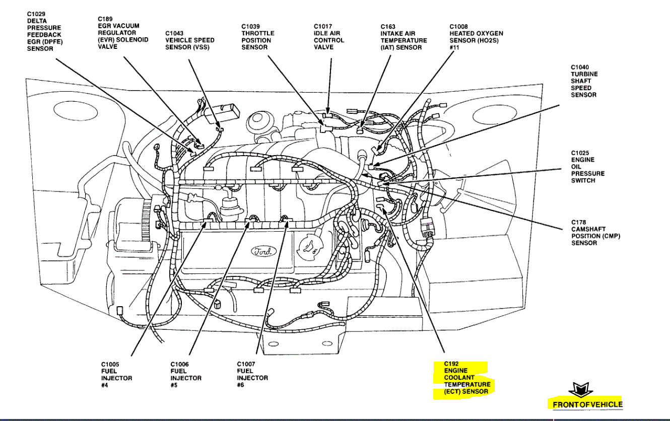

Second, clear the codes and disconnect the sensor. That will force it into a predetermined setting and should indicate a code for the MAF and not the other issue.
If you have a live data scan tool, check to see if the ECT (engine coolant temperature sensor) is signaling an accurate temperature. Do this with the engine cold. It should be very close to the ambient temperature. If it is faulty and telling the PCM it's -40F, the ECM doesn't know it's wrong and makes the fuel mixture very rich to run in such cold temperatures. See pic 1 for location.
Also, we could check the voltages at the O2 sensors to see if they are off causing a rich mixture.
Is the P0401 still active?
See pic below.
May 18, 2022 at 12:54 PM

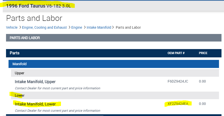

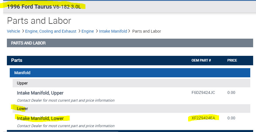

It's the lower intake manifold.
Jul 5, 2022 at 11:14 AM
  • 110,248 POSTS
The lower intake manifold isn't difficult to find. The original part number for it is XF2Z9424EA. If you type in Ford part number XF2Z9424EA, it will bring up places selling it. The only issue is cost. They are expensive new. However, take some time and see if you can possibly find a used one from a salvage yard or even eBay.
Let me know if there's anything I can do to help.
Jul 5, 2022 at 3:20 PM
DBROCK123
  • 40 POSTS

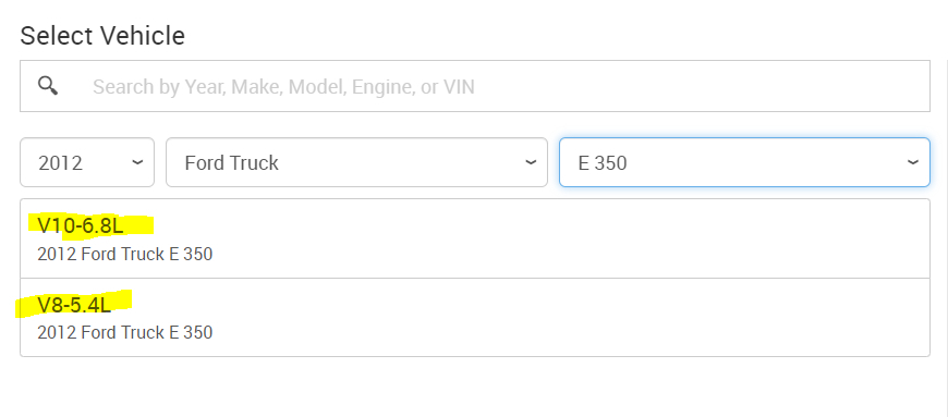

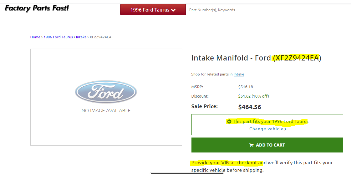

Hey Joe, been awhile. Just to keep you updated. The light hasn't come on since, except today. I Googled the part number and it said this: Intake Manifold - Ford (XF2Z9424EA)
MSRP: $516.18
Discount: $51.62 (10% off)
Sale Price: $464.56
This part does not fit your 2012 Ford E-350 Super Duty
Change vehicle
But it also said this below : Intake Manifold - Ford (4C3Z-9424-AA)
Shop for related parts in Engine Parts
MSRP: $276.67
Discount: $89.92 (32.50% off)
Sale Price: $186.75
This part fits your 2012 Ford E-350 Super Duty
Change vehicle
Do I need to confirm the VIN number to insure it fits?
Aug 5, 2022 at 4:43 AM
  • 110,248 POSTS

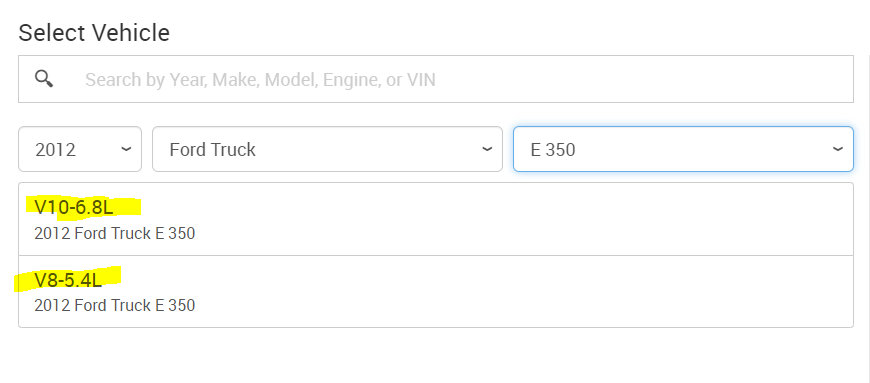

Where are you getting that information? I don't feel either of the vehicles they indicated would have a 3.0L.
In 1996, they had a standard 3.0L, one that could run on flex fuel, and one that had a duel overhead cam which I believe was in the SHO. It was a high performance. The part number I gave you is for the standard one or the one that can use flex fuel. If you do have the DOHC engine, that would be different.
Just to confirm, I looked up a 2012 E350 super duty. See pic 3. It either had a V8 or a V10 engine.
Aug 5, 2022 at 11:38 AM
DBROCK123
  • 40 POSTS
Joe, you sent me that number and I googled it like you suggested. This is for my 96 Ford Taurus.
