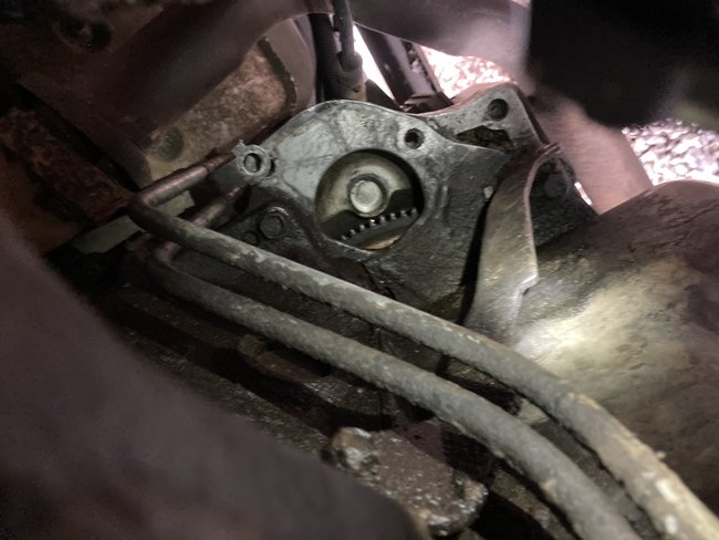

I can hear starter spinning but motor is not trying to turn over. What can I try to do to fix this?

Is the starter engaging with the engine and turning the engine? Or, do you just hear the starter spinning?
As far as not starting, it could be a few things. If the starter is turning the engine, you may not be getting fuel or spark to the plugs. Let me know if the engine is turning. If it is, take a look through this link. It explains the most common causes of a crank no start condition.

I took the starter off and inspected the flywheel inside the bellhousing. I believe that I did not have the starter gears lined up with the flywheel. Thank you for your help!!!

Be sure that ring bracket on the left side goes to the outside of the starter and not between it and the block, it would cause the nose of the starter to move enough that it wouldn't engage the ring gear.
