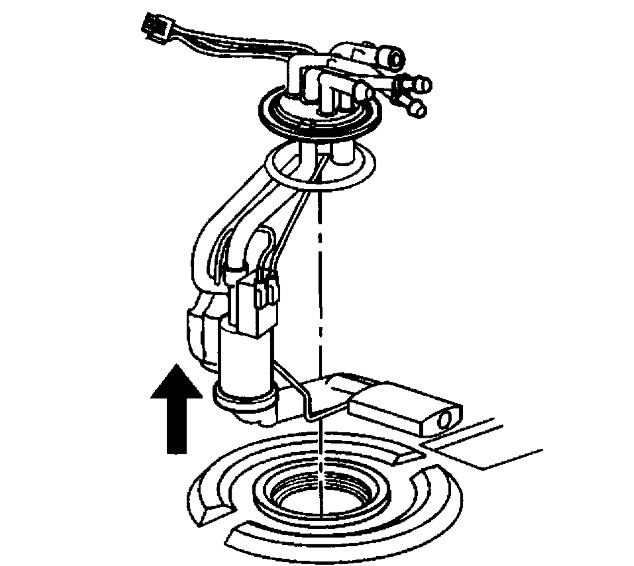

The pump does not come on at all. Is there a way to take the pump out of the tank and test the wires going into the tank to make sure that the power going all the way down to the pump?
Thursday, April 9th, 2020 AT 2:45 PM
  • 52,797 POSTS
You would need to drop the tank and remove the pump.The tank has to come down to gain access to the pump.

Right now it's getting a little cold and dark outside. So tomorrow when I get off work I'm going to drop the fuel tank out but there is a black and a red wire that go to the actual pump itself. Should I just have the test light held to a good ground and to the red wire to see if it's getting power to where the pump should connect?
Thursday, April 9th, 2020 AT 4:19 PM
GREENPHANTOM311
  • 16 POSTS
Because I would like to make sure that the actual sending unit is in good working order because as long as the sending unit is in good working order I should just be able to replace the actual pump itself correct?
Thursday, April 9th, 2020 AT 4:20 PM
  • 52,797 POSTS
That is correct.
The gray and black are the fuel pump wires and the purple and black are the sender wires.
