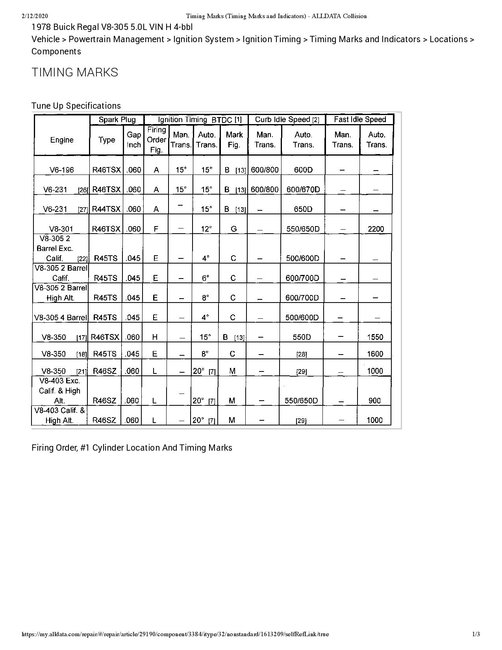

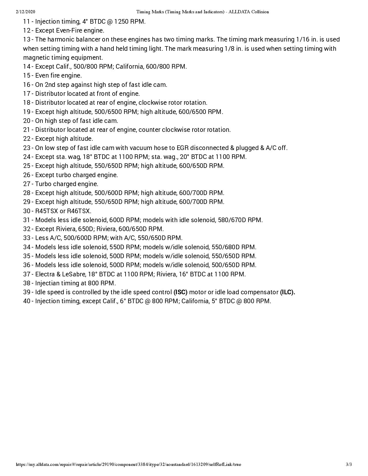

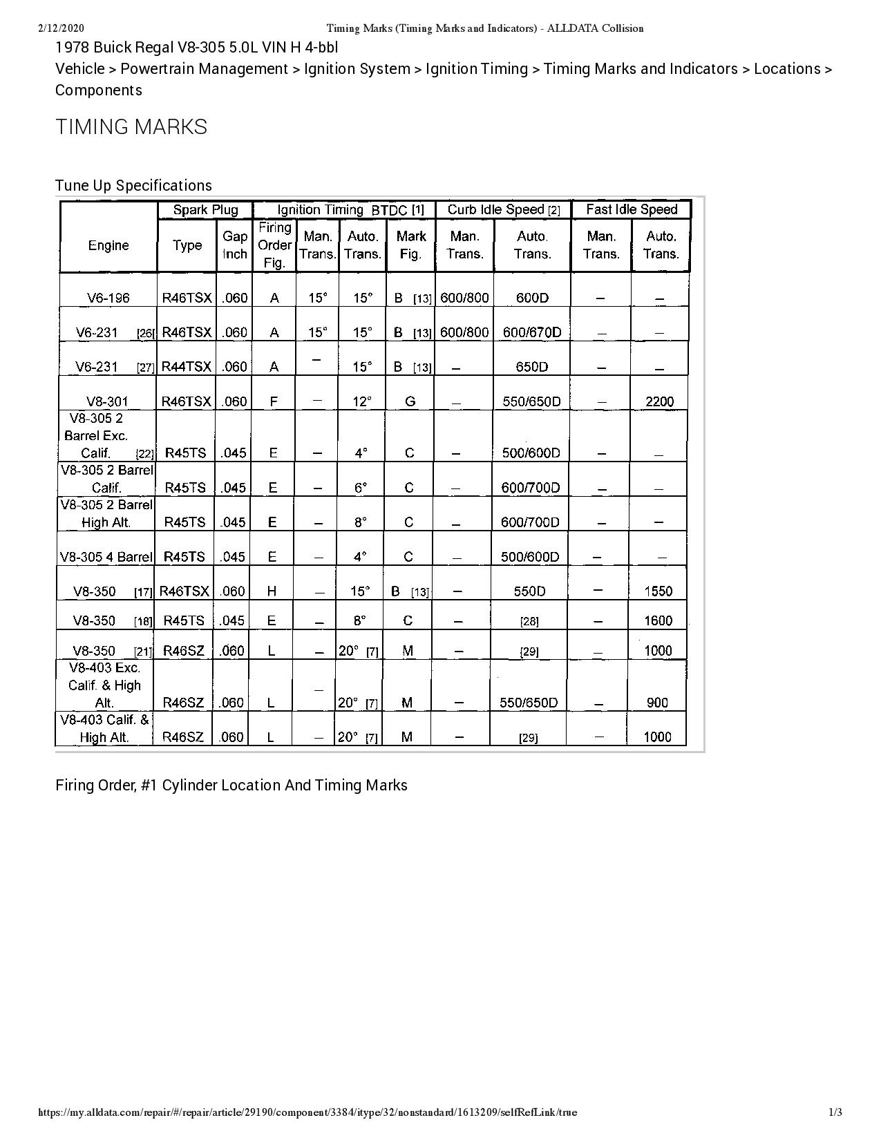

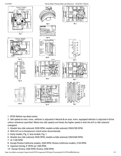

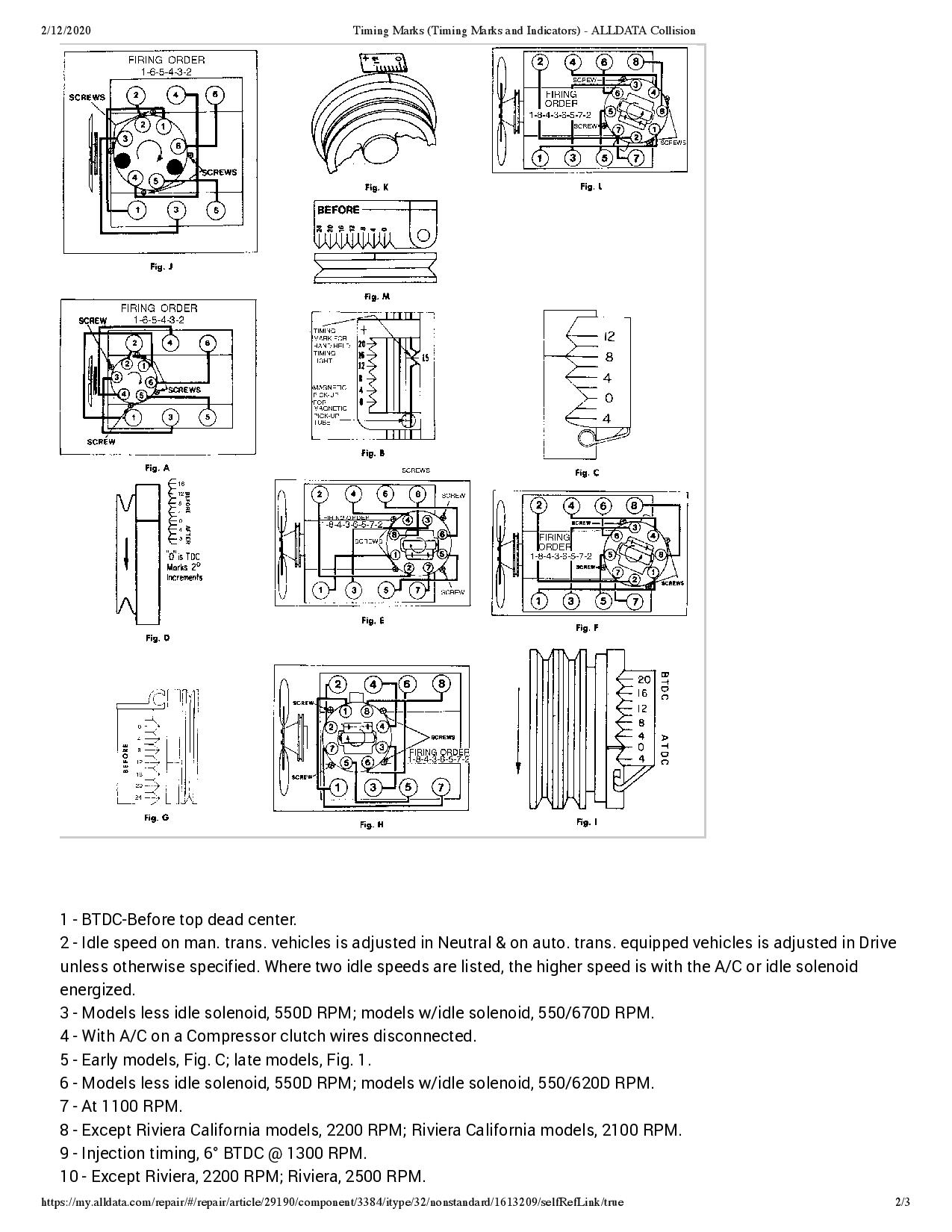

I have attached the specs for adjusting the ignition timing.
How did you set the ignition timing when installing the distributor?
Did you install the distributor before the carburetor and has it run with the new distributor installed?

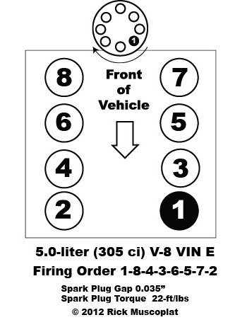

Okay, I believe I see what I messed up on. This is the firing order I looked up on Google and this is the way I hooked up the wires. I'm guessing I did it wrong?

Crisis averted! It was the wires I hooked all of them up wrong but when I fixed it she fired right up and went straight to idle with no misfires thankfully.
