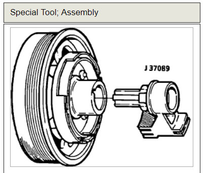

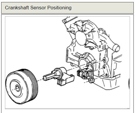

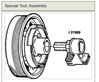

This sounds like a problem with the crankshaft angle sensor not getting a signal to the ECM. Here is a guide that will show you what you are in for when doing the job.
This guide can help as well
You will need to remove the balancer to replace the sensor
https://www.2carpros.com/articles/how-a-harmonic-balancer-works
Here is how to change the sensor on your car
