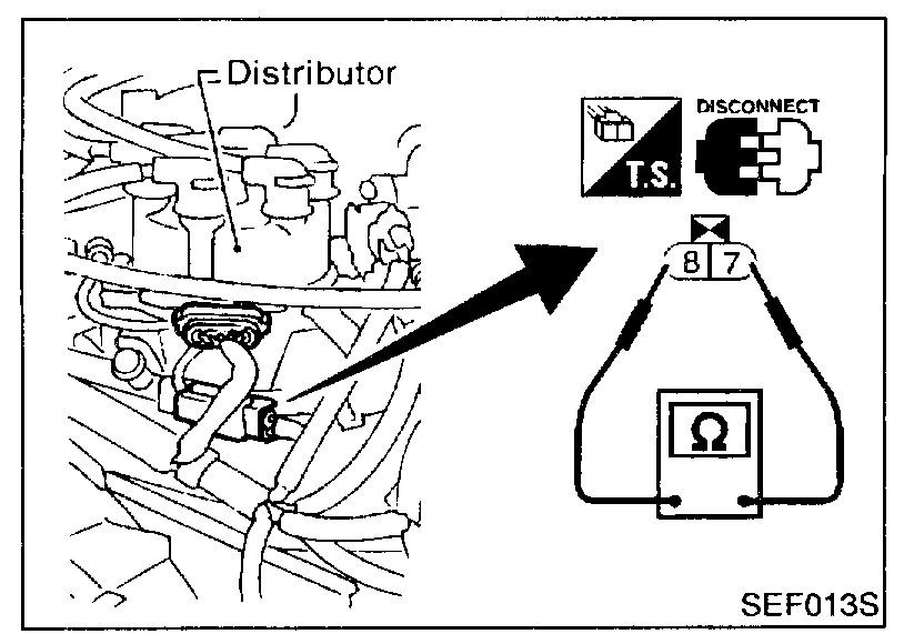

The whole distributor has been changed along with; crank sensor, spark plug wires, new battery, and new timing belt. is there a possibility that the new cam or coil came defective? is there a way to bench test them? fuel pump does not turn on i don't hear it prime. I checked all fuses and they are okay. please help.

thanks to Joe. Yes, I checked for spark and nothing. also I did put starting fluid it cranks but no start. the distributor is receiving12 volts in wire # 5 also ground in wire #6. thank you for your time and assistance.

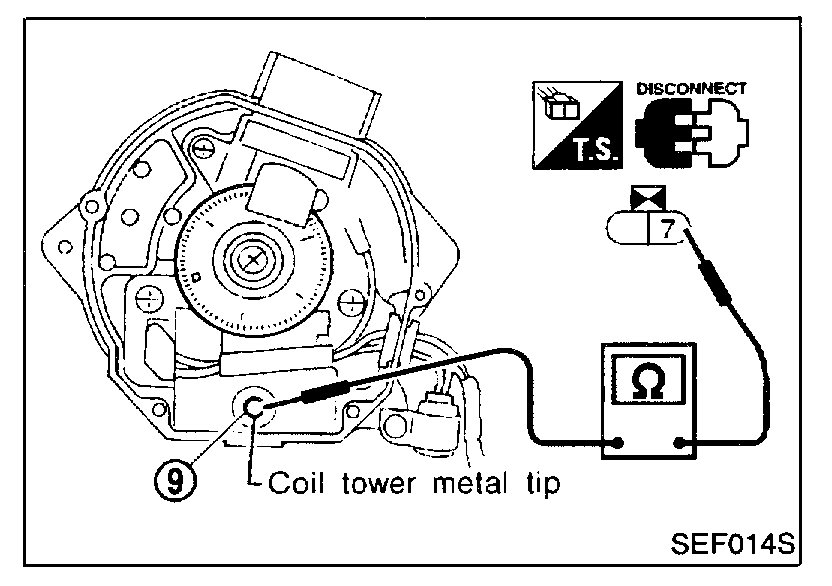

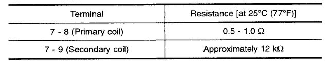

It sounds like the coil has failed, but to confirm, please follow these diagnostic directions. If the coil is bad, the distributor needs to be replaced. I will help with that if needed.
The attached pics below correlate with the diagnostics.

IGNITION COIL
1. Disconnect ignition coil harness connector.
see pic 1
see pic 2
See pic 3
2. Check resistance as shown in the figure.
For checking secondary coil, remove the distributor cap and measure resistance between coil tower metal tip 9 and terminal 7. If NG, replace distributor assembly as a unit.
