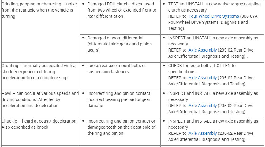

My vehicle listed above does a noise when turning left or right.
Jun 23, 2023 at 5:27 AM
  • 110,240 POSTS

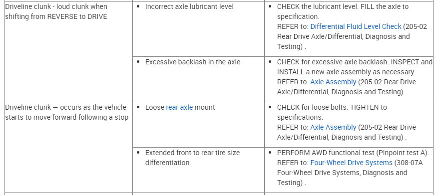

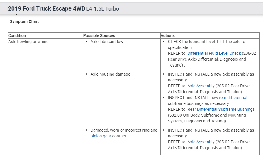

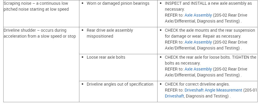

How would you best describe the noise? For example, does it sound like a clicking sound, a humming sound, or something different? (See pics below for sound to possible cause)
Also, have you noticed any oil leaks from the rear differential? Have you checked the fluid level in the differential?
With only 21K in the vehicle, it is hard to believe the differential would be failing. However, anything is possible.
Let me know how you would best describe the sound. Also, if it is loud enough for you to record, please do so and upload it for me to hear.
