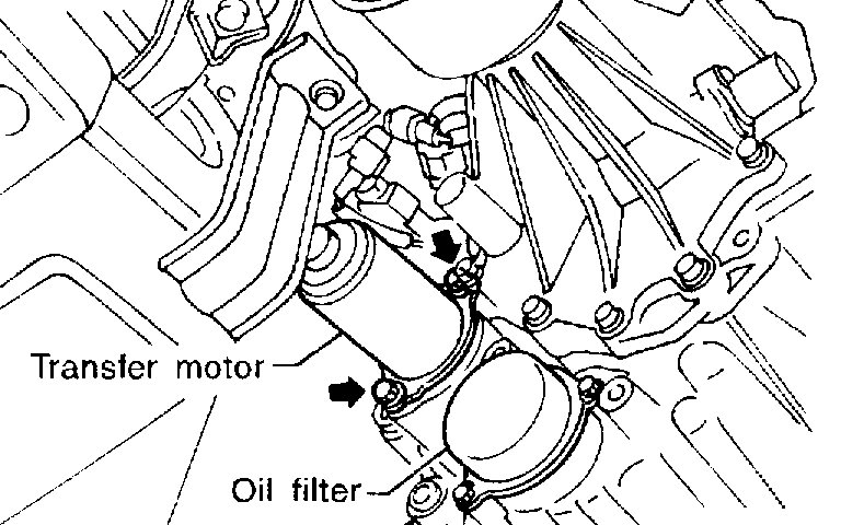

Sure, the car moved well the first two days. But now, I drive only using 2w. If I use the 4WD, AUTO, or 4H or 4LO, the car does not select beyond two forward gear. Now I cannot even use the 4WD in the mud or sand. If I do, the car does not select more than first and second forward gears. And it keeps revving. What do I need to do?

As at now, I have disconnected the auxiliary gear. If the auxiliary I connected, it does not select more than first and second forward gears.

Hi again. I am not sure I totally understand what is happening and what you have done. The 4wd options are not working? Also, when you say you disconnected the auxiliary gear, what are you referring to?

Hi Joe, thank you for stepping in. Yes, the 4wd options are not working.
Secondly, I had to disconnect the auxiliary propeller, so that I can move the car as it could not select gears on movement.

When you shift into a gear, does the indicator show you have changed gears? Also, check to make sure the connectors to the transfer case actuator motor are clean and tight. I attached a picture of their location.
Note: Prior to removing the drive shaft (propeller), would the car move in neutral?

Hi Joe, thank you. Before removing the drive shift, it was not moving in neutral.
2). When I shift into gear, the indicator shows that I have changed gears.

Make sure the shifter linkage is attached at the transmission, too.

Hi Joe, thank you for your expert advice. You are the best! I tried it all, it worked like magic. The car is crooning like a child. I really, really appreciate your experience and expertise.

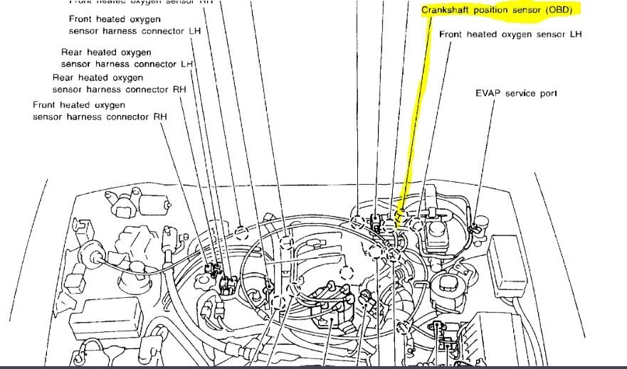

Hi Joe, I am back again. This time, the car engine overheat. The technician replaced the top gasket. Coupled it back, the car would crank, but won't start. The pressure is okay, fuel supply too, okay. He reset the timing chain, the electrician had it checked, But no power to the spark plugs. All spark plugs new. Why do I need to do?

No start again? Since the work was done, make sure the crankshaft position sensor wasn't left disconnected or the wiring to it was damaged.
See picture 1
Let me know. I have a feeling something was left disconnected.
