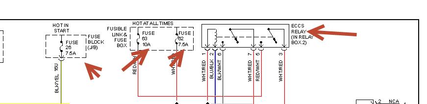

LOBENTON
Hello hmac300 thank you for your response. Before having the distributor and crankshaft position sensor replaced I had the codes scanned and it gave the code for the crankshaft position sensor. And I dont know how to check the fuel pressure. The mechanic I had working on my car said that it is not anything with the fuel but I dont really know I have been gtting the run around for a month now
-1
Tuesday, December 17th, 2019 AT 3:40 PM (Merged)
HMAC300
  • 48,601 POSTS
Check the fuses and relay in pic use a like relay to check your current one. Other than that this really needs to be looked at by a pro to fix it. You can also try wiggling where your cranks sensor wires are to see if it's abadconnection it may start. If it does you know to replace the wire connection. But try the fuses and relay first. One other thing try resetting your anti theft, which I don't know how to do but if you have a manual it should tell you. Also if you have another key try that that also works sometimes.
