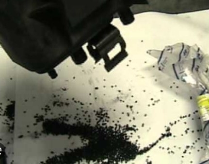

Just looking at the outside of it won't tell you anything, that doesn't look new at all, you need to be able to see if the charcoal inside has broken apart, and believe me when it comes apart, it ends up in tiny particles that get stuck throughout the Evap vapor hoses all the way up to the purge valve. You can pull the purge valve off and see if it's stuck open, but if you find it is, tap it out and see if any black dirt particles come out, that's charcoal, and if so, the new purge valve you install will just get clogged up again. I see a lot of rust there, take the Vent valve off and inspect it as well.

Okay, I also tried turned it on 2 the first time I got a strong fumes smell but then went away the 2nd time after 5 minutes there wasn't any smell.

That's because the engine vacuum is pulling all the fumes into the engine, with that much vapor loss is not safe.

When I look inside do I have to disconnect all the lines because one of the hose clamps look too rusty to uninstall and install.

Just replace the hose clamp, no biggie, after checking the Purge valve for sticking, if you find it is stuck open partially, tap it on the ground and see if any black charcoal bits fall out. Do the same with the canister, the charcoal might come out like this, all broken up into tiny pieces, these then get sucked into the evap hose going to the purge valve and then the intake manifold, being pulled by the engine's intake manifold vacuum. You need to be sure if the purge valve has failed. Below is a failed canister, you shouldn't be smelling any gas outside or inside the vehicle. If it is pulling gas into the intake, it will eventually ruin the catalytic converter(s), then you'll be paying thousands to replace them, so do yourself the favor of checking the system. There's no check engine light setting yet, but it will happen soon. Check the filler neck as well, there are rubber hoses going down to the tank, look for any wet areas or areas that have collected a lot of dirt from possibly being wet with gas. If you can see on top of the gas tank as well, try to take a look on top where the hoses enter the tank, look for leaks.
