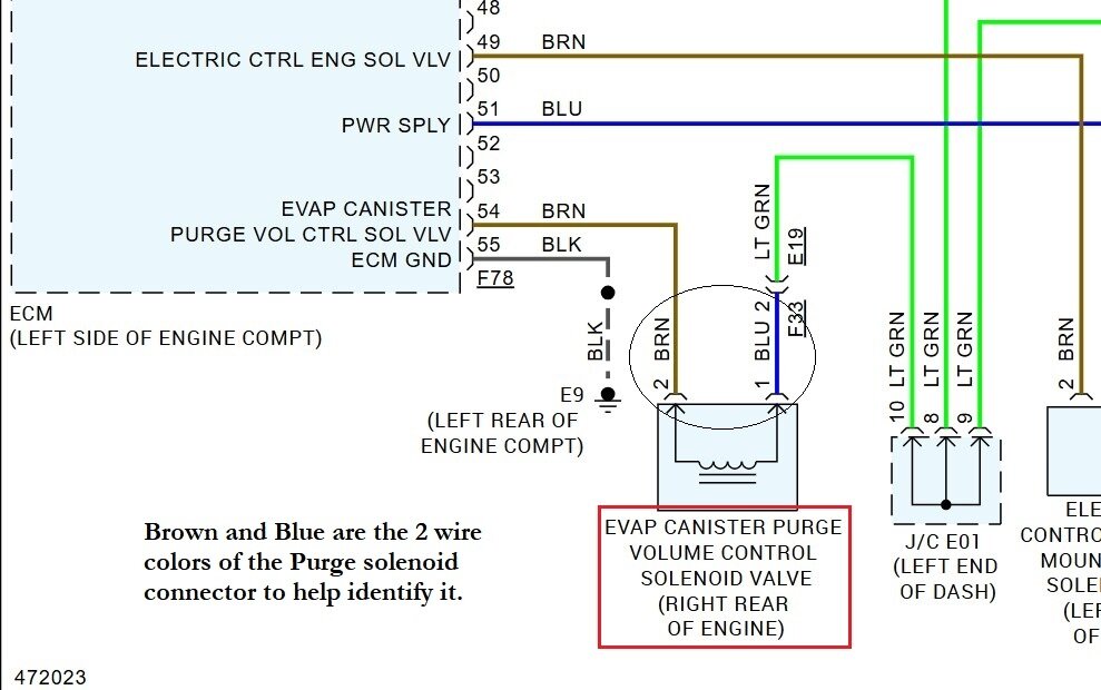

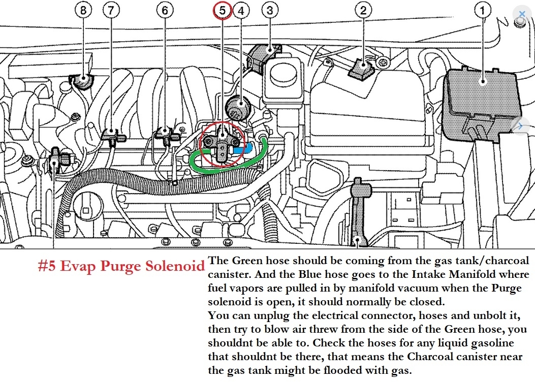

Hello, I would check the Evap purge solenoid for a couple things, first make sure its fully closed when it unplugged, you can unbolt it and see if you can blow air through it, I'll post a diagram of its location. And 2nd check the vacuum and vapor lines going to it and from it to the intake manifold for any liquid gasoline. Since the purge valve is only made to pull fuel vapors from the gas tank.

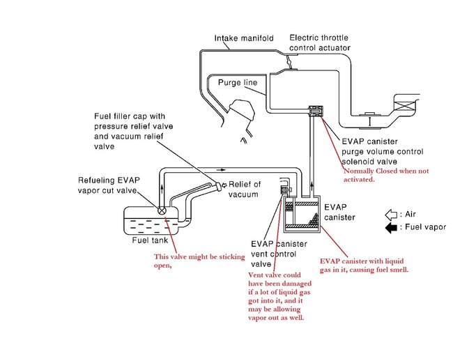

What code was it setting for the air box? Yeah, many people overfill the tank, not knowing its possible, but the handle at the gas station clicks off when it detects vapor coming out, showing the tank is full. So what happens when the Charcoal canister comes into contact with liquid gas is the charcoal inside starts to break apart and tiny pieces of it end up being pulled into the vapor hoses which lead to the Purge Solenoid, and once its clogged up with those tiny pieces and/or liquid gas is the solenoid sticks open, it doesn't even have to be fully open, just enough for intake manifold vacuum to pull excessive vapor and gas into the engine.
The engine computer monitors the gas tank pressure by a very sensitive sensor, but many systems work differently but the same idea. There is a Vent Solenoid that allows fresh air into the Canister while the vapors are being pulled, but when you get down to 1/3 or 1/4 tank of gas, there could be too much air being drawn into the vapor management system due to gas damaging certain parts, and you might be running into a lean misfire at that point, but Ill post some service info for you to see where these components are located, the Charcoal canister is normally located back by the gas tank, you'll have to take a look for it but it's difficult to miss.

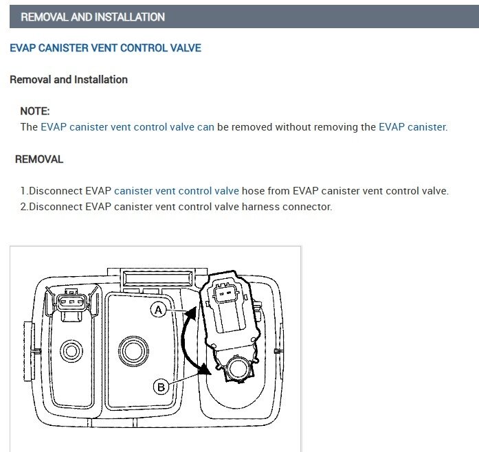

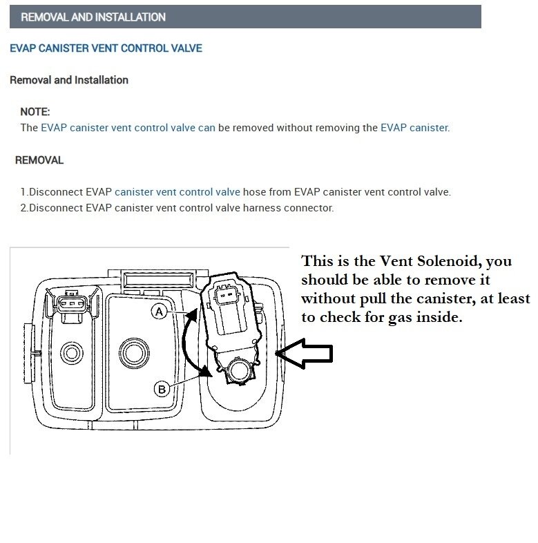

You should be able to take the hose off or if possible shake the canister and see if you hear any gasoline sloshing around inside, the best thing to do is take the canister off if possible and check for bits of charcoal falling out, then you'll know the canister is junk, but below, the 1st and 2nd diagrams are for checking the Purge Solenoid which is located in the engine compartment, you might need to remove the engine cover to see it.

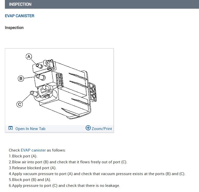

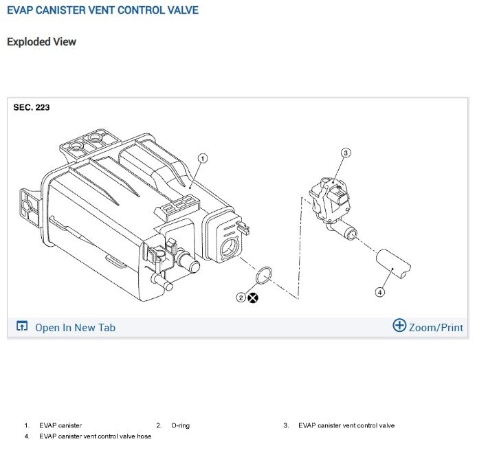

Diagrams 3,4 are the Canister and the Vent valve that's attached to it. Both should be checked. Here are some guides, although you're not really dealing with an external leak at this point, most likely the Purge valve is not fully closing, so start there and let us know what you find.

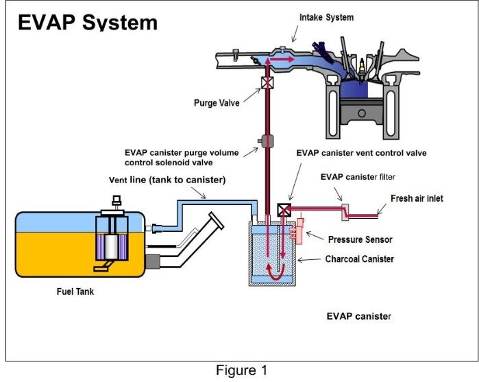

The 5th diagram is of the entire Vapor management system, it shows how it works, it takes very specific conditions for the Evap monitors to run, so I think this would have eventually set a code for something related.

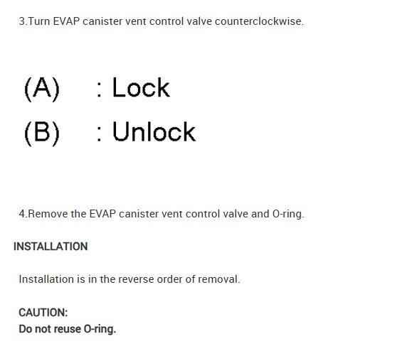

If you can get to the hoses attached to it, just try disconnecting some and see if any gas comes out, I'm not really sure how much is in the way on a 2015 to get the canister out or at least pull some hoses off, sorry I should have added the 2nd part to the Vent solenoid removal, it locks into position by turning it (2nd diagram). Once you have it out, try to shake the canister if you can,
With this Canister inspection diagram (3) try putting a piece of hose on the B port, block the A port and blow some air through it, see what comes out, you might find gas dripping out if you remove the Vent solenoid, if you're smelling gas that much, something to keep in mind is the hotter it is outside the more gas vapors are going to be generated, and that's not a good situation, use a flash light and inspect as much as you can, if you are able, take a look at the top of the gas tank as well, just to be sure.

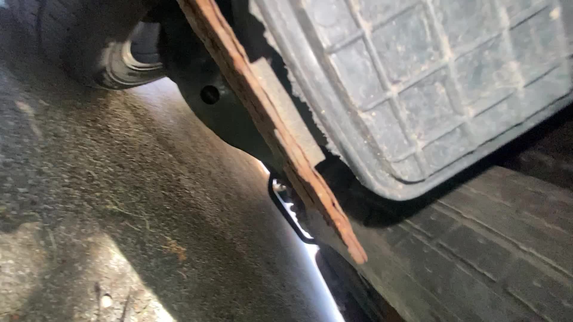

the canister look fairly new I was tapping and moving it no fluid sound of movement I'm guessing it's the purge valve.

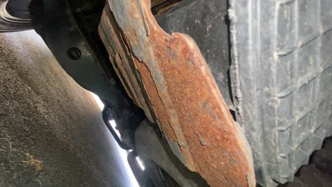

JAYSZNVR
  • 20 POSTS
this is how it looks like.
Jul 3, 2024 at 7:57 AM
AL514
  • 5,656 POSTS

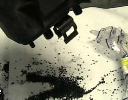

Just looking at the outside of it won't tell you anything, that doesn't look new at all, you need to be able to see if the charcoal inside has broken apart, and believe me when it comes apart, it ends up in tiny particles that get stuck throughout the Evap vapor hoses all the way up to the purge valve. You can pull the purge valve off and see if it's stuck open, but if you find it is, tap it out and see if any black dirt particles come out, that's charcoal, and if so, the new purge valve you install will just get clogged up again. I see a lot of rust there, take the Vent valve off and inspect it as well.

Just replace the hose clamp, no biggie, after checking the Purge valve for sticking, if you find it is stuck open partially, tap it on the ground and see if any black charcoal bits fall out. Do the same with the canister, the charcoal might come out like this, all broken up into tiny pieces, these then get sucked into the evap hose going to the purge valve and then the intake manifold, being pulled by the engine's intake manifold vacuum. You need to be sure if the purge valve has failed. Below is a failed canister, you shouldn't be smelling any gas outside or inside the vehicle. If it is pulling gas into the intake, it will eventually ruin the catalytic converter(s), then you'll be paying thousands to replace them, so do yourself the favor of checking the system. There's no check engine light setting yet, but it will happen soon. Check the filler neck as well, there are rubber hoses going down to the tank, look for any wet areas or areas that have collected a lot of dirt from possibly being wet with gas. If you can see on top of the gas tank as well, try to take a look on top where the hoses enter the tank, look for leaks.
