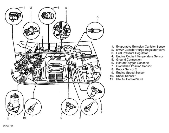

My car after service will not start. There is no spark. There was nothing wrong with it before. Anyone please help.

To start, what type of service was done? If the vehicle has lost spark, the first thing I would check would be if any trouble codes are stored in the computer.
Here is a quick video discussing the use of a scanner:
https://youtu.be/YV3TRZwer8k
If no trouble codes are found, I recommend getting a live scanner and checking the crankshaft sensor for a signal when you try to start it. Keep in mind, most scanners will read the codes. However, if you have one which can read Volkswagen/Audi (VAG) codes, chances are you will have better luck. If you find the crank sensor is not sending a signal, that is where the problem is starting. I have attached a picture of its location for you. Locate item number 7.
If you do find a code P0322 or VAG 16706, most likely the sensor is bad or disconnected.
