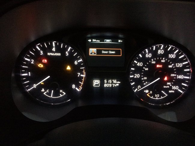

It is a push-start. The first problem is, it takes three to four seconds to start from the time I push the button. The second problem happened the other day. I had 1/4 of a tank of gas. I stopped at a red light. When it turned green, I pushed on the accelerator and that is when it happened. The e-brake light, the battery light, and a few other lights came on and my car would not move. I turned it off, then started it again and it was fine until I stopped at another red light. I had to restart my car three times to get through that light. I made it to a parking lot and called someone for help. I sat there idling for forty five minutes straight and had no problems with it shutting off. I had someone run diagnostics and there were no codes. They filled my car with gas and it has been fine since. What is happening?

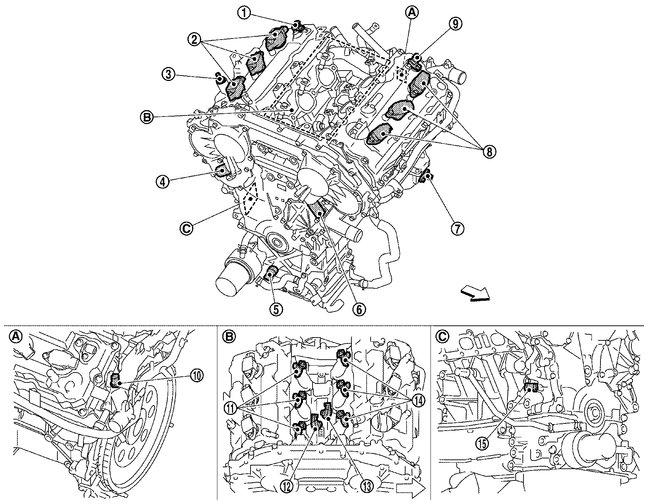

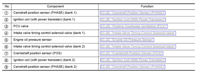

If you find the pressure us good, then I suspect the sensor is the problem. I attached two pictures for you to see. Locate number 7. That is the crankshaft position sensor. Here is a link that shows in general how one is replaced:

This is what it looked like when it stalled except:
-The warning light was on because the tire pressure was low, not because the door was open.
-There was 1/4 tank of gas, not full.

Here is what I want you to do: If the sensor is bad, there will be no spark to the plugs. So, we need to check for that before arbitrarily replacing the sensor. Follow this link. It describes how to check for spark. If there is no spark, my first suspect is the crankshaft position sensor.
