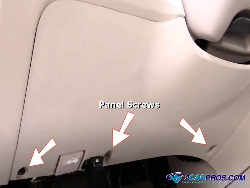

1. To access the brake light switch you will need to remove the lower dash cover which is held in place by two or three screws near the bottom, and snap clips at the top. Remove the screws and gently pop the panel loose to remove, and set it to the side.
lower dash panel screws

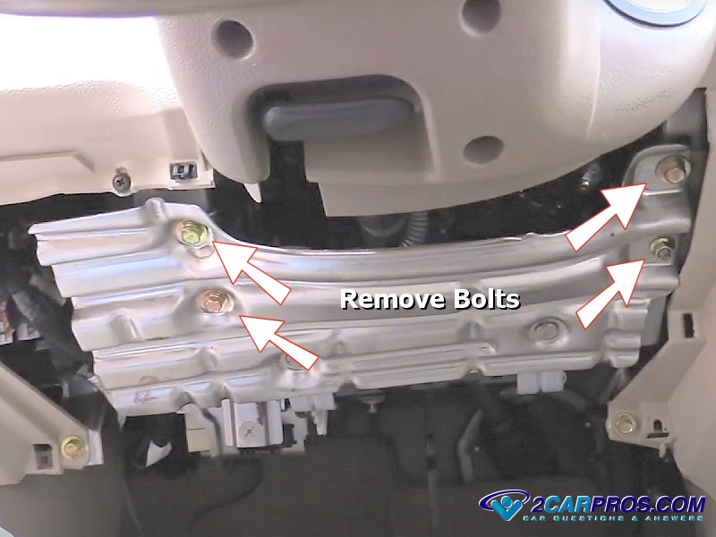

2. In this case there is a metal plate which needs to be removed as well, it is held on by 10mm and 12mm bolts. Not all cars have this plate.
remove lower guard bolts

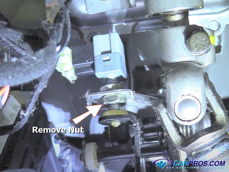

4. Depress the brake pedal to gain clearance and remove the jam nut which in this case was 19mm. The switch can now be removed from the pedal bracket.
remove brake light switch nut

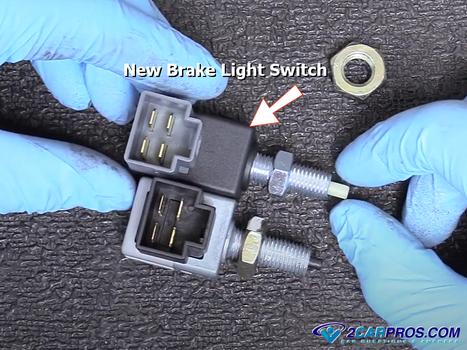

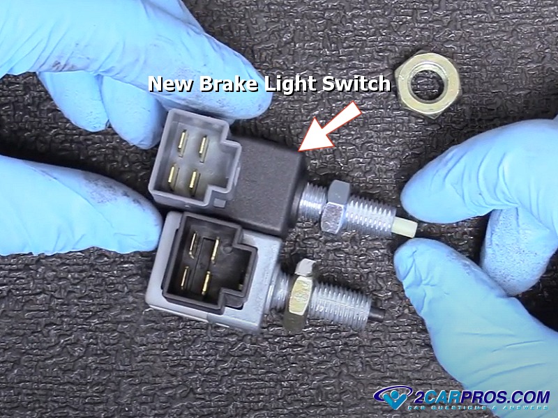

5. Match the new switch to the old unit to ensure a proper installation, also you can see the adjusting thread on the switch, this will be explained in the next step.
new brake light switch

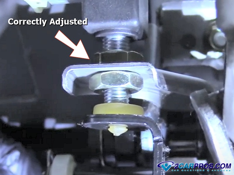

6. Here you can see the new brake light switch in position, the adjuster and jam nut, also the brake pedal stopper. The idea is to move the adjuster nut to open the switch, without holding up the brake pedal travel.
brake light switch adjustments

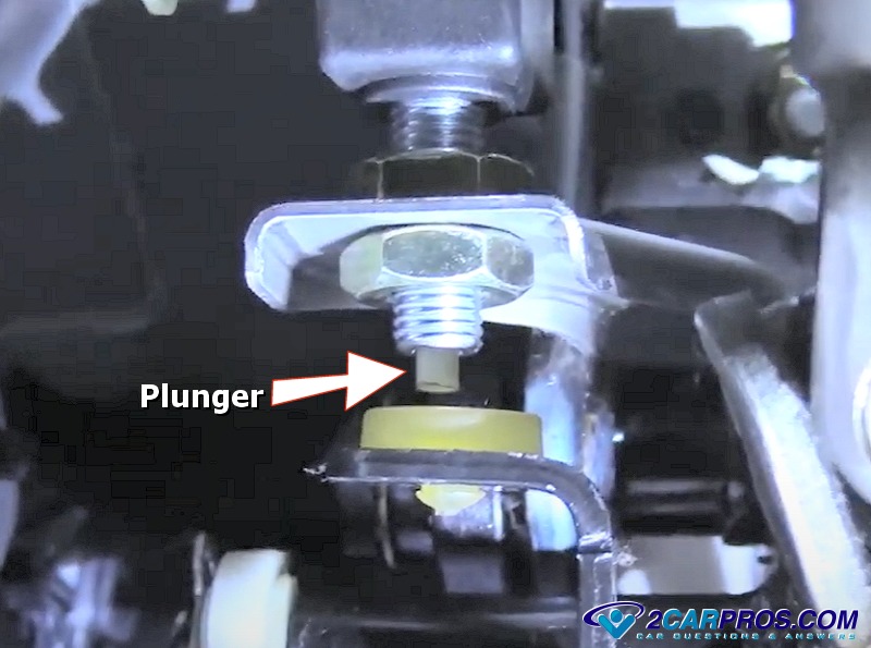

7. In the image below, you can see how the brake light switch is correctly adjusted, with the switch plunger depressed. If the plunger is allowed to protrude from the switch with the brake pedal in its neutral position the brake lights will stay on.
correctly adjusted brake light switch
8. This is what the brake light switch plunger looks like when the brake pedal is depressed. Make sure to plug the electrical connector in and you are all set. You can now reassemble the plates and panels. Be sure to check the brake light operation once you have completed the job. If your brake lights don't work please click the link to troubleshoot the system, or ask one of the 2CarPros community to help you for free.
