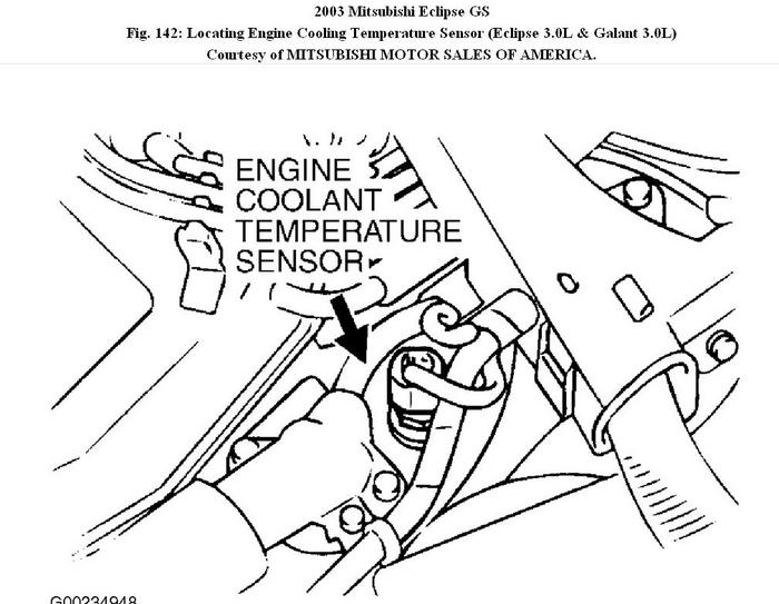

Mar 5, 2011 at 1:17 AM
KHLOW2008
  • 41,814 POSTS
Usually if it is a sensor problem, it would throw a code. The explanation of the cold and hot sensor seems to be opposite of what I know off.
It should be the other way round.
Have you checked the Engine Coolant Temperature sensor?
Mar 5, 2011 at 3:01 PM
COUNTRYRUNNER
  • 21 POSTS
you mean the thermostat? because it was replaced awhile ago but way before this problem happened. now i have never heard of a engine coolant temperature sensor, what are the symptoms of a bad one?
Mar 5, 2011 at 4:47 PM
KHLOW2008
  • 41,814 POSTS
It can be anything from hard starting to stalling coupled with difficult restarting.
The ECU monitors the ECT to enrich the running when cold and if it malfunctions, it could result in stalling due to runing too lean or rich.
Mar 5, 2011 at 8:41 PM
COUNTRYRUNNER
  • 21 POSTS
yea i looked up some symptoms of a bad ECT i have the stalling and i have not noticed a decrease in fuel since lately i have been running it hard, but no black smoke. i would try to test the ECT but the service manual only tells me how to test it not uninstall it. but thanks for the quick response though. i think your the only person left helping me out with this problem lol
Mar 5, 2011 at 11:59 PM
KHLOW2008
  • 41,814 POSTS
Engine coolant temperature sensor is located in back of cylinder head.
Remove radiator cap to release pressure in system. Close radiator cap toprevent coolant feom flowing out when sensor is removed. Disconnect ECT connector. Remove ECT buy loosening with appropriate tool, being careful not to damage connector.
To install, reverse removal procedure.
I will stick by you until we can get the problem resolved. There must be an answer somewhere and hopefully we can get to it.
