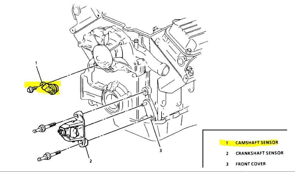

The code is related to the camshaft position sensor. The first thing I would suggest is to check the connector at the sensor and make sure it isn't loose, corroded, or damaged. I attached a picture of the sensor to help locate it.
Let me know what you find. Also, let me know if you are comfortable following a flow chart to check voltages, grounds and so on related to the issue.

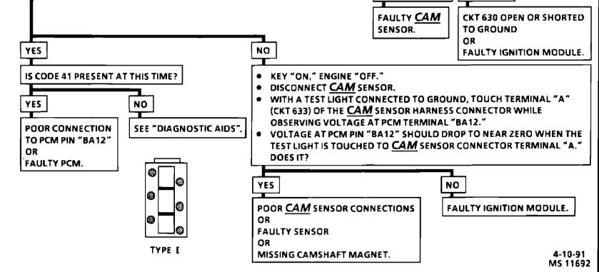

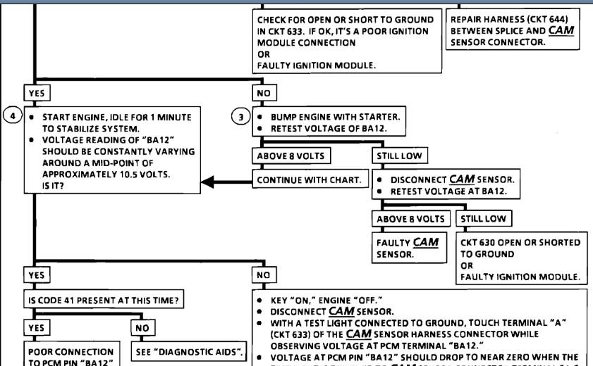

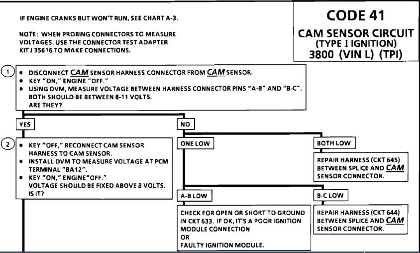

At this point it becomes a diagnostic procedure. I have attached three pics below which are the flow chart for diagnosing a code 41. I had to break the flow chart into three pictures so you could actually see them. LOL But I did overlap them so you can follow them.
Try this and let me know the results or if you need help.

I got all the way to the second picture assuming I found the BA 12 terminal right. And got to where it says CKT 630 Open or shorted to ground or faulty ignition module. Just really hoping I found the right BA terminal but I’m pretty sure I did so where should I go from this.
Nov 28, 2019 at 4:13 AM
  • 110,241 POSTS
Okay, at this point you need to determine if that supply is shorted or open. First, check to see if there is continuity to ground. If there is, it's shorted and you will need to trace the wire to find the short. If it is open, check to make sure that pin isn't damaged or not making a connection. If the connection is good, there is no short to ground, and you still get no signal, replace the ignition module.

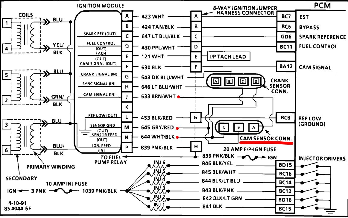

I guess I’m not 100% sure on how to test for that is there any diagram for that connector that goes to the ICM that you could send me.
Dec 8, 2019 at 11:20 PM
  • 110,241 POSTS
Basically, when you check continuity, you are checking Ohms on the multi meter. In essence, you are confirming that power from the MM can flow in one end of the wire and out the other. In addition, checking for power is just that. You need to see if power is available. Here is a link that explains how to use a volt meter/multi meter:
I attached the wiring schematic I have for the cam sensor. I placed a small red dot at the end of each wire that you are checking. Note that the schematic indicates what each wire is for, ground (low reference), power, and signal.
To check for a signal, you will need a helper to crank the engine.
Have you already replaced the cam sensor?
Let me know if this helps you.
