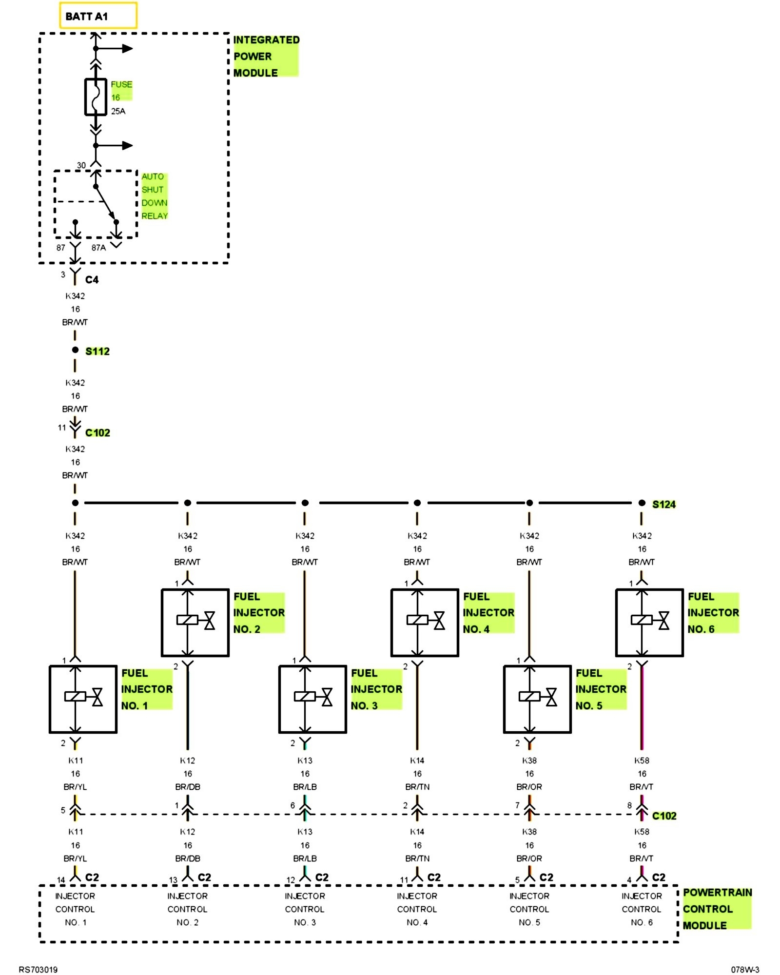

Since it is always cylinder 3, I have a feeling you have a bad injector in that cylinder. And I'm sorry, I misspoke. On this vehicle, mass air flow is calculated using the speed density method using engine speed, manifold absolute pressure, and air temperature change.
If you can, switch the number 3 cylinder injector with a different one and see if the misfire moves.

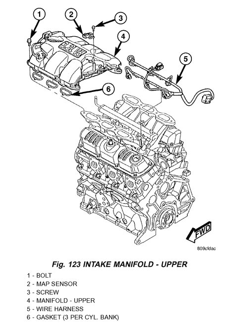

Here are the directions for the intake removal:
UPPER INTAKE MANIFOLD
REMOVAL- UPPER INTAKE MANIFOLD
1. Disconnect battery negative cable.
2. Disconnect Inlet Air Temperature (IAT) sensor electrical connector.
3. Remove air inlet resonator to throttle body hose assembly.
4. Disconnect throttle and speed control cables from throttle body.
5. Disconnect make-up air hose support clip from throttle cable bracket.
6. Disconnect the Automatic Idle Speed (AIS) motor and Throttle Position Sensor (TPS) wiring connectors from throttle body.
7. Disconnect the Manifold Absolute Pressure (MAP) sensor electrical connector.
8. Disconnect the vapor purge vacuum hose from throttle body.
Fig.120
pic 1

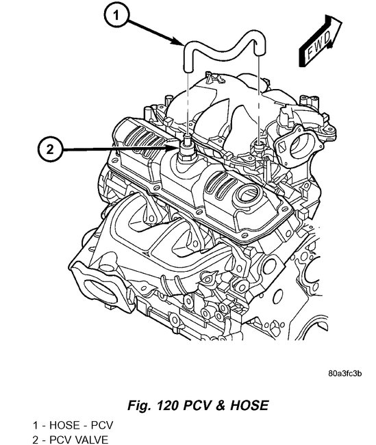

9. Disconnect the PCV hose (Fig. 120).
Fig.121
pic 2

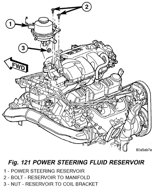

10. Remove the power steering reservoir attaching bolts and only loosen the nut (Fig. 121). Lift reservoir up to disengage lower mount from stud. Set reservoir aside. Do not disconnect hose.
Fig.122
pic 3

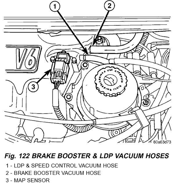

11. Disconnect the brake booster and Leak Detection Pump (LDP) hoses from intake manifold (Fig. 122).
Fig.123
pic 4
12. Remove intake manifold bolts and remove the manifold (Fig. 123).
13. Cover the lower intake manifold with a suitable cover while the upper manifold is removed.
14. Clean and inspect the upper intake manifold.

INSTALLATION - UPPER INTAKE MANIFOLD
1. If the following components were removed from manifold, install and tighten to specifications:
CAUTION: The special screws used for the composite manifold attached components must be installed slowly using hand tools only. This requirement is to prevent the melting of material that causes stripped threads. If threads become stripped, an oversize repair screw is available.
- MAP sensor - 1.7 Nm (15 in. lbs.)
- Throttle cable bracket - 5.6 Nm (50 in. lbs.)
2. Remove covering on lower intake manifold and clean surfaces.

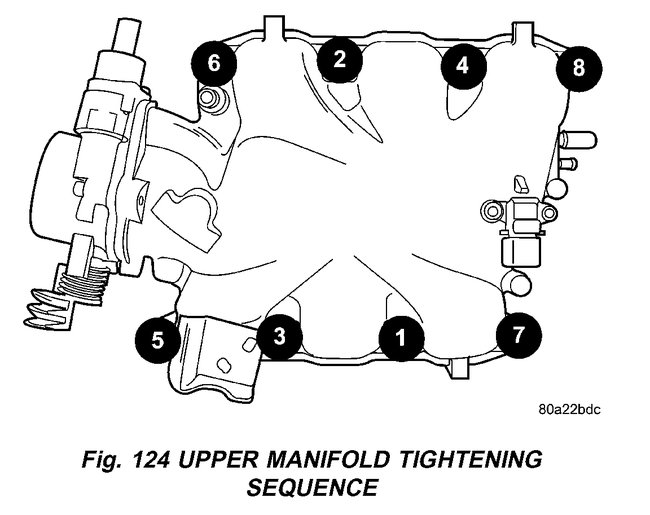

3. Inspect manifold gasket condition. Gaskets can be re-used, if not damaged. To replace, remove gasket from upper manifold (Fig. 123). Position new gasket in seal channel and press lightly in-place. Repeat procedure for each gasket position.
Fig.124
pic 5
4. Position upper manifold on lower manifold (Fig. 123). Install and tighten bolts to 12 Nm (105 in. lbs.) following torque sequence in (Fig. 124).

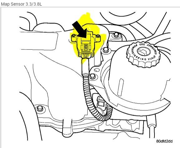

The last thing left is to do a compression check, but before I have you tear everything apart again, would you consider replacing the map sensor? Also, since you have a live data scanner, can you tell me what it is reading.
The thing that has me the most confused is that you are only getting the misfire on cyl 3. A MAP sensor on this vehicle basically has taken the place of a MAF sensor. The computer uses pressures to determine fuel injector pulse widths (which can cause the STFT and LTFT to act crazy), spark advance and so on. Because of that, I would suspect it wouldn't be limited to only one cylinder, but who knows.
It is mounted on the intake manifold. I attached a pic and highlighted the sensor for you. You may want to remove and inspect it and confirm all connections are clean and tight.
If you don't suspect that could be the issue, then we need to check compression.
Let me know your thoughts. If you plan to check compression, let me know that too.
