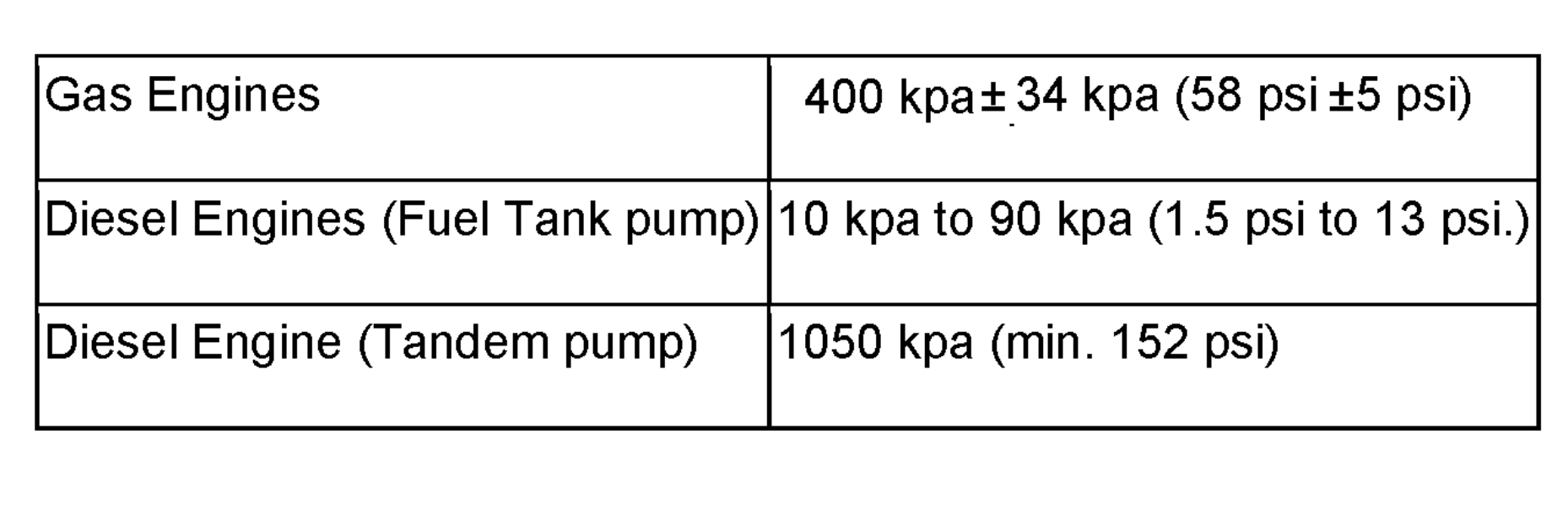

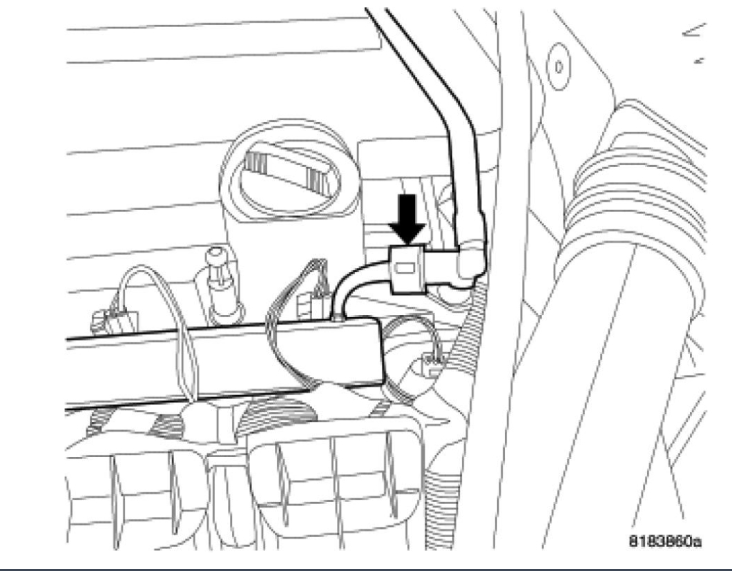

Fuel pressure has not been checked. Can you provide a guide for checking the fuel pressure I'm not sure where to hook the gauges. And do you know where the fuel pressure regulator is located? Thanks, JC
Aug 11, 2021 at 9:39 PM

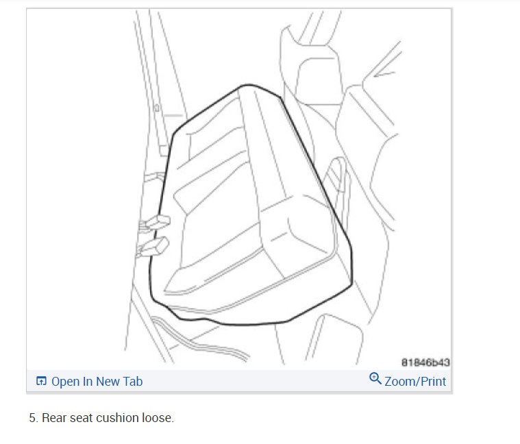

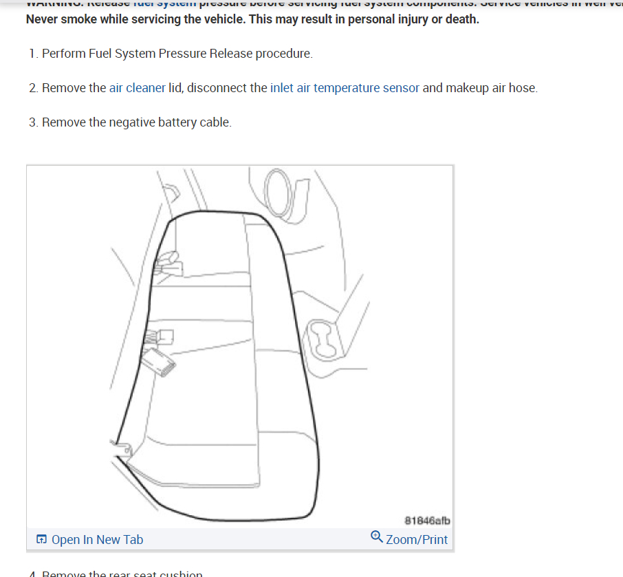

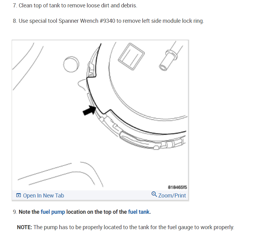

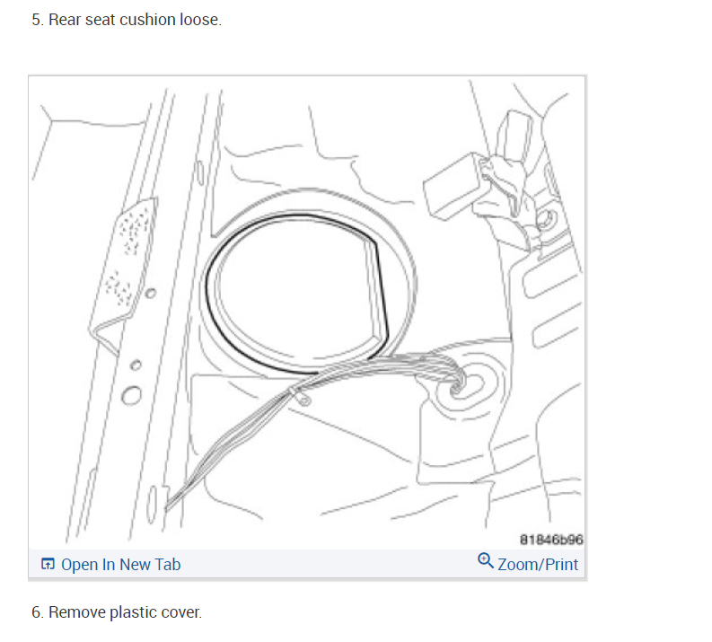

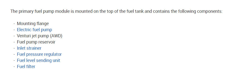

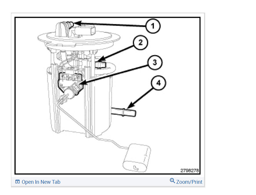

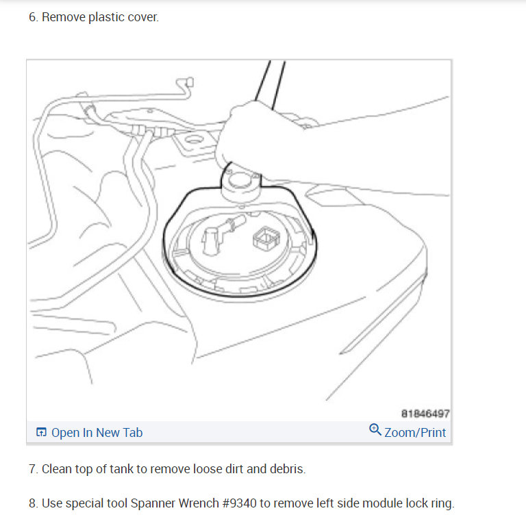

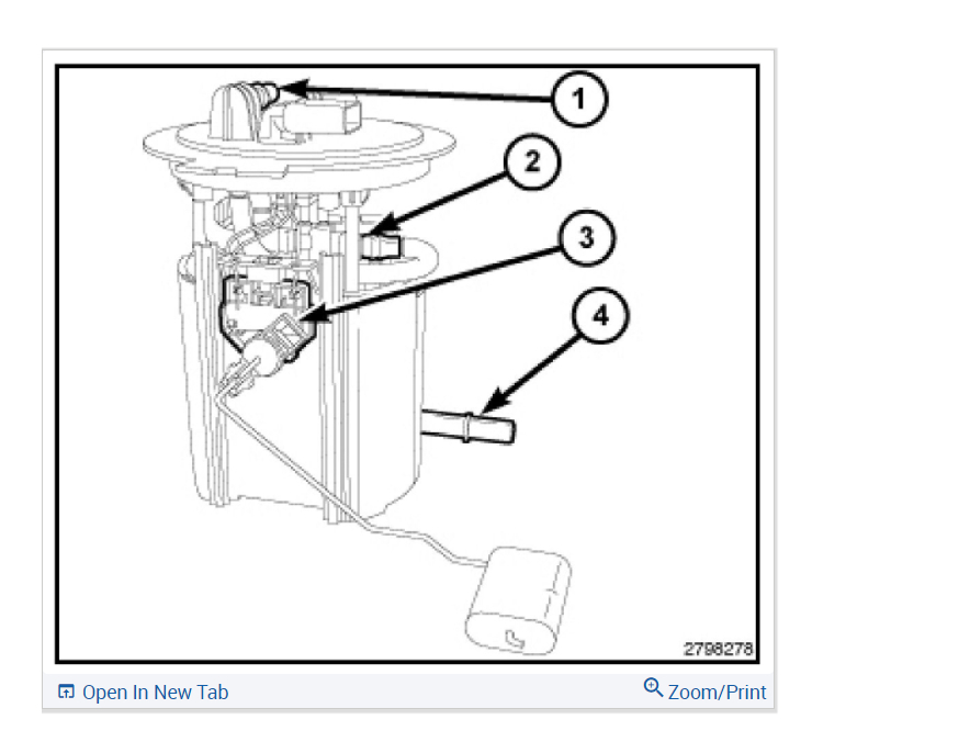

You will need to T into the line at the fuel rail. I attached a picture for you to view. You can rent a tester kit at a parts store for this procedure.
The regulator is part of the fuel pump assembly. It must be replaced with a pump.
https://www.2carpros.com/articles/how-to-replace-an-electric-fuel-pump

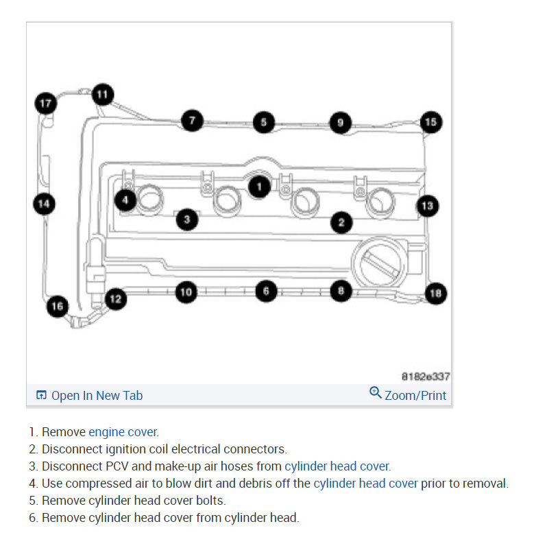

Okay, I would remove the valve cover and inspect it under the cover. If it is backfiring, you have had a rocker arm issue. The fact that it backfires indicates that.
https://www.2carpros.com/articles/replace-valve-cover-gasket
Aug 11, 2021 at 10:13 PM

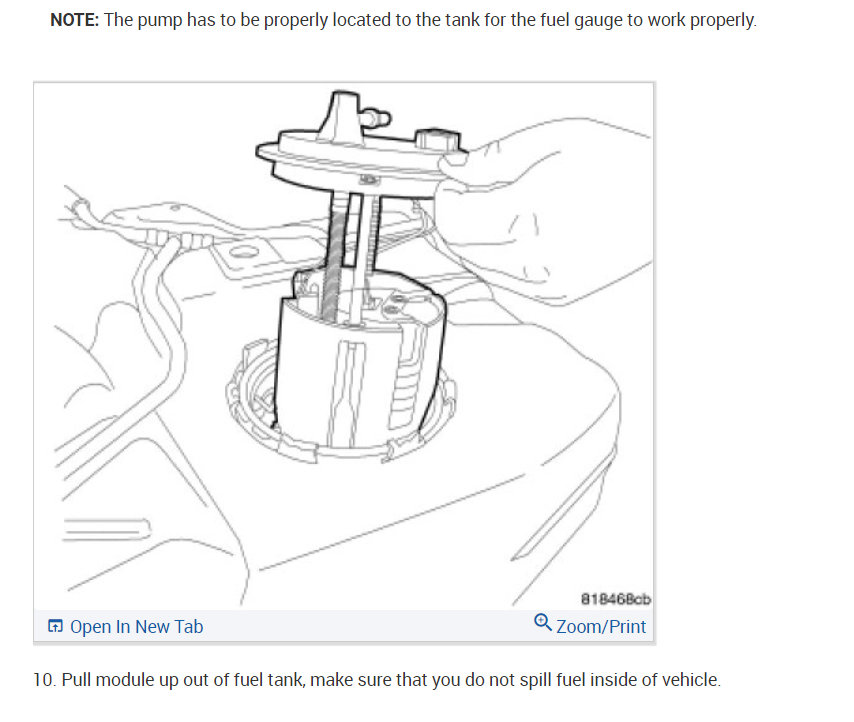

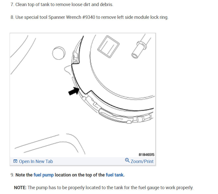

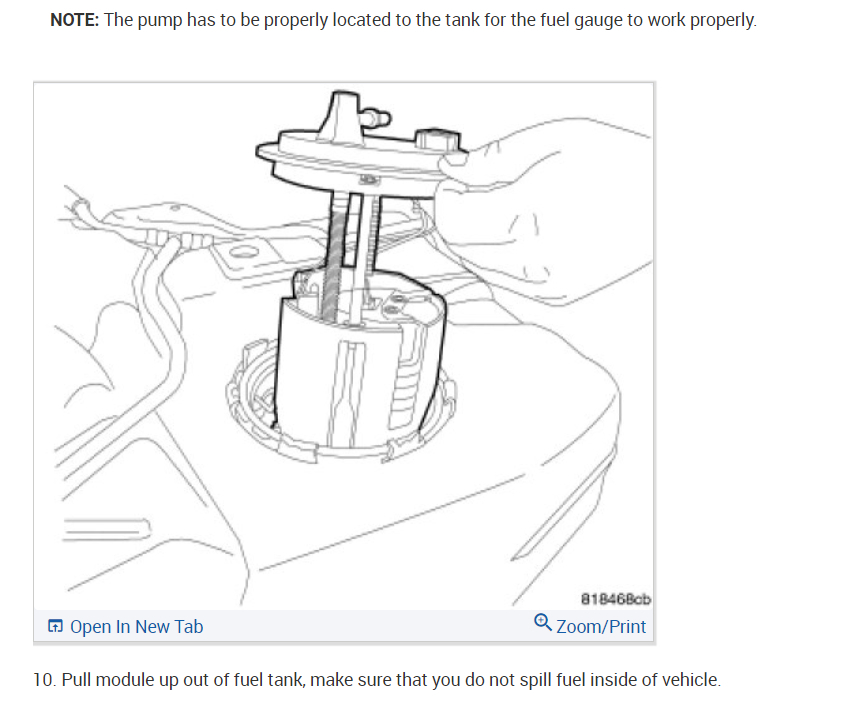

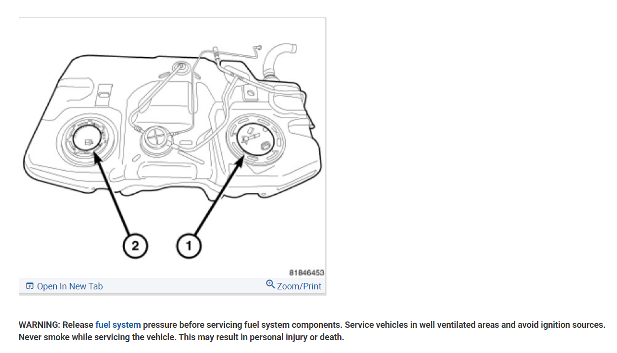

The fuel pump contains the fuel pressure regulator. The part is not available by itself. You replace the entire fuel pump.
Aug 11, 2021 at 10:14 PM
JC-842
  • 181 POSTS
Oh no, you mean inside the gas tank. No way I'm not going there. I'm not a certified mechanic. I'm 70 years old I can't deal with that job. I'll have to let the dealership scan it I guess. This is a guessing game at this point and is getting more expensive by the day.

What exactly am I looking for inside the valve cover?

You are looking for anything broken. The backfiring indicates something in the valve train.
It usually shows up with a compression test.

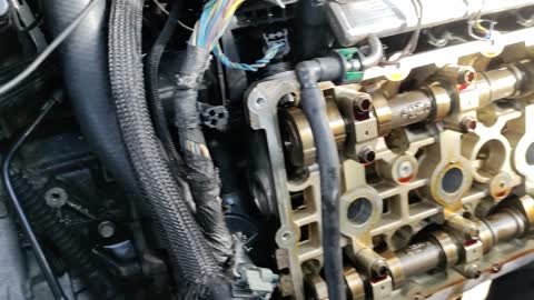

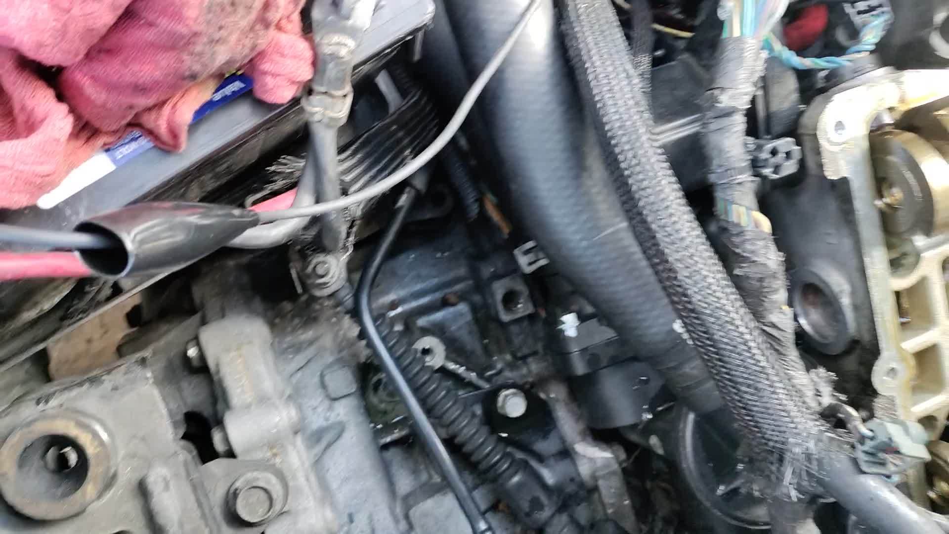

I see nothing unusual Roy... Help
Aug 12, 2021 at 12:25 AM
JC-842
  • 181 POSTS
All the valve springs are working and the lifter's are all working.
Aug 12, 2021 at 5:01 AM
When you get it together, remove 1 plug. Start the engine with the compression gauge in the cylinder and tell me the running compression.
Aug 12, 2021 at 7:15 AM

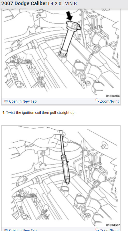

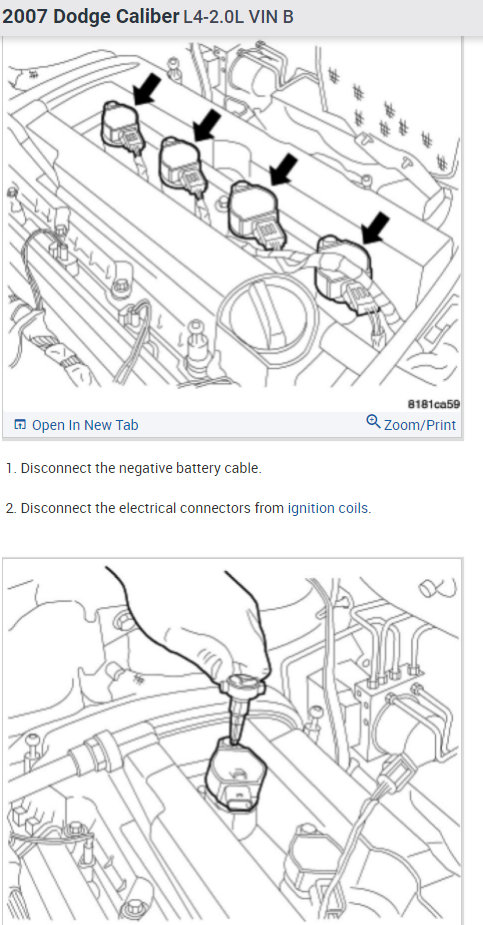

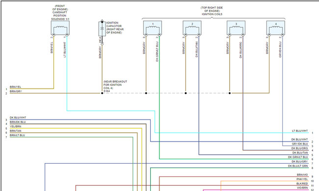

Okay, that won't be today but I think I found the problem. I'm sure it's the PCM the middle pin on the coil connector should be the ground right?
So connecting a test light to positive battery terminal and test light to middle pin of connector and spinning over the engine my test light should blink on off. But it doesn't. I tried it on every one of my coil connectors not just number four and it doesn't blink on any of them. I'm trying to figure out how to test the wire itself from the coil to the PCM pins but I'm not sure how that's done exactly. I have to put the cover back on before I can start it up.
I guess.

My wiring diagram shows 2 wires on the coils.
Aug 12, 2021 at 7:54 AM
Can you verify the 2 coils and the 3 wires?
Aug 12, 2021 at 8:07 AM

That's correct the brown being the hot and the blue striped wire which is the middle pin on the coil connector when a test light is applied with power from positive side of battery with engine turning over is supposed to cause the test light to blink. But it shows no power at all. Was the running compression test okay?
Put the test light on the negative side and probe the blue stripped wire.
Aug 12, 2021 at 8:10 AM

Okay Roy, with engine running testing to blue wire and positive battery terminal light comes on steady and does not blink. That's on all cylinders. Then hooked light to ground side of battery and no light at all.
Aug 12, 2021 at 9:02 AM
JC-842
  • 181 POSTS
Just found something odd. Number one coil does not light up at all so the brown wire will light up but not the blue green wire.
Aug 12, 2021 at 9:09 AM
Then the coil is bad. It is not passing current.
Aug 12, 2021 at 9:20 AM
JC-842
  • 181 POSTS
I tested unhooked in and hooked to the coil if the plug is not connected to the coil it shouldn't matter should it. No current is getting to the coil it s the way I'm looking at it. If I'm wrong I'll try another coil but why are none of the other connection blinking like they should be?
Aug 12, 2021 at 9:34 AM
It must be hooked up to the coil for this test. Is the brown wire hot with battery voltage?
Aug 12, 2021 at 9:36 AM
JC-842
  • 181 POSTS
Yes it was . But I pulled the plug from the cylinder left it plugged to the coil and the plug was firing. I changed the coil to a coil I know to be good and installed the plug it's firing and the brown wire is hot but nothing on the blue wire.
Aug 12, 2021 at 9:48 AM
That is because it is grounded by the ECM.
Aug 12, 2021 at 9:57 AM
