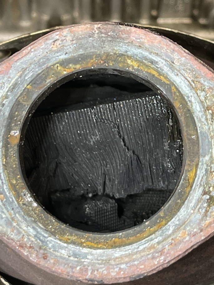

Well, this is the problem: Converter is clogged up. So, if i just clean out the honeycomb inside, can I reattach it and will it run? Will it hurt the engine?

That will do it. By law, you aren't to remove the insides. Will it run okay? Well, it certainly will run much better. The issue is the O2 sensors will not get accurate readings and cause the check engine light to turn on, and I don't know where you are located, but it will likely fail an emissions inspection.

1. How does the honeycomb break up inside the converter? Bumps in the road? If so, they are fragile.
2. If the honeycomb pieces fall out, how is that illegal? No way I can "put them back". Also, I have a secondary converter in the tail pipe. It seems to be okay.

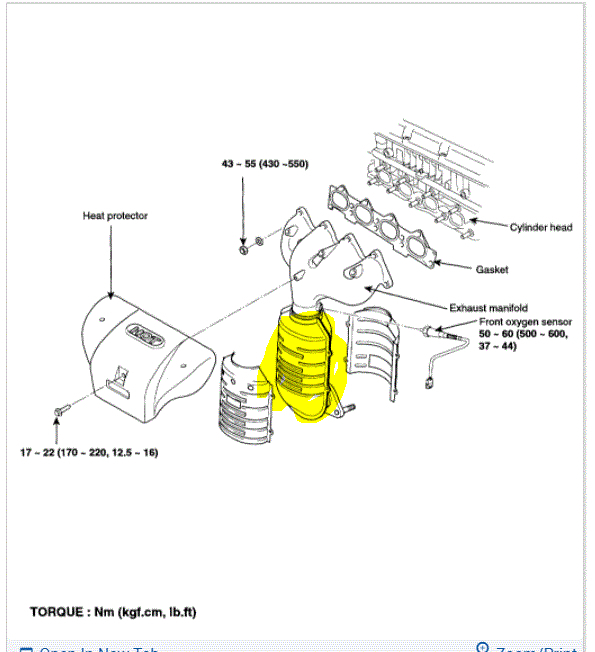

Like anything else, the converter simply wears out. Considering internally, they run at about 1500 degrees F, constant pressure from the exhaust, bumps, hitting things, and so on, they come apart.

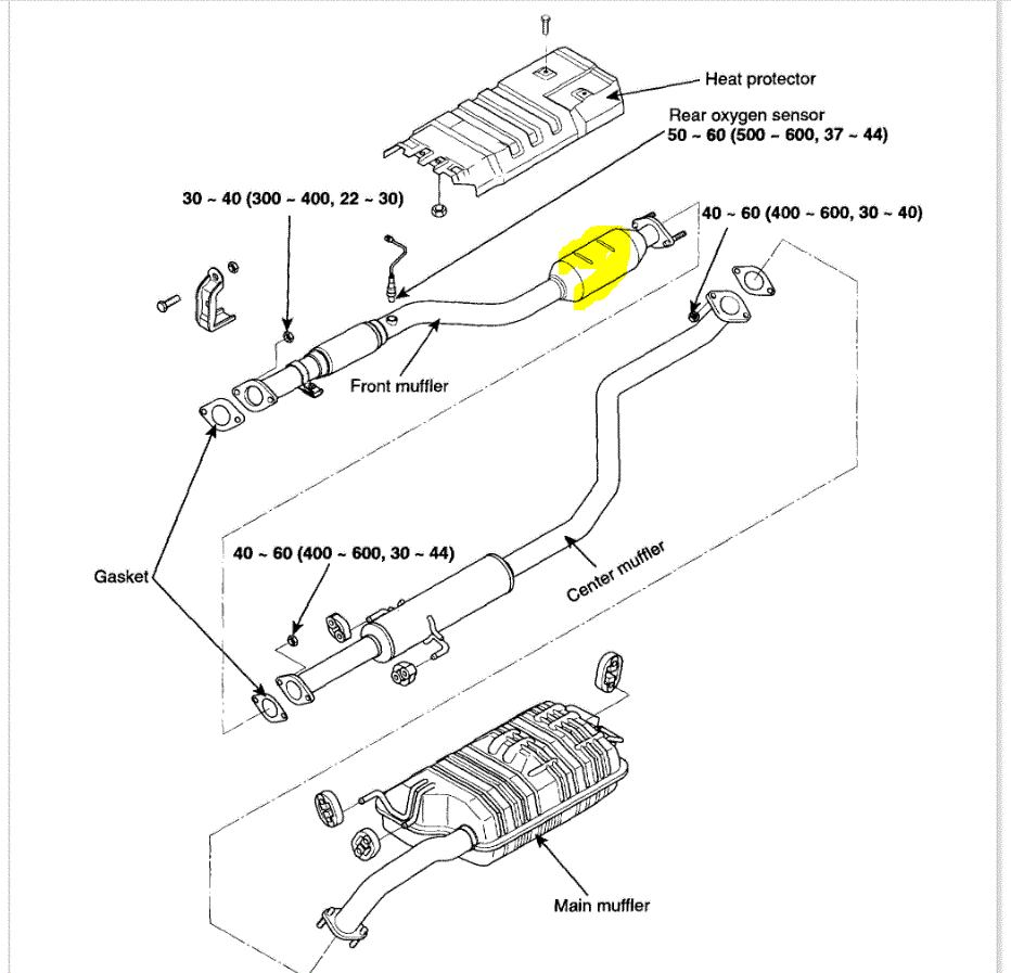

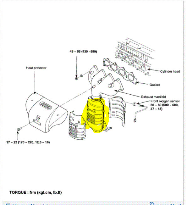

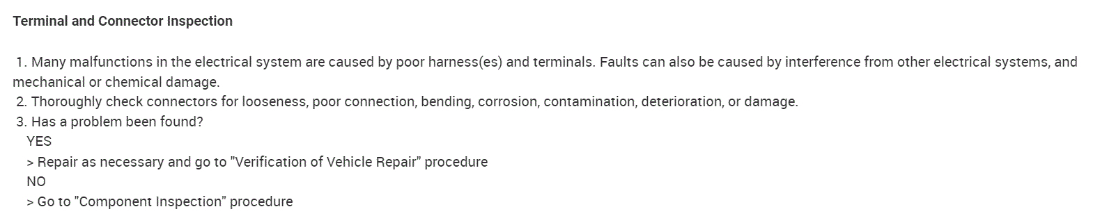

The vehicle has two converters. One is integral with the exhaust manifold (pic 1) and the other is under the vehicle (pic 2). If nothing got into the second one, it should be okay.
As far as it being legal, the federal government has implemented laws to lower exhaust emissions. The vehicle is designed to meet a specific standard. Removal is not permitted by law. However, you asked if it comes apart without you knowing. The only way to know it is by checking the engine light, changes in performance, and so on.

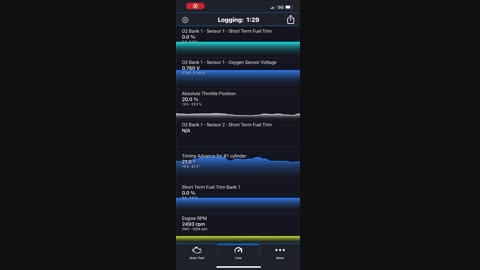

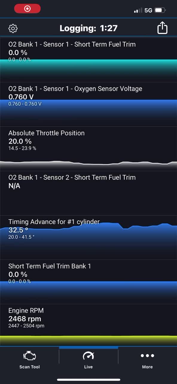

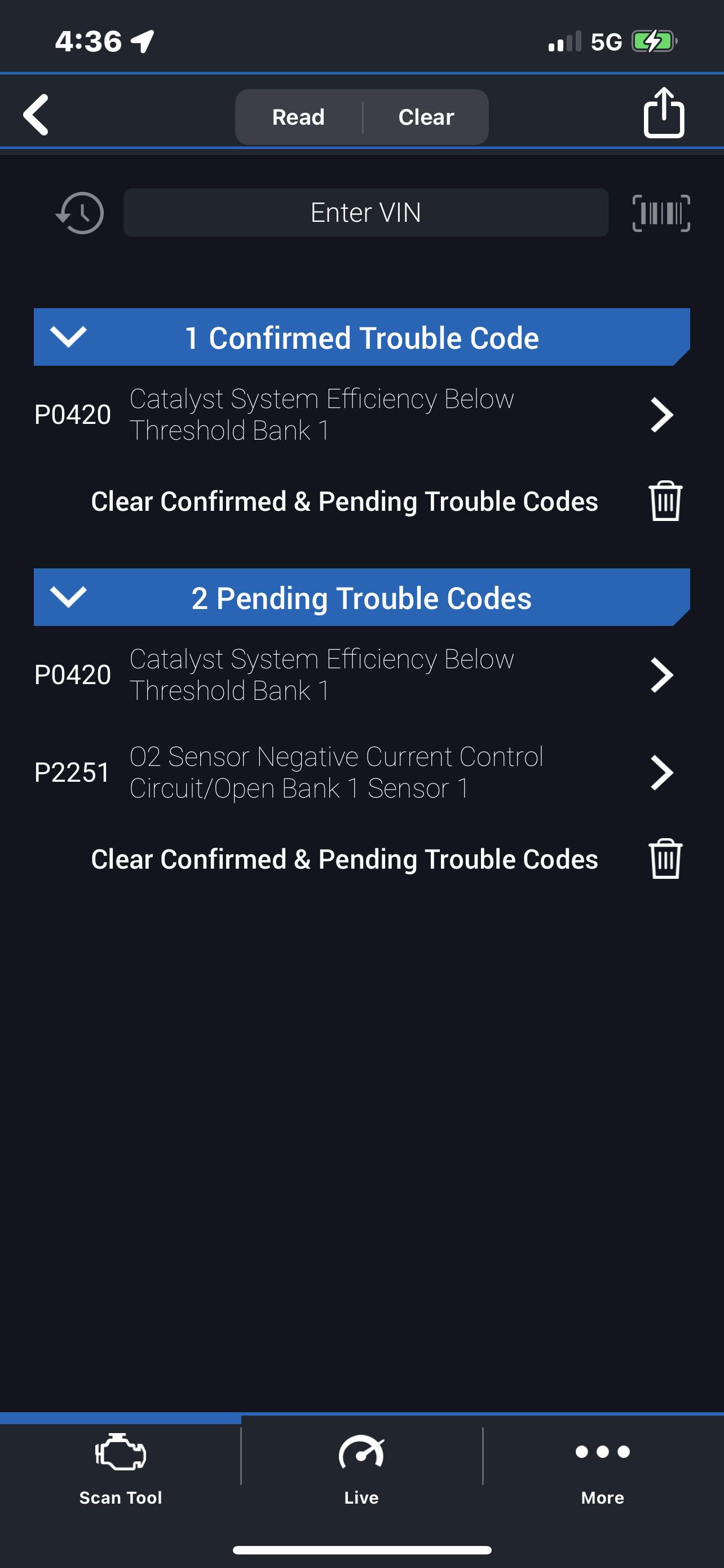

Here is today's morning scan driving. 15 minutes into drive. Flat surfaces seems okay, but when going uphill it either down shifts high RPMs and slows up, seems to be a significant power loss.
Feb 17, 2022 at 6:25 PM
  • 110,248 POSTS

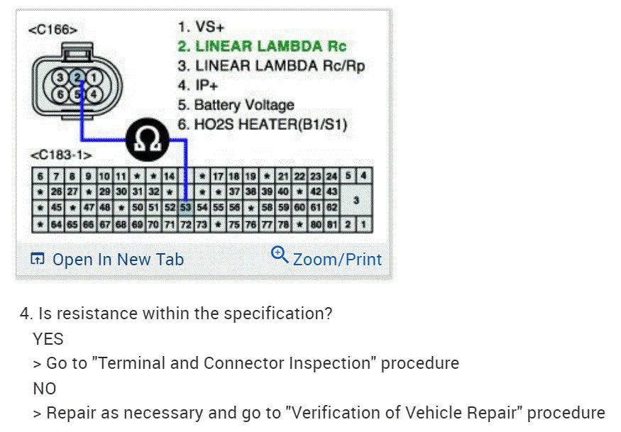

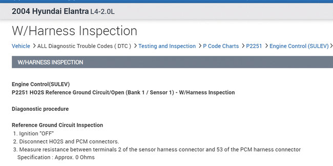

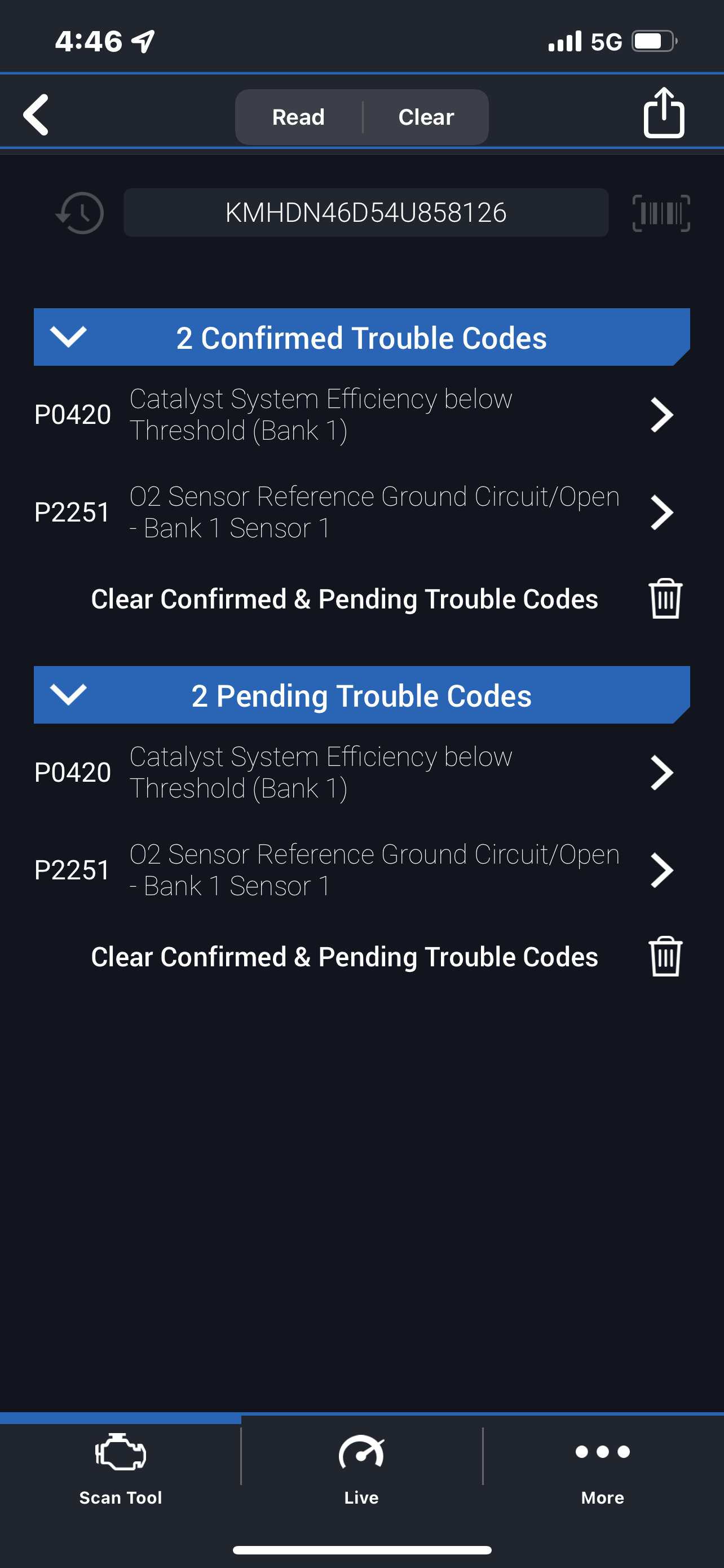

The Po420 is an indicator of the issue with the catalytic converter. Interestingly, there are no short-term fuel trims showing up. That is likely related to the oxygen sensor (B1 S1). The code indicates there is no ground signal to the sensor.
If you look below, I provided the directions related to testing the circuit. This could be throwing things out of wack simply because the fuel mixture is off.

The documents provided show a different PCM than mine. I am looking under the driver's side dash (left side of pedals) and it is a different terminal inside.

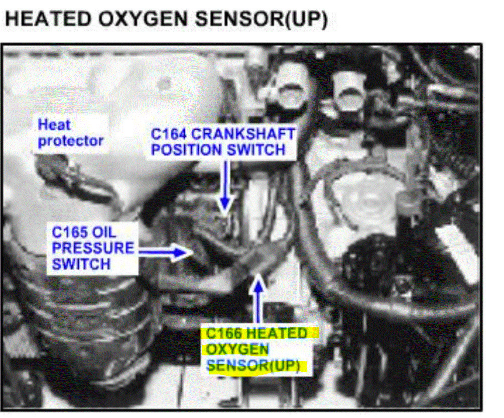

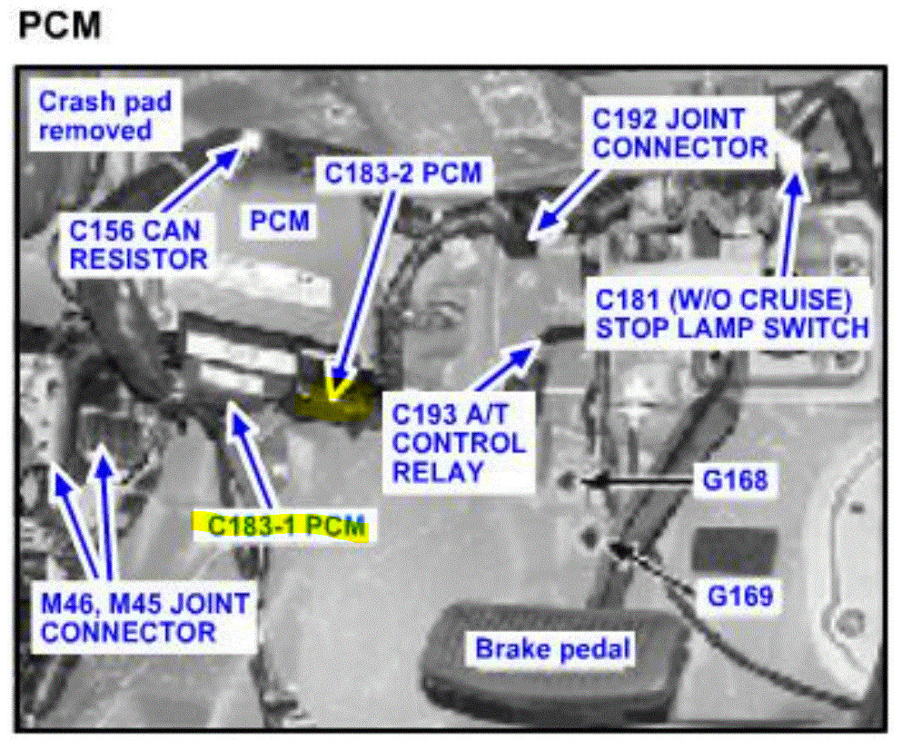

I never heard of anyone doing that. Anyway, the pic above shows two connectors. One is in the vehicle (C183) at the PCM (see pic 1) and at the O2 sensor (C166). Take a look at the pics below and let me know if that is where you were looking.
Feb 19, 2022 at 11:30 AM

Ahh, I was looking at 183-2 not 183-1. And your other pic is a little digitized, but I think it’s the front 02 sensor connection.
So i’m curious if there’s a short or if the ohms are too high, does that mean my harness/internal wiring is bad? If so that sounds super hard to fix….

You are correct. Pic 2 shows the O2 sensor at the front of the engine. As far as resistance issues, most times it is related to a corroded connector or simply a weak connection. If you find the resistance is high, what I do first is simply clean the connectors, inspect them to make sure nothing was damaged or pushed in, and then I put dielectric grease in the connector first. Usually, that takes care of the issue.

I will try to do that this afternoon if I can by the way this is an image of codes that are popping up when the engine is cold in the morning but not so after the engine is hot.

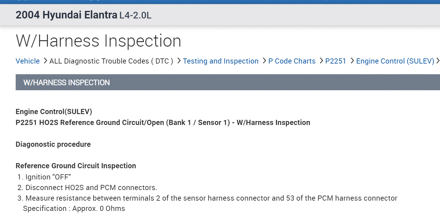

I did the check and it came back 0 ohms.

You have an open circuit in that wire. It's likely broken at some point. If you checked it with both ends disconnected (Sensor and PCM) and got 0, it's open.
Are you able to trace that wire to inspect it? Are you getting a signal ground at the PCM itself?

If you are checking at the PCM, you should receive a ground signal when the key is on at the PCM pin which is open. A signal ground is used as the reference point for internal electronics. In this case, the PCM.

I am now questioning if I even tested it properly according to the documents you sent me. Here is what I did: I attached ground millimeter end to #2 (per your diagram) of front 02 sensor, then touched red end of millimeter to #53 pin in the PCM. The ignition was off, and I didn't get any signal whatsoever. (I think you are now asking to test the 'open ground' the ignition needs to be on?) In fact, while I was trying to touch the #53 pin, I touched many others yet no signal on meter. Did I do the first step correctly? Keep in mind, I thought I read your directions to have ignition to be off on first test.
Now I am not 100% sure the correct steps testing the "open ground" signal. Do you have step by step directions?

It sounds like you did it correctly. There won't be power in the wire. Instead, you are checking for continuity. In other words, the wire is intact, and power can go from one end to the other.
When you do the test, no power from the vehicle is needed. The meter (when set to ohms) will provide a small amount of power to see if the circuit is complete and how much resistance there is.
Also, and I apologize if I confused you, when I use the word open with regards to the electrical system, basically, I'm saying the wire is broken or there is no ability for power to transfer through the wire.
