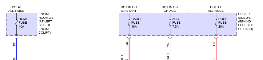

So I have been having an issue with the front passenger door lock. I replaced the actuator with a new actuator but the car now only "unlocks" on the electronic switch but does not "lock" when pressing lock on either the passenger or driver's side door lock switch.
I tried plugging in the older actuator but the problem remains. If I unplug the old or new actuator entirely, the doors will lock again using the lock switch but obviously this does not solve the problem because the passenger door actuator is not plugged in, during this scenario.
Any ideas?

check switch to see if power is going through it first. may not be. check all fuses in picture then have a mechanic scan for codes as the pass door ECU may be the problem.
