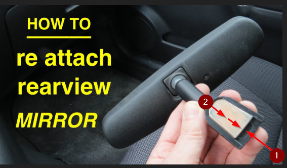

The rear view mirror in my Mercury Sable (1995 3.8 L V6 162,000 miles) has fallen off the windshield, now i need to remove the "button" from the bracket in order to reattach it to the windshield the problem is I cannot find a way to remove the button from the mirror it is a Donnelly model 2410 I know most normal mirrors have a small screw that holds the button in place this one doesn't, please help
Mar 24, 2007 at 10:47 AM
Sure. The button on this module is held in by a clip.
Basically, you are going to slide a pocket screwdriver under the button where it is shown in the picture below marked by number 1.
Then you are going to push/slide the button down out of the clip.

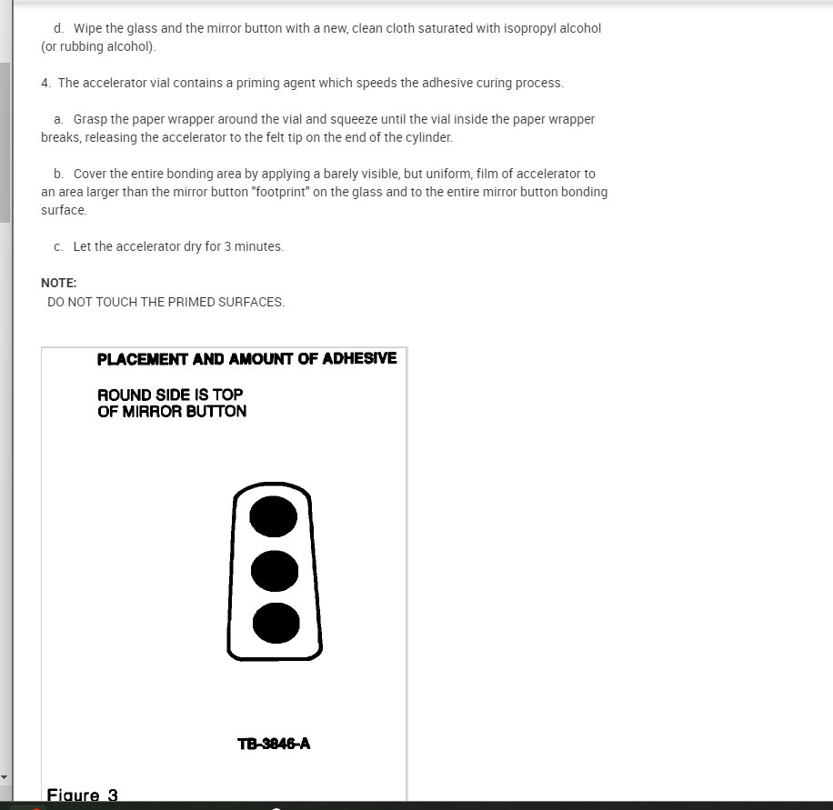

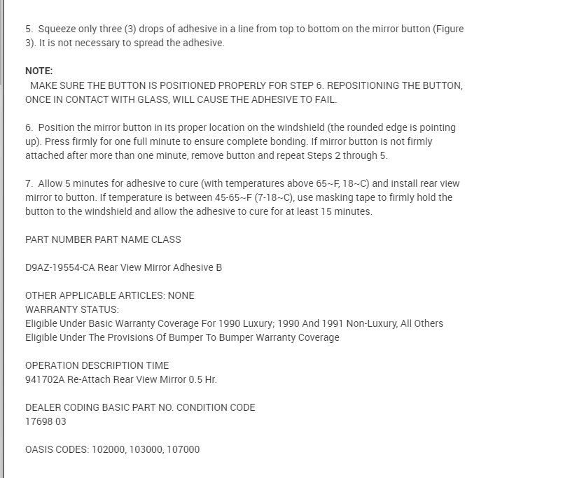

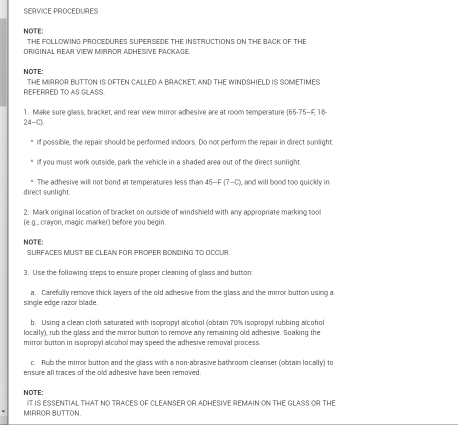

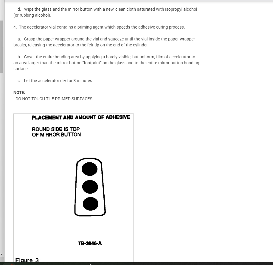

I then attached the process from Ford on how to reattach the mirror so that it doesn't fall off again.
Please run through this and let us know what questions you have.
