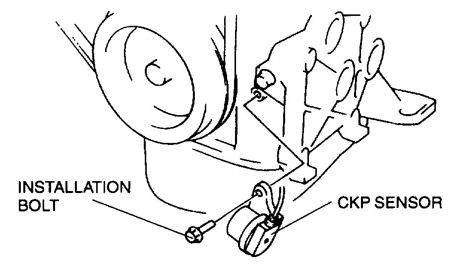

If you find the sensor is bad, here are the directions for replacement specific to your vehicle including adjustment. The attached pics correlate with the directions.
CRANKSHAFT POSITION (CKP) SENSOR REMOVAL/INSTALLATION
CAUTION: When foreign material such as an iron chip is on the CKP sensor, it can cause abnormal output from the sensor because of flux turbulence and adversely affect the engine control. Be sure there is no foreign material on the CKP sensor when replacing.
1. Disconnect the CKP sensor connector.
2. Remove the undercover.
3. Remove the CKP sensor installation bolt.
See Pic 1
4. Install in the reverse order of removal.
Tightening torque
7.9 - 10.7 Nm (80 - 110 kg.cm, 69.5 - 95.4 in.lb)
5. Reconnect the CKP sensor connector.
CAUTION: Do not forcefully pull the wiring harness of the CKP sensor. Doing so will break the harness.
6. Adjust the air gap. (Refer to CRANKSHAFT POSITION (CKP) SENSOR ADJUSTMENT.)
See: Crankshaft Position Sensor > Adjustments
Adjustment.

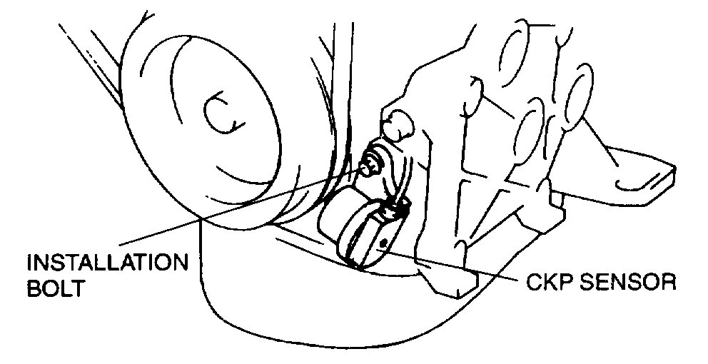

See Pic 2
1. Loosen the CKP sensor installation bolt.
2. While moving the CKP sensor, adjust the air gap between the CKP sensor and the plate teeth on the plate using a feeler gauge.
- If not adjusted within specification, replace the plate behind the crankshaft pulley or CKP sensor.
Specification: 0.5 - 1.5 mm (0.020 - 0.059 in)
3. Tighten the CKP sensor installation bolt.
Tightening torque

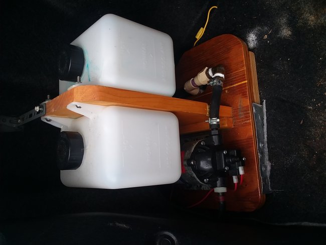

I don't know if the guy raced it or not. i know the tank for the alcohol is still mounted in the trunk and for the life of me i can't understand why alcohol was ran through it. lol sounded like a crazy thing to me.
Jun 24, 2019 at 11:26 AM
  • 110,248 POSTS
Can you take a picture of the tank so I can see what he did? I have to be honest, this is the first time I heard of this one. LOL

Let me know if this tells you anything.
Thanks
Jun 25, 2019 at 5:07 AM
  • 110,248 POSTS
Stephanie:
I have no idea what the heck that is. LOL What makes you think it's for alcohol? Honestly, they look like either windshield washer bottles or coolant overflow bottles. Do the hoses run to the engine compartment?

I think it is alcohol because that is what i was told by previous owner, i honestly don't know anything about how all that works. I don't see any hoses , just that little motor attached to it. I thought the same thing it looked like coolant or windshield washer containers. I really want to just rip it out of the trunk. I bought the car dirt cheap , thinking i would only have to fix a few things . And yes the car is still running good with the new plugs , guess i got lucky that it was not anything major. I am just going to baby it until tax time and buy a new car and use the ole Mazda for a back up car. Have a great day.

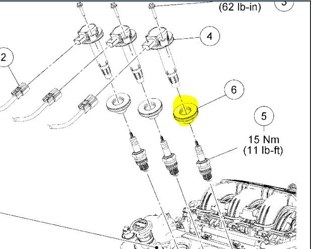

I replaced spark plugs again today, and now car wont start at all. Yes, check engine light is on it stays on always has. I do know the spark is orange not blue. I was told the coil pack is missing something on bottom that goes down over top of plug that connects it , said it was pulled off when removing plug wire. And for the life of me i can't remember what he called it. Said it was causing it not to get the spark it needs and that is why it is orange instead of blue. I think he said a N cap. Said both coil packs would have to be replaced. Yes, i have checked fuel pressure it is getting plenty of fuel. This car is a nightmare. I hope this gives you somewhat of an idea. This car has me seriously stressed out
Jul 15, 2019 at 12:58 PM
  • 110,248 POSTS
Welcome back:
There is a seal on the bottom of the coil where it connects to the plug. Take a look at picture 1 and let me know if the part I highlighted is what you are referring to.
Also, by any chance do you have access to a live data scanner? And do you know the codes stored in the computer causing the check engine light to be on?

Yes, that is the piece i am referring to. And no unfortunately i don't have access to a scanner. If i can get it started, could i take it to like AutoZone and have them scan it?
