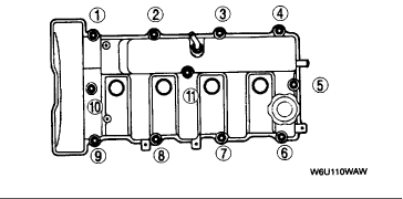

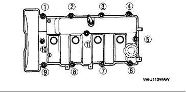

Cylinder Head Cover Removal Note
Remove the cylinder head cover bolts a few turns in the order shown.

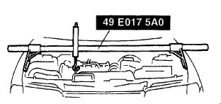

No. 3 Engine Mount Rubber Removal Note
Suspend the engine using the SST.

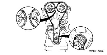

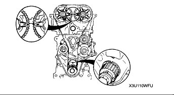

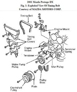

Timing Belt Removal Note
Install the pulley lock bolt.
Turn the crankshaft clockwise and align the timing marks.

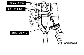

Turn the tensioner clockwise using an Allen wrench.
Disconnect the tensioner spring from the hook pin.

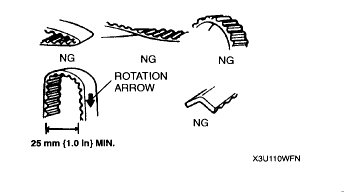

Caution:
Forcefully twisting the timing belt turning it inside out, or allowing oil or grease an it will damage the belt and shorten its life.
Note:
Mark the timing belt rotation on the belt for proper reinstallation.

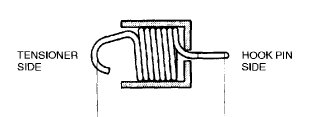

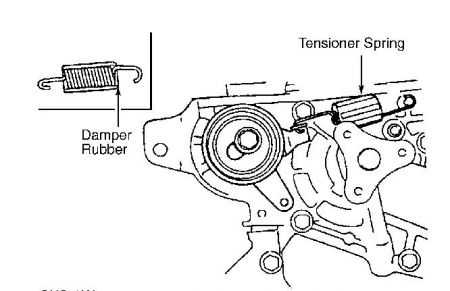

Tensioner, Tensioner Spring Installation Note
Measure the tensioner spring free length.
If not within the specification, replace the tensioner spring.
Free length 36.6 mm (1.44 inch)
Install the tensioner.
Rotate the tensioner.
If tensioner rotates with no resistance or does not rotate, replace the tensioner

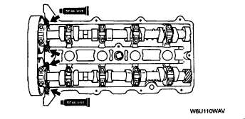

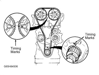

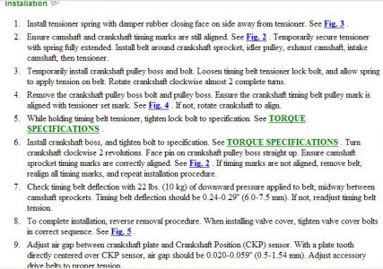

Timing Belt Installation Note
Verify that the timing belt pulley mark and camshaft pulley marks are aligned with the timing marks as shown.
Install the timing belt so that there is no looseness at the idler side.
Turn the crankshaft clockwise twice, and align the timing marks.
Verify that all timing marks are correctly aligned.
If not aligned, remove the timing belt and repeat from Step 1.
Caution:
Be sure not to apply tension other than that of the tensioner spring.
Connect the tensioner to the hook pin.
Turn the crankshaft clockwise twice, and verify that all timing marks are aligned.
If not aligned, repeat from Step 1.

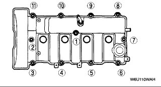

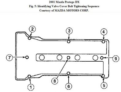

Cylinder Head Cover Installation Note
Verify that the grooves on the cylinder head c over are free of oil, water and other foreign material.
Install the cylinder head cover gasket into the cylinder head cover.
Apply silicone sealant to the cylinder head as shown.
Tighten the cylinder head cover bolts a few turns in the order shown

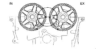

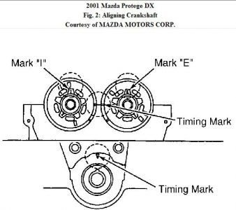

Timing belt 2001 Mazda protege 2 liter what are the timing marks
Aug 3, 2020 at 6:55 AM (Merged)
DOCFIXIT
  • 18,828 POSTS
Here is a guide to help you see where the camshaft timing marks are
https://www.2carpros.com/diagrams/mazda/protege/200
Cheers

If i want change my timing belt wish of the two marks i put in the midle the letters or the small points all this of course with the piston number 1 on the hight poin dead

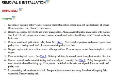

I'm going to change my tIming belt on my car but I need to know the procedure to change it as well as the timing marking to leave it on time. Can you pls help me and show me some diagrams?
TIMING BELT REMOVAL/INSTALLATION [ZM]
Disconnect the negative battery cable.
Remove the CMP sensor.
Remove the ignition coils.
Remove the drive belt.
Remove in the order indicated in the table.
Install in the reverse order of removal.
Inspect the air gap. Refer to Powertrain Management; Computers and Control Systems; Crankshaft Position Sensor.
Adjust the drive belt deflection/tension.
Start the engine and:
Inspect the pulleys and drive belt for runout and contact.
Inspect the ignition timing.
No.3 Engine Mount Removal Note

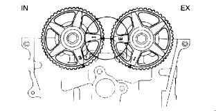

Install the pulley boss and pulley lock bolt.
Note:
Face the marks (I) and (E) of the camshaft pulley straight up, then align the timing marks with the horizontal surface on the cylinder head.
The pulley boss position pin on the crankshaft should be facing straight up.
Loosen the tensioner lock bolt.
Push the tensioner in the direction of the arrow and hand-tighten the lock bolt.
Caution: Forcefully twisting is the timing belt turning it inside out, or allowing oil or grease on it will damage the belt and shorten its life.
Note: Mark the timing belt rotation on the belt for proper reinstallation.
If not as specified, replace the tensioner spring. Free length 61.8 mm (2.43 inch)
Install the tensioner spring with the damper rubber closing face on the right side.
Temporarily secure the tensioner with the spring fully extended.
Note: Face the marks (I) and (E) of the camshaft pulley straight up, then align the timing marks with the horizontal surface on the cylinder head.
Install the timing belt in the order shown to prevent looseness.
Caution: Be sure not to apply tension other than that of the tensioner spring.

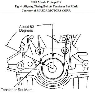

Loosen the tensioner lock bolt to apply tension to timing belt.
Turn the crankshaft clockwise 1 and 5/6 times, and align the timing belt pulley mark with the tensioner set mark.
Hold the crankshaft using the SST, and remove the pulley lock bolt and the pulley boss.
Verify that the timing belt pulley mark is aligned with the tensioner set mark.
Caution: Prevent the tensioner from moving with the tensioner lock bolt as it is turned.
Tighten the tensioner lock bolt.
Install the pulley boss and the pulley lock bolt.
Turn the crankshaft 2 and 1/6 times, and face the pin on the pulley boss straight up.
Verify that the camshaft pulley marks are aligned with the timing marks as shown.
If not, repeat from Timing Belt Removal Note and reinstall the timing belt.
Note: Timing is normal if: the pulley boss position pin and the camshaft pulley marks (I) and (E) are facing straight up. the timing marks are aligned to the horizontal surface on cylinder head.
Inspect the timing belt defltion at the point indicated by applying moderate pressure 98 N (10 kgf, 22 lbs) .
If not as specified, remove the timing belt and repeat from Step 1. Timing belt deflection 6.0 - 7.5 mm (0.2 - 0.29 inch)
Verify that the grooves on the cylinder head cover are free of oil, water and other foreign material.
Apply silicone sealant to the cylinder head as shown. Thickness 3.0 - 4.0 mm (0.12 - 0.15 inch)
Tighten the cylinder head cover bolts a few turns in the order shown.

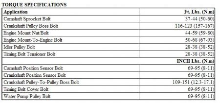

BLUELIGHTNIN6
  • 16,542 POSTS
https://images.2carpros.com/forum/automotive_pictures/261618_Noname_242.jpg
https://images.2carpros.com/forum/automotive_pictures/261618_Noname2_70.jpg
https://images.2carpros.com/forum/automotive_pictures/261618_fig1_6.jpg
https://images.2carpros.com/forum/automotive_pictures/261618_fig2_7.jpg
FIGURE 3
https://images.2carpros.com/forum/automotive_pictures/261618_fig3_5.jpg
https://images.2carpros.com/forum/automotive_pictures/261618_fig4_6.jpg
https://images.2carpros.com/forum/automotive_pictures/261618_fig5_3.jpg
https://images.2carpros.com/forum/automotive_pictures/261618_ts_3.jpg
Let me know if you need further assistance.. Thanks for using 2CarPros.com!

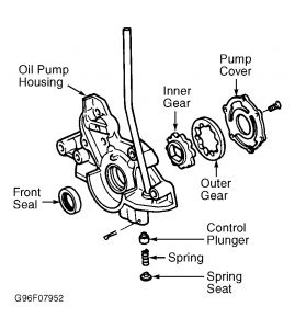

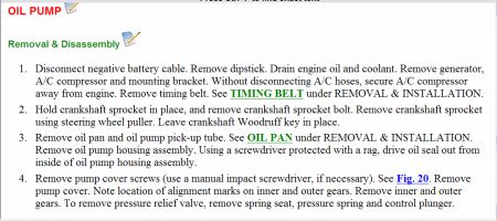

OBXAUTOMEDIC
  • 3,717 POSTS
Here is the info... You can press your "CTRL" key and the "+" key to zoom in for easier reading....
https://images.2carpros.com/forum/automotive_pictures/188069_2000protegelx16oilpumptext_1.jpg
https://images.2carpros.com/forum/automotive_pictures/188069_2000protegelx16oilpump_1.jpg
