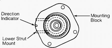

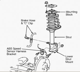

I will be replacing the rear struts on my 2000 Mazda Protege. What is the specific procedure for this vehicle? Are there any particular pitfalls to look out for? Is it necessary to have a wheel alignment done after the replacement?

STRUT ASSEMBLY Removal & Disassembly 1. Raise and support vehicle. Remove rear package trim. On Protege, remove cap, sponge and fastener. Remove clip and brake hose. See Fig. 5 . Remove ABS wheel speed sensor harness. Remove shock absorber bolt, nut and sheet. Remove shock absorber and spring. Remove piston rod nut, mounting rubber and washer. Remove upper spring seat. Remove dust cover, bound stopper and coil spring. Remove lower spring seat. Remove rear shock absorber. 2. Clamp strut securely in a soft-jaw vise. Loosen upper strut shaft nut several turns, but DO NOT remove nut. Compress coil spring, then remove nut. Remove remaining components, note order for reassembly purposes. Inspection Check strut tube for damage, oil leakage and abnormal noise. Check rubber components for deterioration or damage. Inspect coil spring for signs of fatigue or damage. Replace components as necessary. Reassembly & Installation To reassemble, reverse disassembly procedure. Ensure coil spring is seated in upper and lower seats. Ensure mounting block is positioned in alignment with lower strut mount. See Fig. 6 . To install, reverse removal procedure. Fully tighten nuts and lower bolt to specification with vehicle resting on ground and suspension unloaded. See TORQUE SPECIFICATIONS . Check rear wheel alignment. See SPECIFICATIONS & PROCEDURES article in WHEEL ALIGNMENT. Fig. 5: Exploded View Of Rear Strut Assembly Courtesy of MAZDA MOTORS CORP. Fig. 6: Positioning Strut For Installation Courtesy of MAZDA MOTORS CORP. REAR SUSPENSION -2000 Mazda Protege DX Page 1 of 1 4/13/2009
