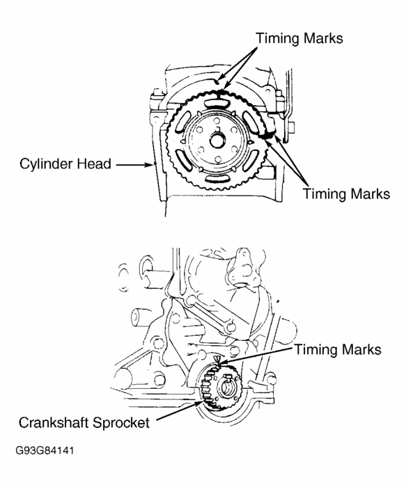

The timing for my car recently slipped due to a broken tension-er spring. I have replaced the tension er, tension-er spring, idler pulley, timing belt, spark plugs, and plug wires with OE replacements.
I have the timing mark on the crankshaft pulley aligned with the "T" on the lower timing belt cover which puts the crankshaft sprocket key-way just past the 12 o'clock position. The timing marks on the camshaft sprockets are aligned. With the crankshaft pulley in this position the number one piston is down instead of being up.

Piston needs to be all the way up, TDC. The timing marks are designed to line up with the piston in the number one firing position which is all the way up.

That is what I thought but everything I read said that having the key-way at the 12 o'clock position should place number one at TDC.
Am I correct that the piston order is 3 2 1 4?
If that is correct, how do I have number one at TDC and have the key-way @ 12 o'clock?

number one is the first cylinder, the one closest to the timing belt.They are 1, 2, 3, 4. the firing order is 1, 3, 4, 2.
I found this guide to help with the timing belt replacement.
https://www.2carpros.com/diagrams/mazda/protege/1999

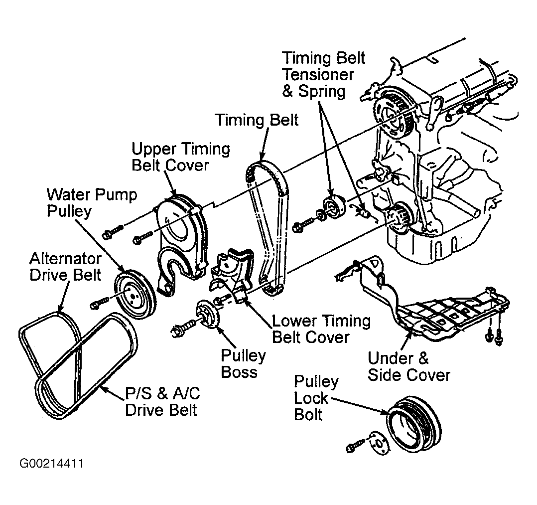

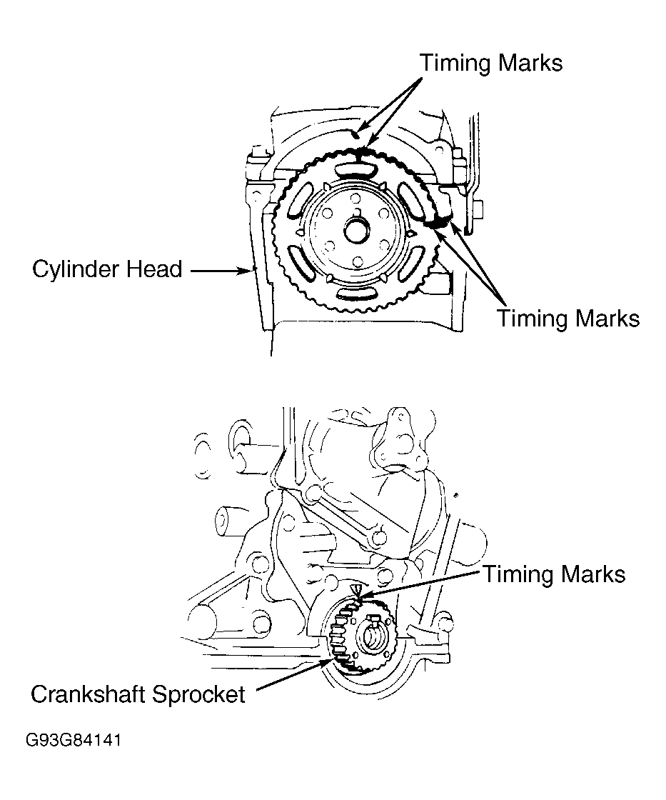

BMRFIXIT
  • 19,053 POSTS

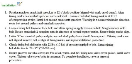

No special pulleys needed this is the procedure to removing and replacing the timing belt I would also do replace the water pump as you have every thing out Removal Disconnect negative battery cable. Raise and support vehicle. Remove right front wheel. Remove right side cover and undercover. Remove drive belts and water pump pulley. Align crankshaft pulley timing mark with cylinder No. 1 at TDC of compression stroke. Hold crankshaft stationary. Remove crankshaft pulley bolts and pulley. Remove crankshaft pulley hub bolt and hub. Remove spark plug wires. Remove valve cover bolts in reverse order of tightening sequence. See Fig. 1 . Remove valve cover. Remove dipstick tube. Remove upper timing belt cover. Support engine with jack. Remove engine mount bracket from timing belt end of engine. If timing belt is to be reused, mark timing belt rotation direction. Ensure timing marks on camshaft and crankshaft sprockets are aligned. See Fig. 2 . Remove lower and middle timing belt covers. Loosen timing belt tensioner lock bolt, and move tensioner away from belt with spring fully expanded. Remove timing belt.
https://images.2carpros.com/forum/automotive_pictures/99387_Graphic1_539.jpg
https://images.2carpros.com/forum/automotive_pictures/99387_Graphic2_262.jpg
Position notch on crankshaft sprocket to 12 o'clock position (aligned with mark on oil pump). Align timing marks on camshaft sprocket and crankshaft. See Fig. 2 above . Ensure crankshaft timing mark is at TDC of compression stroke. Install belt around crankshaft sprocket. Working in a counterclockwise direction, route belt around pulleys and camshaft sprocket. Loosen timing belt tensioner lock bolt, and allow spring to apply tension on belt. Snug tensioner lock bolt. Rotate crankshaft 2 complete turns in direction of normal engine rotation. Ensure timing marks align. Letter "Z" on camshaft pulley and pin on crankshaft pulley boss should face upward. If timing marks are not aligned, remove belt, realign all timing marks, and repeat installation procedure. Check timing belt deflection with 22 lbs. (10 kg) of pressure applied to belt. See Fig. 3 below. Ensure timing belt deflection is .28-.35" (7.0-9.0 mm). Ensure grooves on valve cover are free of oil, water, and dirt. Using new valve cover gasket, install valve cover. Tighten valve cover bolts in sequence. See Fig. 1 above. To complete installation, reverse removal procedure.
https://images.2carpros.com/forum/automotive_pictures/99387_Graphic3_118.jpg

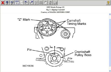

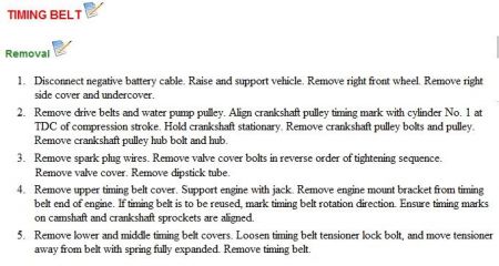

How to replace the timing belt on a 95 Mazda Protege 1.8 Lt. Du overhead cam. ? Anything else I should do at the same time?

BLUELIGHTNIN6
  • 16,542 POSTS
https://images.2carpros.com/forum/automotive_pictures/261618_Noname_1993.jpg
https://images.2carpros.com/forum/automotive_pictures/261618_Noname2_645.jpg

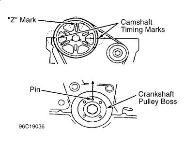

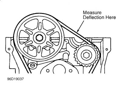

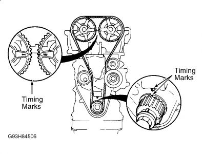

How do I set timing marks for cam and crank to install timing belt
Aug 3, 2020 at 1:59 PM (Merged)
  • 75,992 POSTS
What engine is this 1.5L or 1.8L
https://images.2carpros.com/forum/automotive_pictures/12900_timing_alignment_1.jpg
TIMFARR1
1.5
  • 75,992 POSTS
Above is for the 1.5Litre
