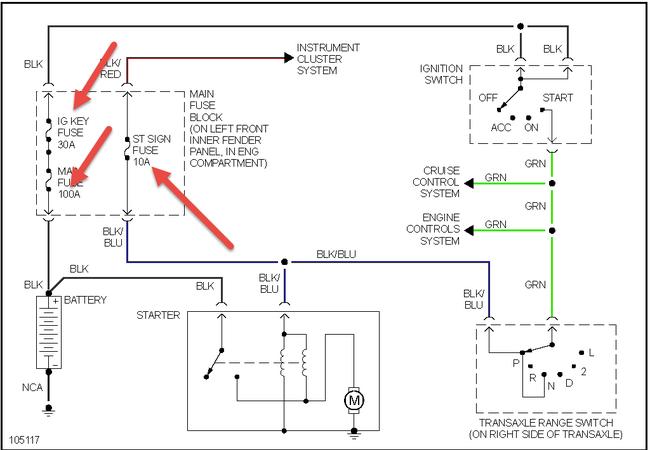

I've ha this problem for about 2 3 months now and it's a problem starting the car like it doesn't crank all I hear is the key when I turn it. Now this problem happens after I started the car and drove about 20 30 or however much I drive then I go to start it and nothing sometimes I'll keep on switching key to see it will turn on and it does but sometimes it hasn't I changed starter altanater and battery.

HMAC300
  • 48,601 POSTS
Check fuses in pic then check to see if power goes through trans switch if no power through fuses try bending prongs just a tad to see if they will make contact as it may be a fuse box problem or corrosion on fuses
