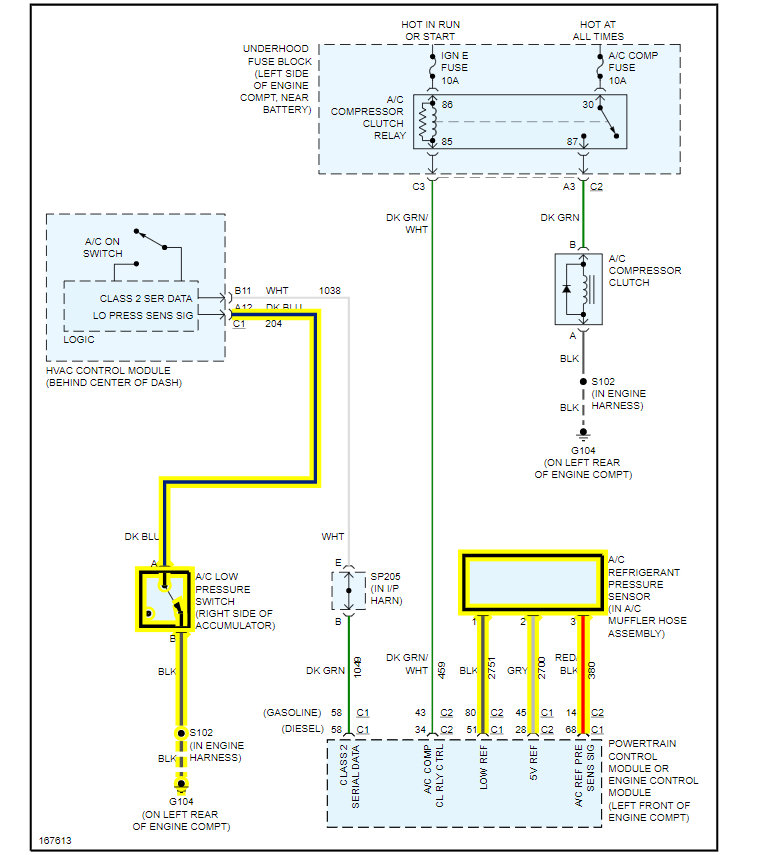

I have been having an issue with my A/C clutch not engaging. I have pulled the relay and jumped the terminals and it will engage that way. So I’m assuming that either the high or low pressure switch is bad. I will replace both beings they aren’t too expensive. But I am wondering if it would be okay to just leave the relay jumped for the time being? It’s over 100 degrees so I didn’t know if I could just allow the clutch to stay engaged without damaging anything. I was also thinking about just running two wires from the relay where I would typically have it jumped, to a switch and have the switch in the cab, so I could manually turn the clutch in and off. If I did do that how often would I want to cycle the clutch? What are the risks of letting the compressor stay engaged too Long?

Good morning,
First, I would assume nothing as far as the switches until testing is done and verified. I attached a wiring diagram for you to view. Check the high-pressure switch for power and the low side is a transducer.
As far as running it bypassed, you will ice up the evaporator to the point that you could damage the compressor since it has no protection.
