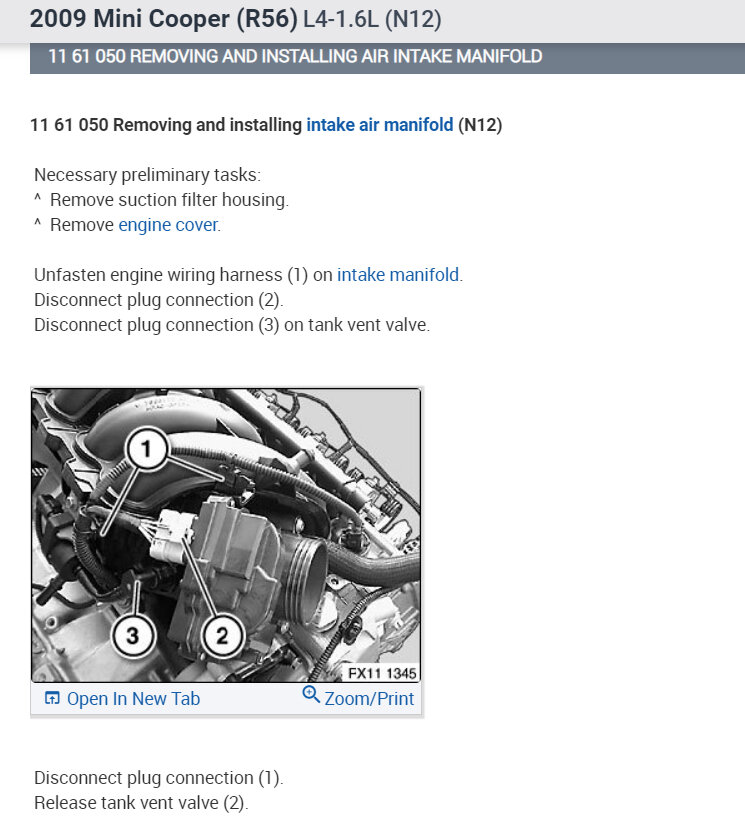

Has a very minor hiccup when cold, only have one code 2B64 Digital motor electronics: intake manifold, unmetered air.
Oct 12, 2022 at 3:28 AM
  • 55,433 POSTS

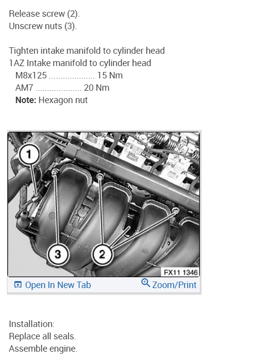

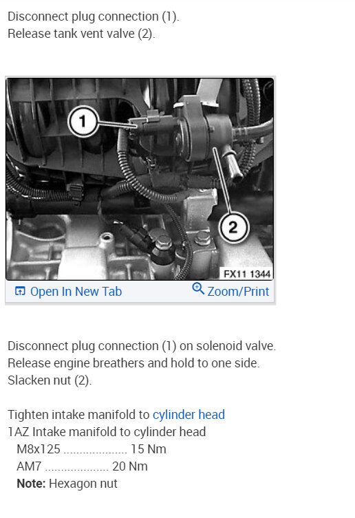

So, the code 2B64 means there is air leaking into the intake manifold that is not passing through the air meter, it will probably be the intake is cracked which is common or you have a gasket or hose leak. Check the air intake tube for leak, use a flashlight and really go over the plastic intake then if you can't find it test the engine cold by following this guide:
Here are some key points to look for a leak
Oct 12, 2022 at 10:44 AM
