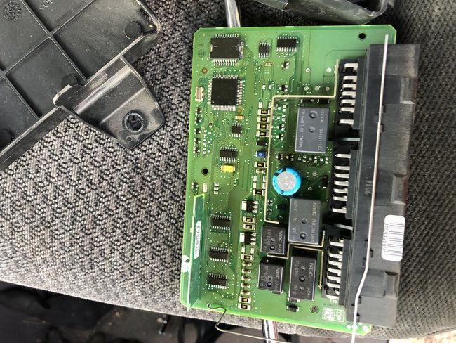

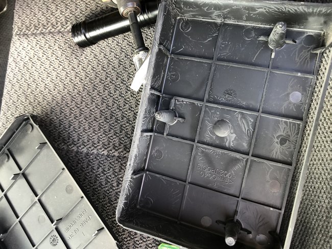

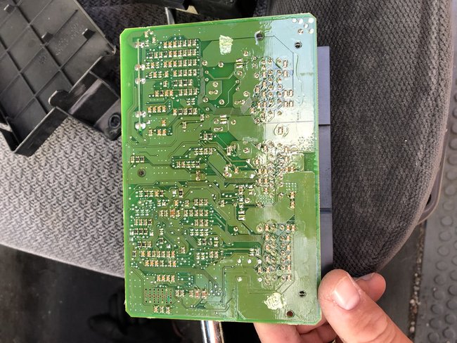

Okay, got the VSM out. What am I looking for with water damage? Seems to be some sort of discoloration on the cover.
Saturday, April 11th, 2020 AT 4:35 PM
  • 52,797 POSTS
Okay, it does not look water damaged but that does not mean it is not good. You need special equipment to check it to see if it has failed.
Saturday, April 11th, 2020 AT 4:44 PM

From what I’ve been reading, I’m guessing I’ll be better off buying a new one and getting it programmed. As I’m also guessing having it checked out by a dealer will be close to a new one and programming with diagnostic costs.
Saturday, April 11th, 2020 AT 4:47 PM
  • 52,797 POSTS
That makes perfect sense but if it were my truck, I would want to know it was the issue before buying one. I like to have some sort of confirmation before replacing the part.
