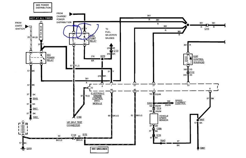

1989 F250 4x4 300 6 cylinder. I had lot of people tell me it is my computer but I can't find one. Any where on my pickup where is it at?
Please help, crazyhoss

Did you check the fuel pump for power and whether it is working?
Behind LH Kick Panel
I attached a wiring diagram for you to view. Check for power to the fuel relay.
You will need a test light to do some testing.
