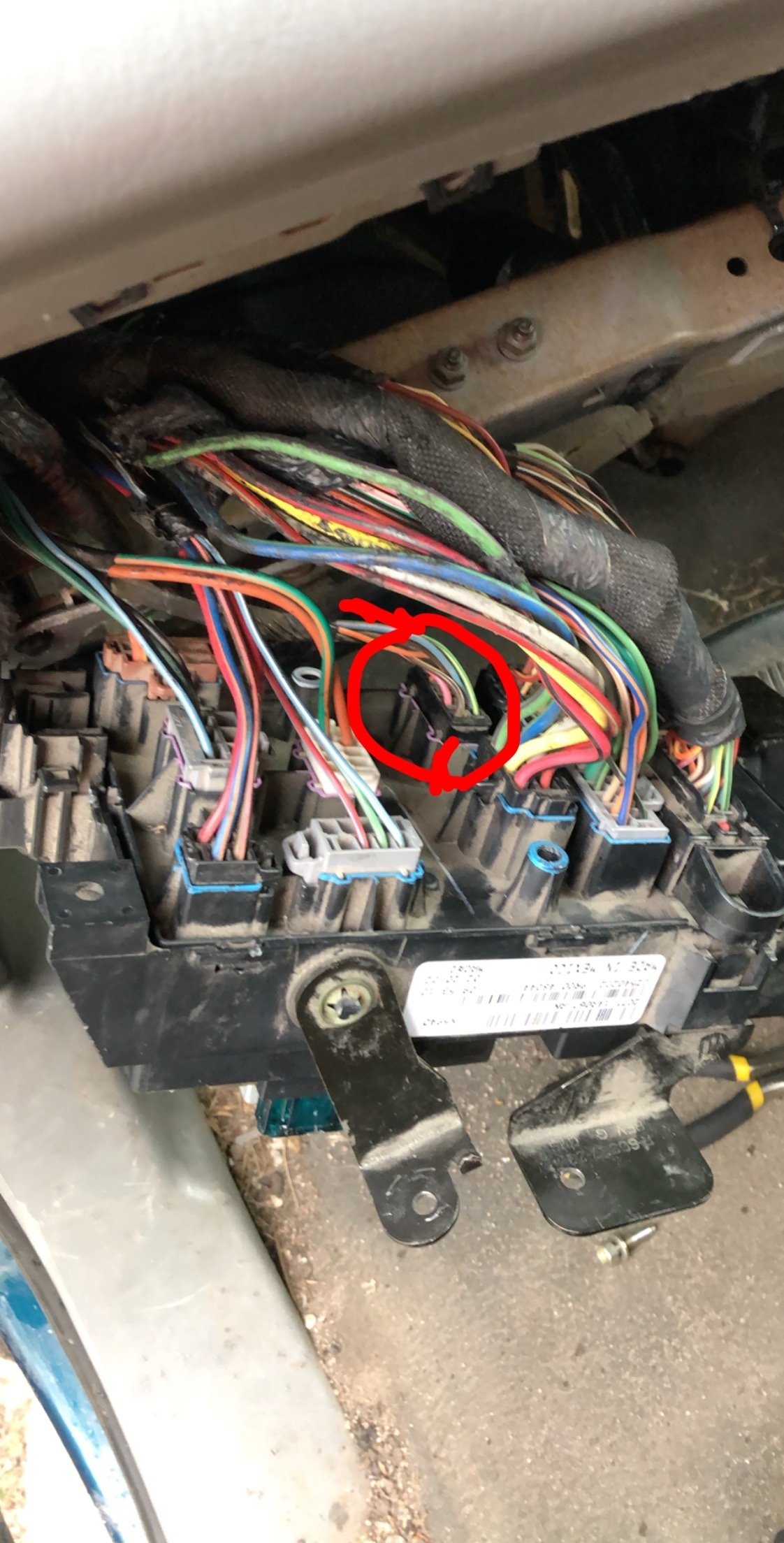

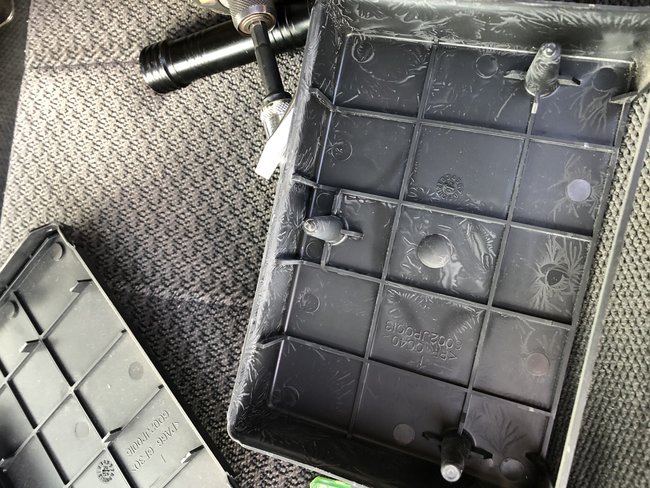

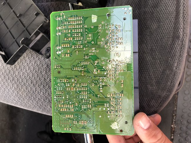

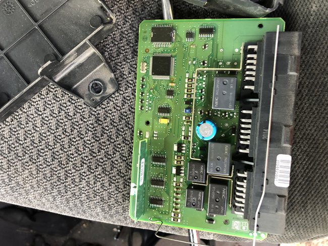

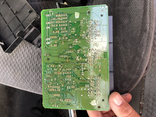

Okay, got the VSM out. What am I looking for with water damage? Seems to be some sort of discoloration on the cover.
Apr 11, 2020 at 9:35 AM
Okay, it does not look water damaged but that does not mean it is not good. You need special equipment to check it to see if it has failed.
Apr 11, 2020 at 9:44 AM
THORN616
  • 30 POSTS
From what I’ve been reading, I’m guessing I’ll be better off buying a new one and getting it programmed. As I’m also guessing having it checked out by a dealer will be close to a new one and programming with diagnostic costs.
Apr 11, 2020 at 9:47 AM
That makes perfect sense but if it were my truck, I would want to know it was the issue before buying one. I like to have some sort of confirmation before replacing the part.
Apr 11, 2020 at 9:51 AM

Just an update. I have a replacement fuse box coming Friday. I’ll return if that doesn’t work. I had the truck at a friends house from work for around two months but he never got around to it and this diagnosing is passed any exposure I’ve had. Don’t get me wrong, I love working on vehicles, but wiring is something I’ve never played with much.

Good news. I found a ground from the alternator split in two. Reconnected and started her up. Wire got hot so I went underneath again. I found the starter battery wire sitting against the chassis and had rubbed through. Totally my fault, can’t believe I didn’t loom it. Fixed that and it appears all codes, even from when I bought it, are gone but I will continue to monitor. Only issues that remain are the power locks and key-less entry do not work. Headlights don’t work but I have running lights and high beams. But when I turn the switch to the headlights, they go out?

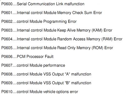

7.3L diesel....clicks at relays at startup attempt....checked relays all good...batteries good...grounds good...new computer installed recently...new starter.....thinking it is the PCM (from advice from friends)....how do we check the PCM??
Jun 18, 2020 at 3:44 AM (Merged)
MERLIN2021
  • 17,250 POSTS
easiest way is to use a code reader, PCM codes are any of these, you have a problem!
https://images.2carpros.com/forum/automotive_pictures/62217_pcm_codes_1.jpg
If your truck has a security LED on the dash, does it blink every 2 seconds? Go out after you leave ignition in ON position for three seconds?
