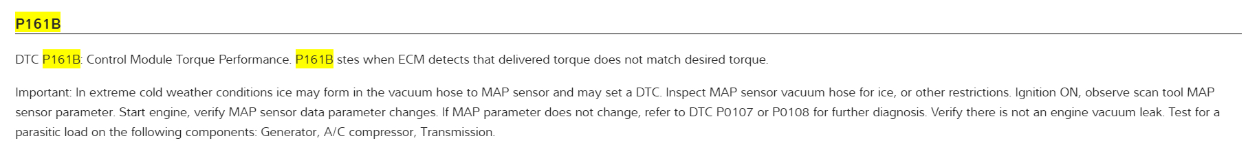

Previous codes p161b, p2110, p2106, p2282. Air cleaner was clogged, installed new filter and new throttle body, air intake tube.
After clearing codes the car would run good for a while. Now it will not start, has codes p0300, p2282, p0340, p2106, p2110, p0134, p161b, p0016

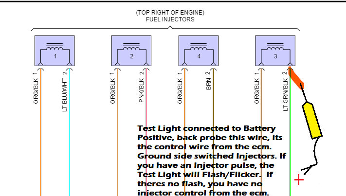

Okay. So, with this many codes and a no start condition. Do you have Spark and/or Injector Pulse?

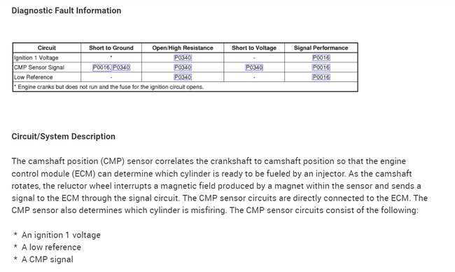

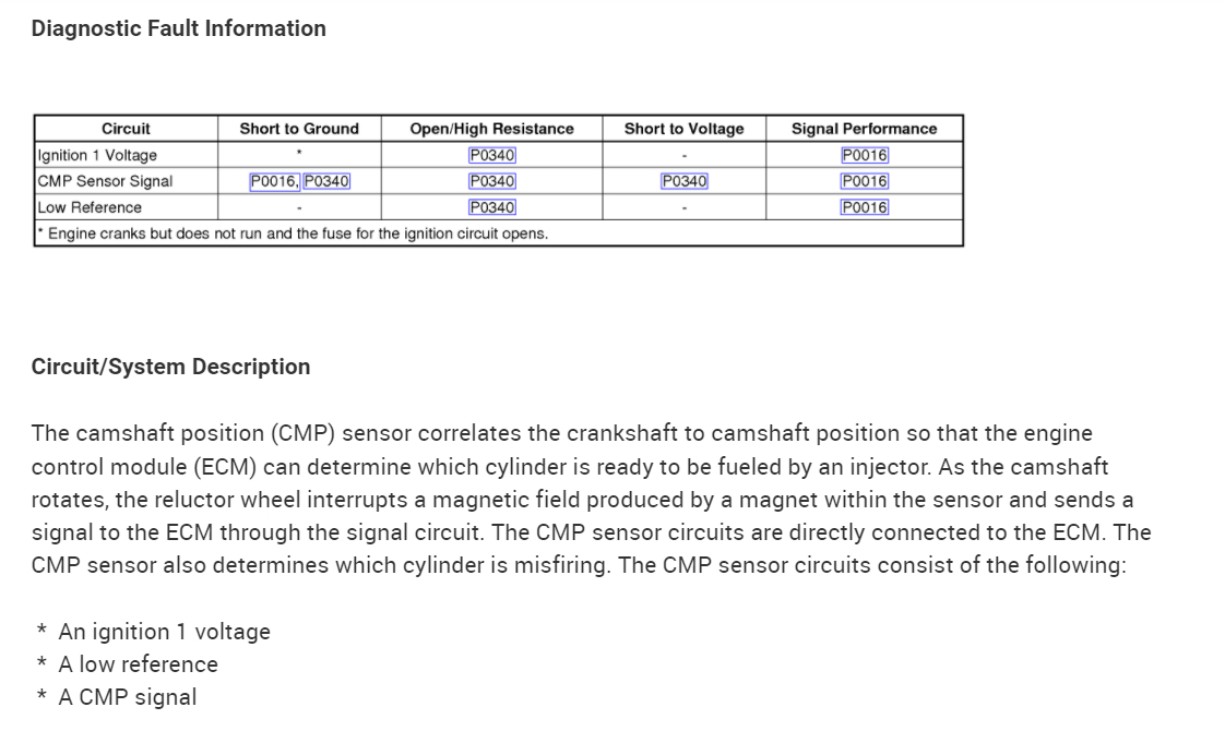

There are 2 codes for Camshaft position sensor, a code for Oxygen sensor activity, a bunch of throttle body forced limit codes. P0300 is a random misfire code, and P2282 is Intake manifold air leak (ECM detects vacuum higher than expected) which is strange because the vehicle won't start so this must be detected during cranking.
There is a TSB on reprogramming the ECM after changing over the PCV valve because there is an updated PCV valve that requires an ECM update, but I think checking this Main Relay and the 2 Fuses (Injector Fuse #13 & DIS EF Fuse #17) should be first. These fuses power up all kinds of things, including some of these Code related components.
I think you'll find you're missing the Fuel Injector Pulse and probably Spark.

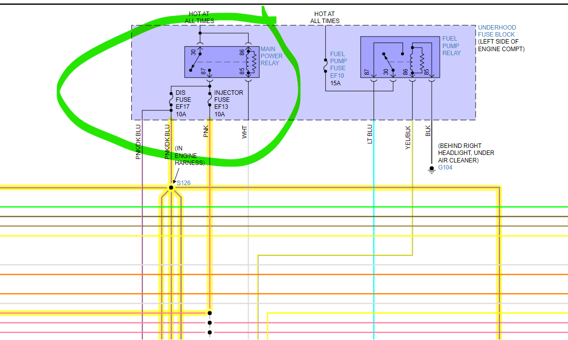

If you take out this Main Relay and use a test light, the slots for pins 30 & 86 should be battery power.
Also, if either of those Fuses are blown, I would just replace them for now and try to start the car, you've replaced a lot of parts so it's hard to tell what may or may not have been faulty.

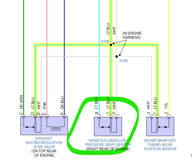

Also, one more check, The MAP sensors 5v Reference feed. It's the light blue wire, back probe it with a T pin and with the Key On engine off, check that wire for 5 volts.

But check those fuses and the Main Relay first, they are in the Fuse panel under the hood (driver's side).

Checked the main relay, it's okay.
Fuses are good as well as 5v reference for MAP sensor.

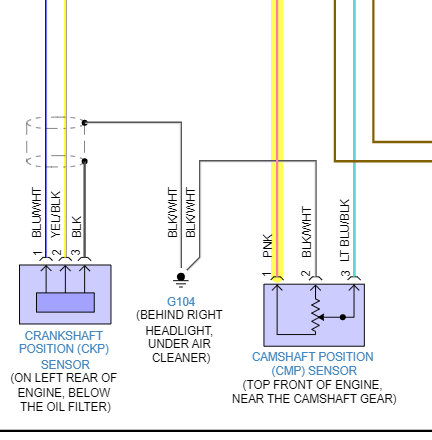

You may want to check the cam sensors, since there's 2 codes relating to that. It would probably stop the injector pulse on this vehicle.

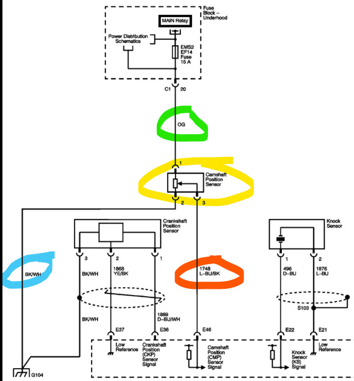

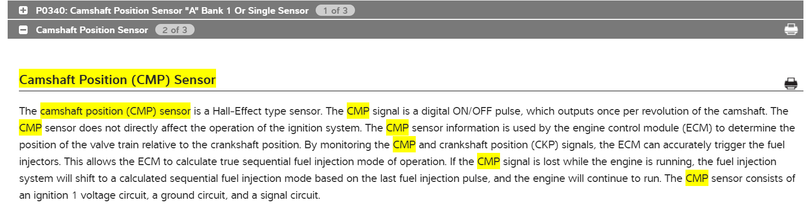

The Pink wire on the cam sensor diagram is the power wire for the hall effect sensor. The code is saying the ECM is missing the signal. There's a power junction (diagram 3) which is in the fuse panel in the driver side engine compartment.

Thanks for pics, the color codes don't match what's in the car.

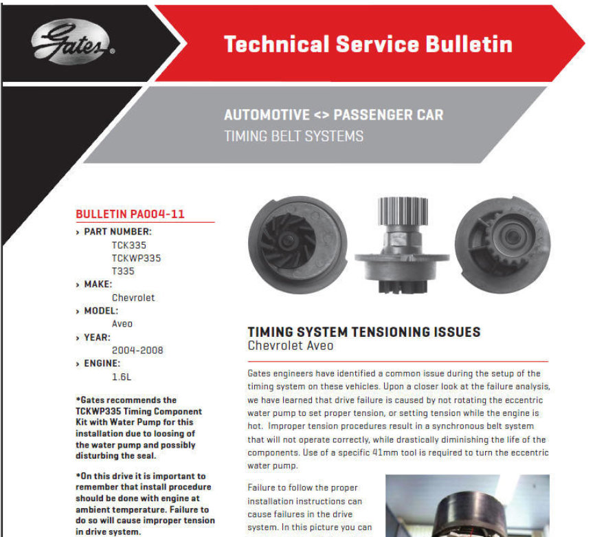

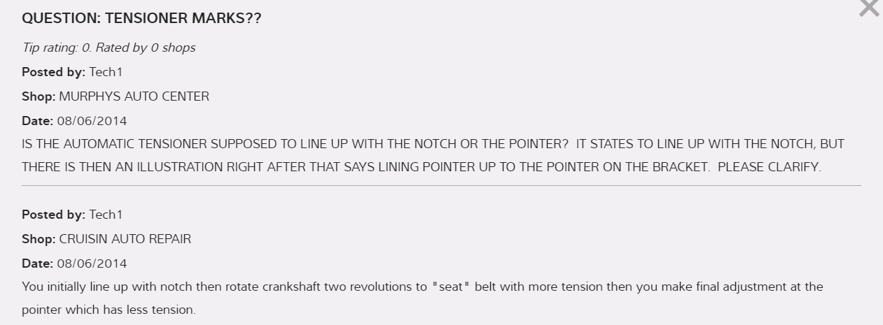

I ended up changing intake manifold gaskets, what a chore that was. Discovered one of the studs on throttle body was missing and intake gaskets were probably leaking, everything's plastic on this engine.
Once reassembled, I noticed a few drops of coolant on the floor and determined water pump. Being i already purchased a new water pump, timing belt, idler and tensioner I tore it all down and in process of putting it all back together. It's unbelievable that everything has to come off including crank and both cam gear sprockets to replace the water pump.

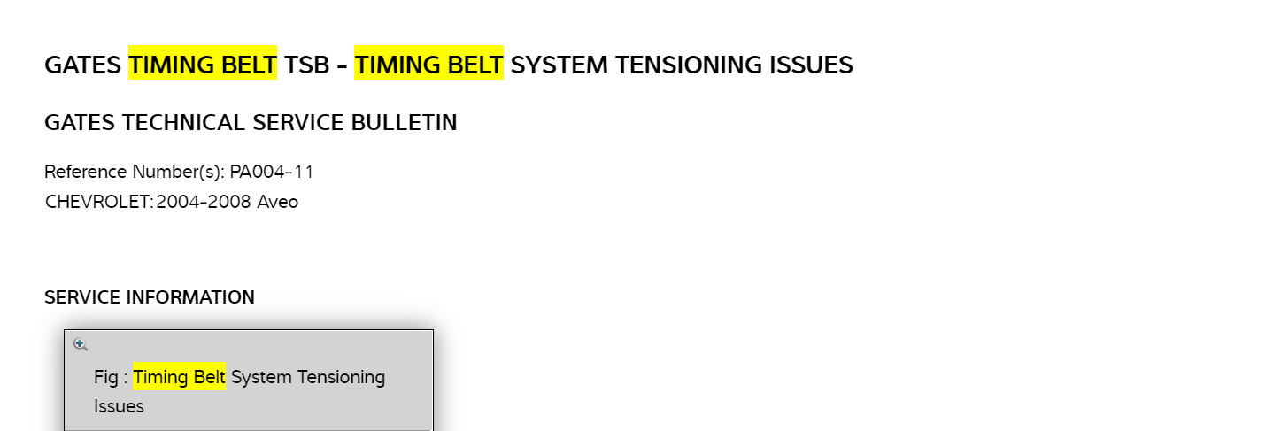

Yes, some of these timing belt/chain setups are really crazy, I've been through sometimes where trying to get the cam sprockets off, the bolt would break. I don't know why cam sprocket bolts always seem to be the worst, but it's good you're doing all of it while you're in there.
What Sub-model is this, Base, LS, LT? ill check on why the wiring diagrams are the incorrect color. And Hatchback or Sedan?
Actually all 3 Sub-models have the same engine. Which wiring colors are incorrect? I will check All Data and Mitchell and see what's going on there because we want to make sure you definitely get the correct information. If there's an error on either, we can leave a note about their wiring diagrams for certain makes and models. Not something we want messed up on you. And can you take a picture of the engine before you get it all together if you haven't already. At whatever stage you're at.
I think you're going to take care of a lot of these codes with the intake gasket done though.
Do you need torque specs on anything?
And just so you know there is a TSB on the Timing Belt Tensioner.
Jan 4, 2022 at 5:27 PM
AL514
  • 5,587 POSTS
This might be why the water pump failed. Something to consider.

Car is Aveo LT Sedan. The colors on the cam sensor were not right, mine had orange, black/white stripe and grey with stripe.

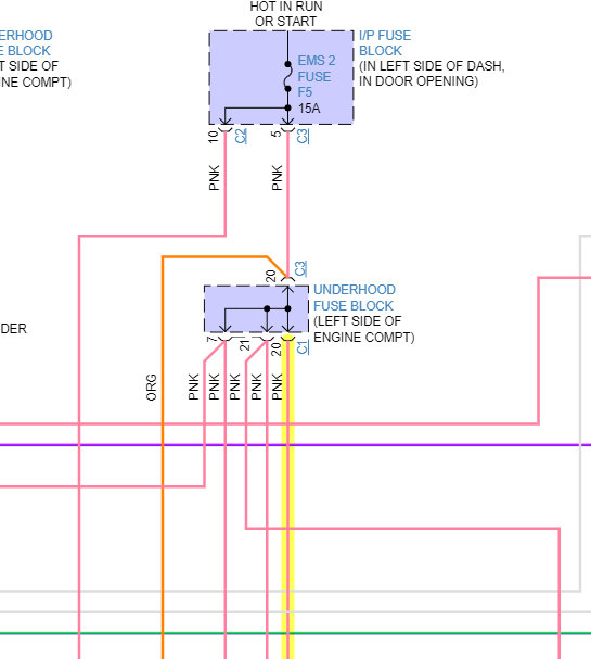

And do you have power at (correction) EMS 1 Fuse EF 13 15amp and EMS 2 Fuse EF 14 15 amp in the fuse block on the driver side engine compartment? The Main Power Relay powers these 2 fuses and the power a whole bunch of things, including the cam sensor.
Okay, both All Data and Mitchell have the wiring for the cam sensor incorrect, it happens sometimes. But your orange wire is the 12volt feed. The Black/White wire is the sensor ground, and your grey/stripe (circled in reddish) is the signal wire back to the ECM.
The Crankshaft position sensor is there too.
So, you will have a pulsed 5volt, or 12volt signal, although I have seen some Hall Effect sensors that are also 10volt pulsed signal.
But check those Fuses first, they change if this is not a drive by wire system, so it would have a throttle cable going to the Throttle body, let me know which you have.

Yes, drive by wire system. EMS1 @ 2 fuses are good.
Cam sensor at plug 12v at feed (orange)
5v at signal wire (gray/stripe)
Injectors all ohm out ok and have 12v at plug for all 4 injectors.
Then checked crank angle sensor
only 2.4v at feed and 2.4v at signal wire.
These were all checked at the plugs with sensors disconnected, key on.

Okay, well, first thing is that the Crankshaft position sensor on this vehicle is a variable reluctance sensor, meaning it's a 2-wire sensor, (and I know it has 3 wires, but one of those is a shielded ground connection). So, this sensor puts out an AC Voltage Sign wave signal, usually a lab scope is used to watch the signal on these types of crank sensors. But with having both codes P0016 & P0340 in conjunction with each other, this is pointing to a potential short to ground according to one of the diagnostic charts, if you're still getting these codes. I have a full note pad out with all the codes this car has thrown out since the beginning of this. The P0340 is Camshaft Position Sensor "A" ECM detects no signal, but the P0016 is a correlation code, meaning the Crank sensor and Cam sensor are not lining up properly. Have any of these codes come back?
There are a few possibilities here, but I'm still leaning towards a wiring harness issue, you may have the correct voltage at the sensor, but that doesn't mean its signal is getting to the ECM, and if you're only able to check with a multimeter, you won't be able to see what the signals actually look like. I mention the wiring harness issue again because you also had a P0134 02 sensor circuit Bank 1 Sensor 1 No Activity, and this is the upstream sensor before the CAT, and it monitors the Air/Fuel ratio and is a critical sensor. If it's not functioning at all, or the signal is not getting to the ECM, you'll have no fuel control.

You can see if you have a Fuel Injector pulse using a test light if you have one. To do this test, you'll notice all the fuel injectors have 2 wires. One wire on all the injectors will be the same color (which you noticed when you checked them for power). The other wire is the control wire for the injectors. They will be the different color wire on each injector. With a Test Light connected to Battery Positive +, Probe the back of the Injector plug on the control wire (odd color one). Cranking, the test light should flash.

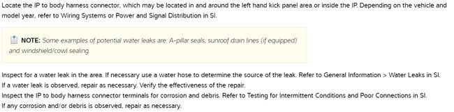

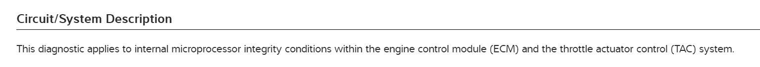

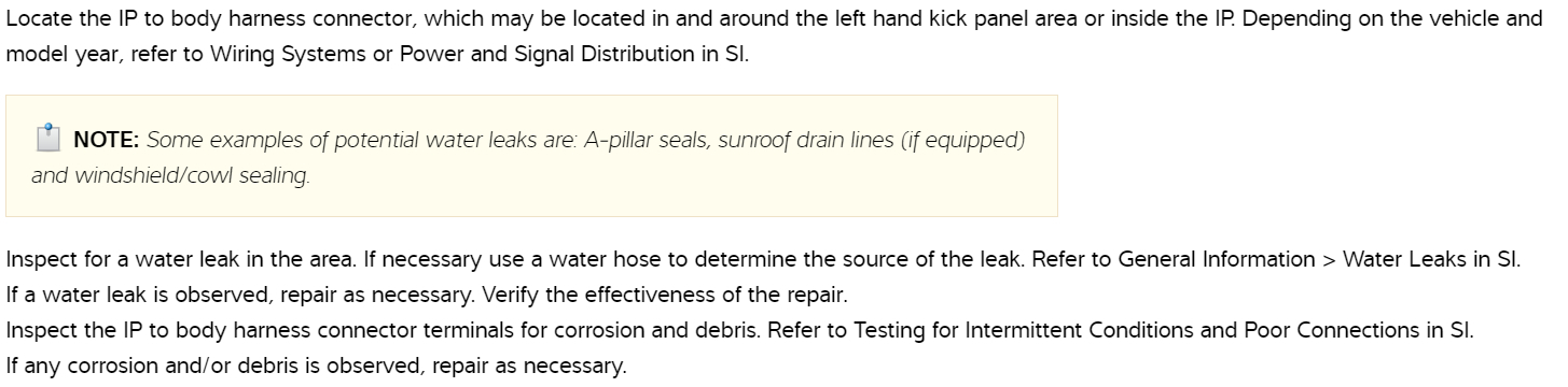

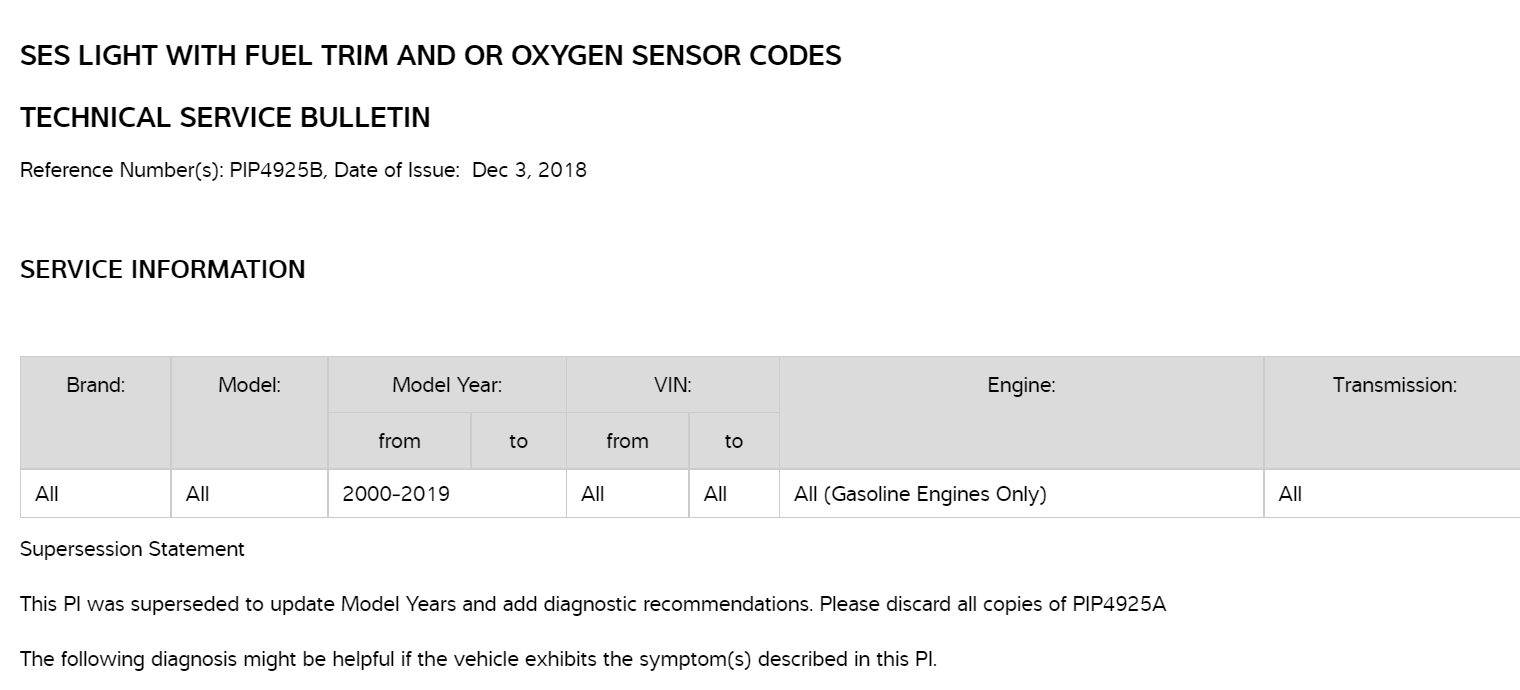

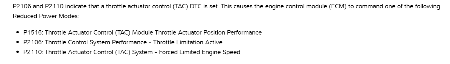

And I'm really sorry, but there are 3 TSBs that are major Technical Service Bulletins.
The first is for Oxygen Sensor codes and the next is for water intrusion that can get into the fuse panels inside the vehicle. So please check around the driver's side kick panel for water leaks and behind any Fuse panels for green corrosion.
Then there's the third, which is a very major TSB, it has to do with the PCV system Update and Throttle Body with ECM reprogramming to resolve the issue. Its description is the fourth diagram. It's a really huge TSB, which is why i will only post it if you want it. It's "35" pages long. And is a walk through the whole PCV/Throttle Body issue and reprogramming the ECM and new updated parts. These cars have a lot of problems, I'm really sorry. But it explains all these codes, if there isn't a wiring issue.

I think this is an ECM issue. This car has never been back to dealer since new and apparently, they've done a lot of updates on this control module.

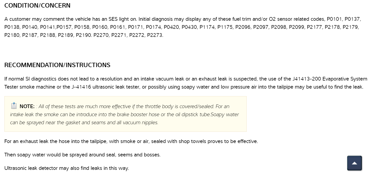

There are some bulletins on excessive carbon build up on the valves and valve seating areas causing misfires, no start, extended crank times and rough idle.
Is there any freeze frame data with that code? That would help a lot.
