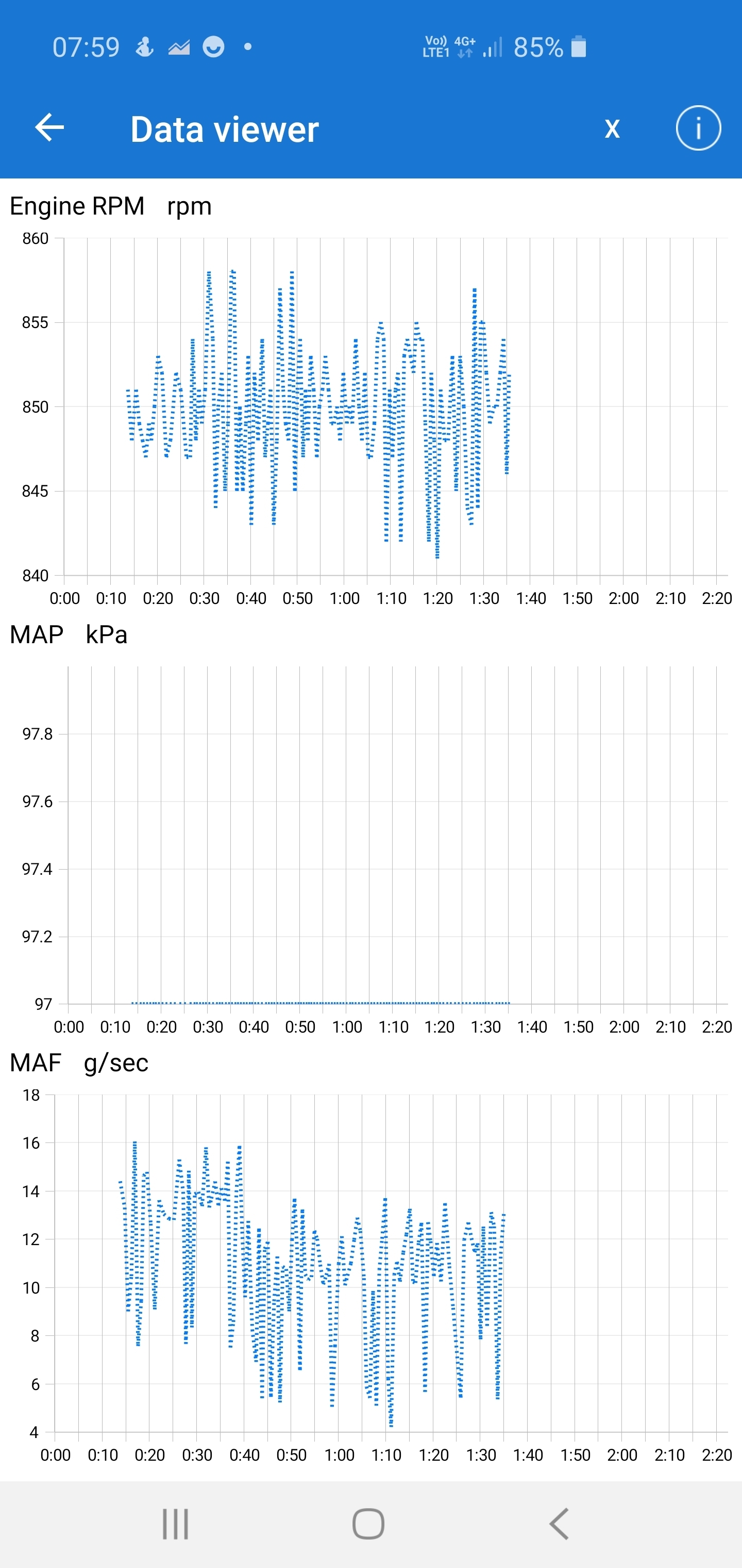

GRAEME PARKER-WILLIAMS
  • 10 POSTS
I don't have a vacuum gauge so unable to check that at the moment. I have used two different obd2 readers and two different apps the MAP does not fluctuate have attached a screenshot of about one minute on idle.

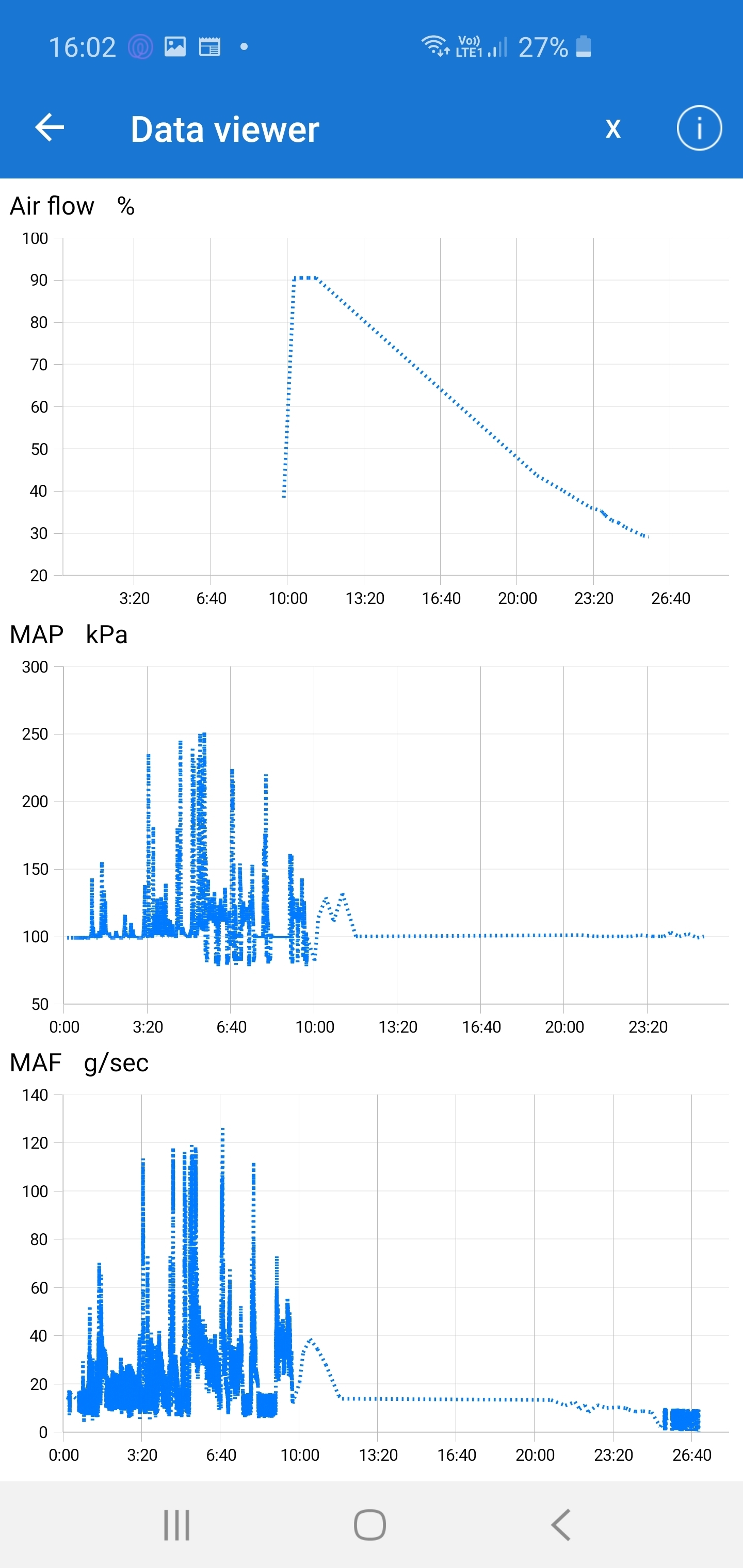

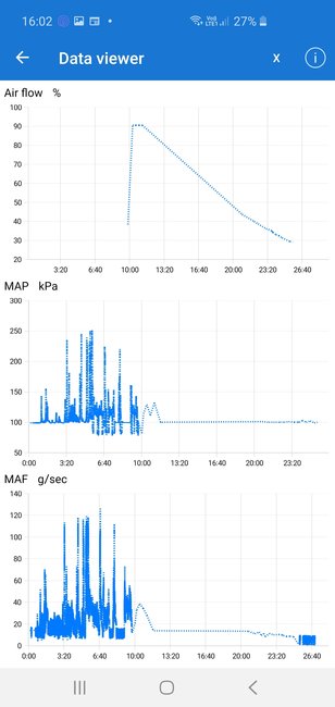

  • 10 POSTS
I have inspected the air filter box and filter,checked for any loose pipes and cannot find any. I had a look in the throttle body and a little bit of oil was present. I also took the revs from idle to 2,000 then 3,000 revs and the MAP readings hardly changed. Is this a bad MAP sensor causing the issue? See attached graph.
Feb 10, 2020 at 12:55 AM
JOETECHPRO
  • 705 POSTS
Hey GRAEME PARKER-WILLIAMS,
Can you please remove and clean the MAP sensor?
I do not have the information for your specific vehicle but a quick search online should show you the position on the intake.
It is likely that oil residue has clogged the transducer on the MAP and is causing it to not respond to the changes in pressure.
Let us know what you find.
Regards, Joe

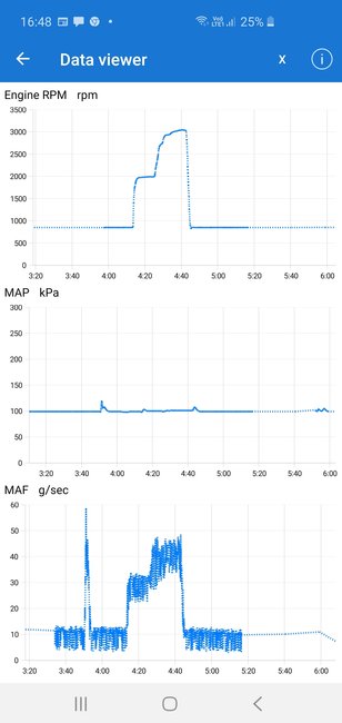

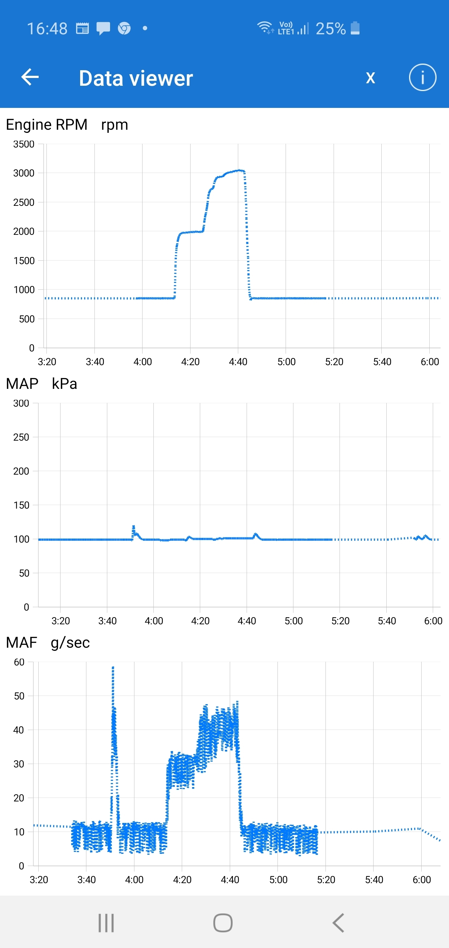

Feb 10, 2020 at 1:24 PM
  • 10 POSTS
I have cleaned the MAP sensor and I am now getting readings up to 250kpa. The MAF readings still fluctuate. The strange thing is that during a regen today the MAF readings were stable. Regen happened after 10 minutes of driving. Regen is happening after every 50 or so miles bit it's mainly short journeys.
Feb 11, 2020 at 12:04 AM

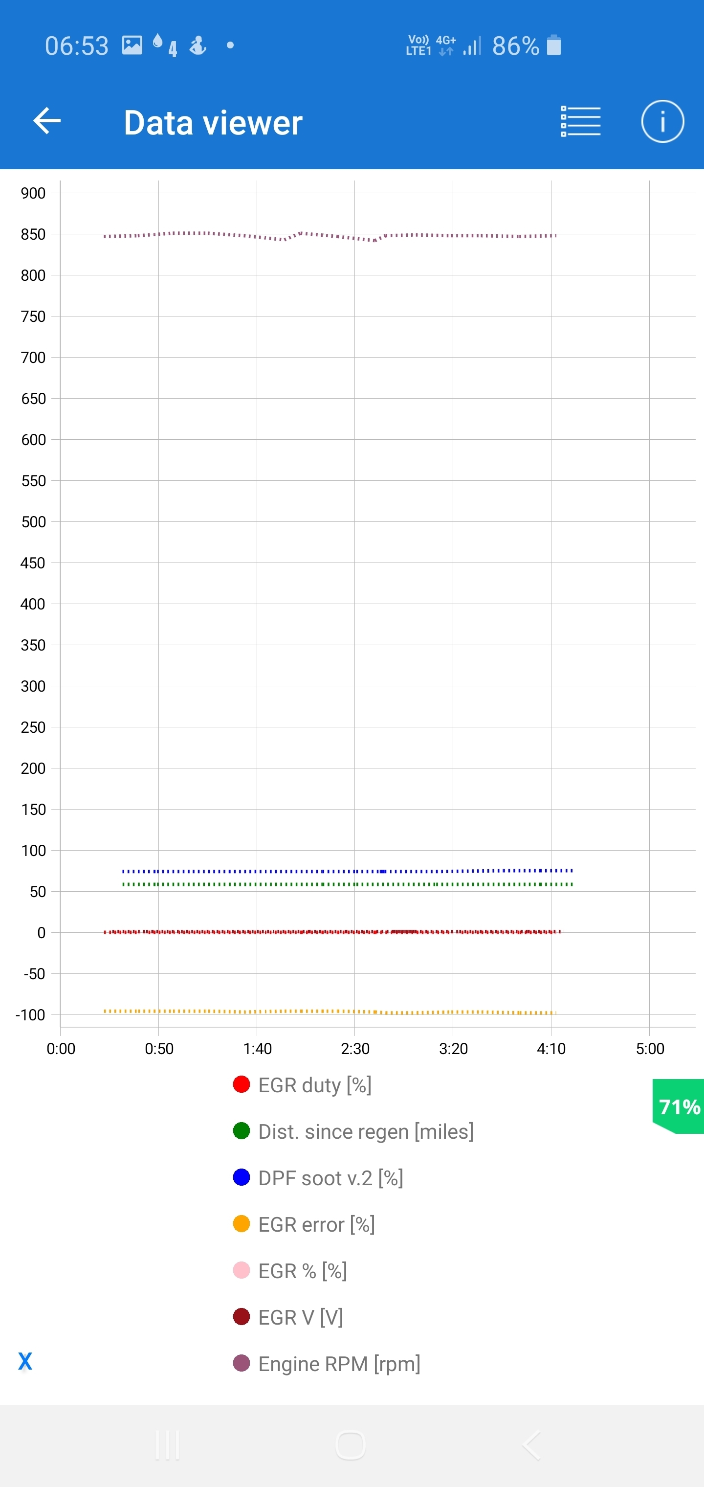

  • 10 POSTS
Hi, no fault codes stored, car is running better now slight lag before turbo. DPF is showing 72% after 58 miles. The car is mainly used for short journeys with one long trip a month. The car will regen when the load gets above 90% I then take it for a run to complete. It regens to 32% but according to the workshop manual this is what Asta 1.7 Cdti's regen too. I am going to try a completely different scan tool as the MAF readings are still all over the shop without any cause. I am getting an EGR error as per image not sure if this is okay.
Feb 23, 2020 at 2:54 PM
