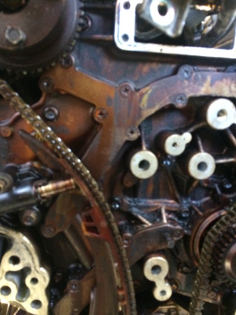

3. I opened the timing chain cover and replaced the water pump, all three timing chains, the main guide and the guide on the right. I purchased new timing chains so that I could see the timing marks. (I wanted to make sure it went back correctly in case it skipped) I replaced the main timing chain tension-er and the guides on each of the secondary timing chain tension-er's, and coolant temperature sensor. I replaced the radiator. I used a no spill funnel to remove the air from the coolant system.
I noticed that inside the timing chain case there was a buildup of dried oil in spots.

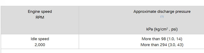

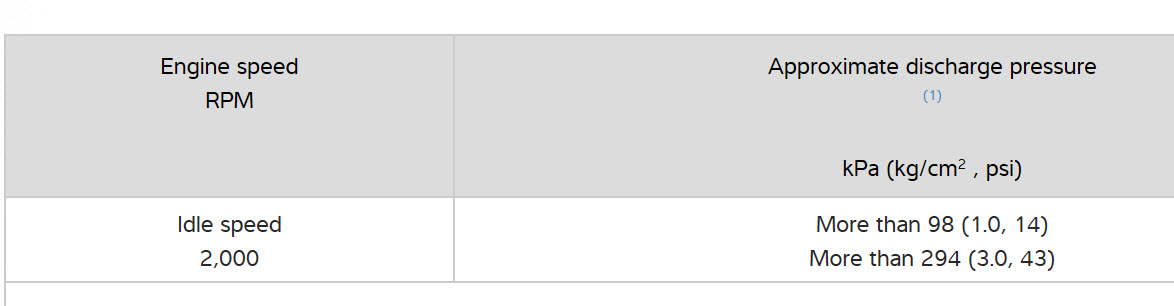

6. I tested the oil pressure when I first start the car at idle of 1,000 rpm it is 40 psi and 40-55 psi @ 2,000 rpm.
after warm up
only 3 PSI @ 1,200 rpm and 5 PSI @ 2,000 rpm and noise when I hit the gas and a loss of power.

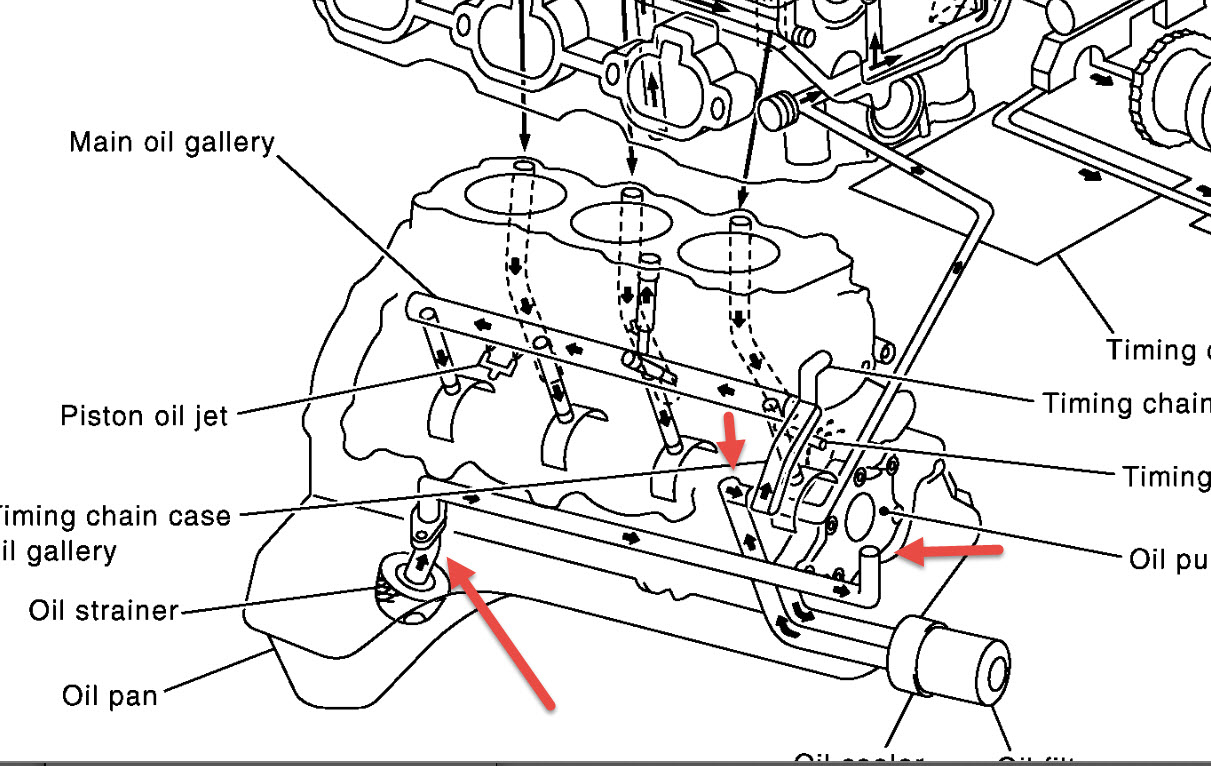

The relief valve is part of the pumps. If anything i'd drop the pan and check one main and one rod bearing furthest from the pump. See how they look or send pics back of bearings so I can give you an idea. But prior to do oing change oil filter as sometimes they are the problem especially if it's a fram, try a napa, wix, Purolator. Those seem to have less problems or a factory one. Do the easy stuff first. If you decide to do an oil pump just replace it don't mess around with checking relief valve because cold/hot they act different. You might try a straight 20w oil as well see if that changes things if it does then it's probably bearing wear

My timing case had oil (see the photo) in it and didn't look like everyone else's online, which is why I thought that it was the main oil gallery. In addition to the low oil pressure and the loss of power, It seems that my noise occurs when it is warm and I hit the gas (with a slight delay). I think i'm hearing slack in the timing chain (which is why I think that the timing chain guide broke originally). Here is a photo of the timing chain case prior to when I repaired the main timing chain guide. You can see there is dried oil in the case. I thought it was really odd when I had it open. This is why, more recently, I thought it might be an oil gallery leak causing my pressure loss.

What you see is sludge and varnish and can be from oil used or how often changed etc. Also re reading you rfirst question it says after you replaced timing chain so I would suspect either a pump problem or partial blocking of pump pickup or an air leak there. If you take the pump off pack gears with Vaseline prior to starting as well and make sure pickup has good connection to pump. But i'd try 20w oil first prior to taking pan off see what you get there, if it still drops then it may very well be a bearing problem.

I tested the car with the 20w non detergent oil. When cold, I got about 40 psi at idle and then it dropped to about 30 psi as I was testing. When cold at 2,000 rpm it was 60 psi and then dropped to 50 psi as I was testing. The oil pressure seemed to bounce a little.
After warm up. There was 0 psi at idle and around the same 3 psi at 2,000 rpm (same as prior to the oil change). There is a hesitant buzz/rattle after I hit the gas when warm and the psi is low. The sounds seems to come from the passenger side rear exhaust pipe before the muffler. I thought it might be an exhaust item, but it really only appears when the car is warm and when I have low psi, so I'm more suspect.
Overall, I didn't really notice a difference from my last test. In both situations the psi drops lower and lower as it warms up. I'm not sure how accurate the gauge is if we are trying to notice a slight difference, it is a new 8milelake Oil gauge- it had fine reviews for a $55 gauge online.

I am really out of ideas from the diagram i'm sending the oil lines go no where near the rear cover so I would rule that out and I see no tips from other mechanics for this problem. If I were you and you REALLY want to put the time and energy into this then where arrows point I would look for a problem there or partial blockage. Because if it's cold and has good pressure then gets warm and drops but from your testing the second number is warm i'm assuming so with heavier oil in it drops about 10 psi so it leads me to a bearing problem. Or leaking where I've pointed out that is all I can think of. From the factory chart shows only 14psi at 2000 rpm when warm and ALL oil will drop when warm see pics
