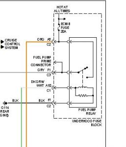

DAVE H
  • 13,384 POSTS
From relay orange wire/relay pin A6/C2 is HOT all times to PCM 12volts
grey wire/relay pin F1/C3 is feed to pump
dark green white wire/relay pin A10/C1 is fuel pump control signal from PCM which would then put power to grey wire/relay pin F1/C3
black wire/relay pin F7/C2 is ground
could you tell me what color wires you have at the pump ... my diagram is showing.. grey .. relay feed wire, hot @ key on for 2 seconds then hot @ cranking and hot @ engine running .. then 2 black wires which are grounds .. and a purple wire going to the PCM which is fuel level signal .. if you are hot @ the relay you must have a break/short in the wire between relay and pump .. let me know ..

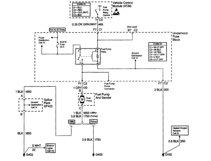

JDL
  • 16,098 POSTS
Welcome to the forum, thanks for the donation. Did you check voltage circuits at the fuel pump relay? Voltage to load side of relay should be hot all the time. Voltage to coil side of relay goes hot for a few seconds, key on, and hot with engine cranking. Voltage to the coil comes from pcm. Can you check for codes?
Monday, February 1st, 2021 AT 10:29 AM (Merged)
RLMK1109
  • 5 POSTS
I have power to one of the 4 fuse entry ports, but after that nothing with the key in the on position.
JDL
  • 16,098 POSTS
https://www.2carpros.com/forum/automotive_pictures/170934_blazer_fuel_pump_1.jpg
The green wire with the white tracer is voltage for coil side of relay, hot for a few seconds when you you turn key on, no crank. Engine cranking, should be hot all the time. If nothing there, take circuit loose at both ends, check for continuity, if no continuity, replace wire. If continuity ok, check for pin voltage for that wiring circuit at the pcm. It may not be 12 volts, it maybe 5 or 6? If no voltage when there should be, you need to check the pcm.
