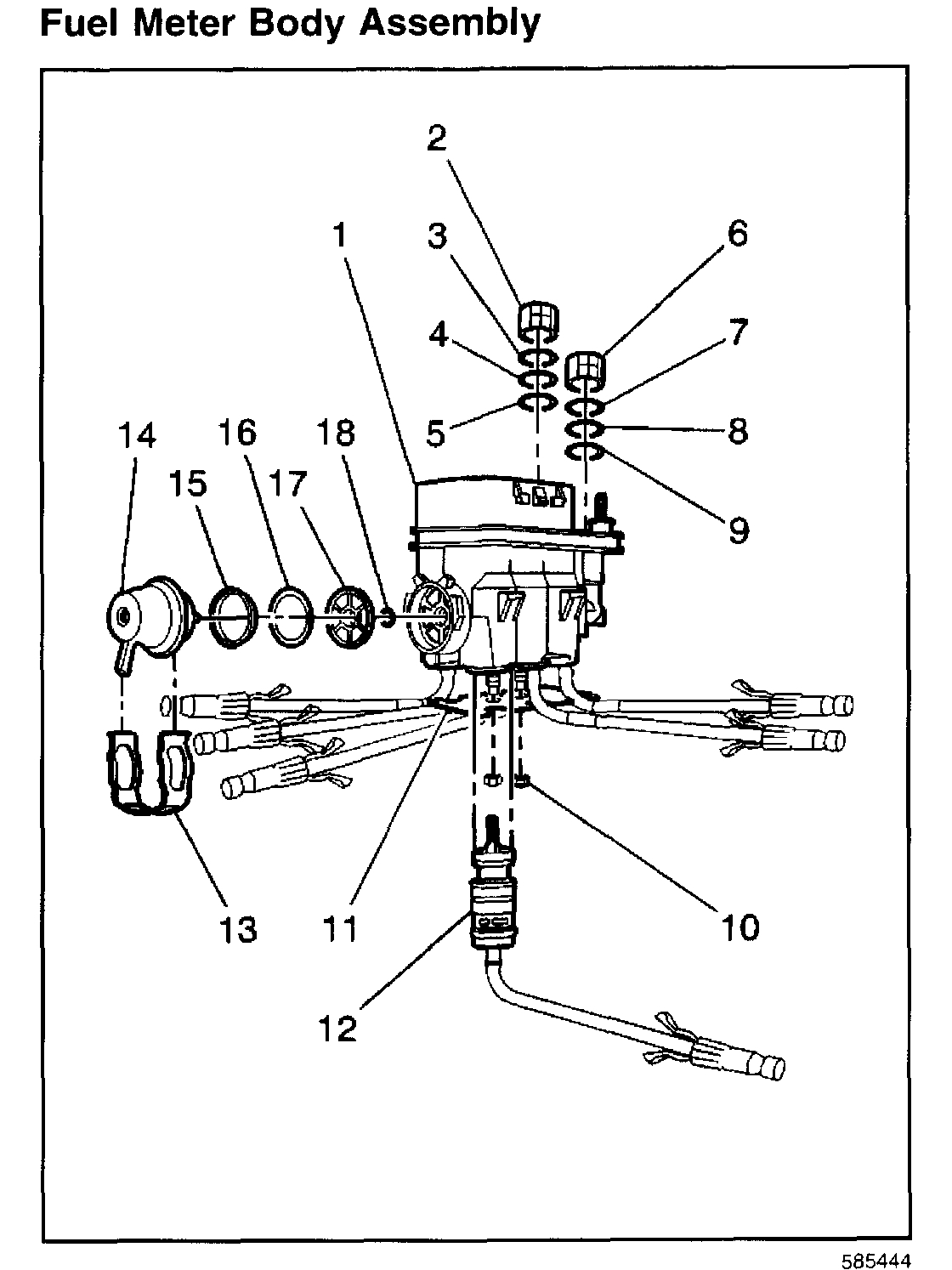

My son just purchased this vehicle. We have replaced the fuel pump, filter, the spider injectors, the MAF sensor, idle control sensor, put new plugs and wires and new distributor cap and rotor. It is only reading 40 psi idles rough and eventually stalls. What can be wrong?
Jan 24, 2020 at 7:32 AM
  • 110,248 POSTS

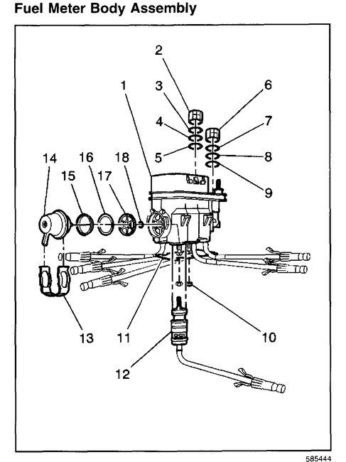

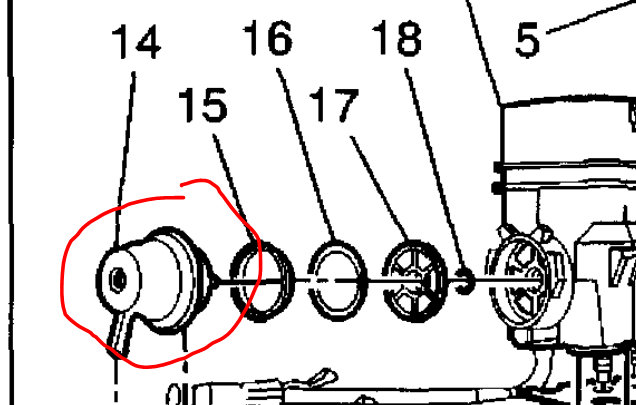

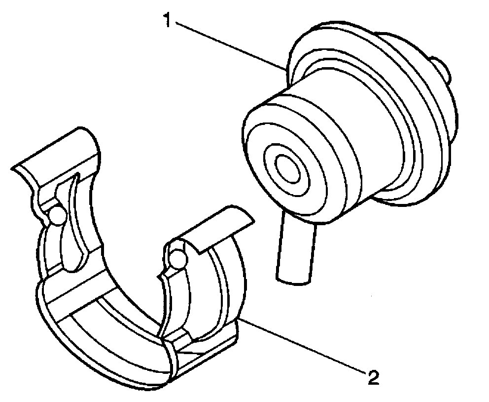

The pressure is low. Have you checked the fuel pressure regulator? It is mounted on the fuel meter body assembly. The regulator may be the cause. It will have an engine vacuum hose going to it. First, remove the hose and confirm there is no fuel in it. If there is, replace the regulator. If there isn't, reconnect the pressure gauge and start the engine. Disconnect the vacuum hose from the regulator and the pressure should increase. If it doesn't, replace the regulator.
The first two pics below show what the regulator looks like and location.
Here are the directions for replacement. Pic 3 correlates with the directions.

FUEL PRESSURE REGULATOR REPLACEMENT
Fuel Meter Body Assembly

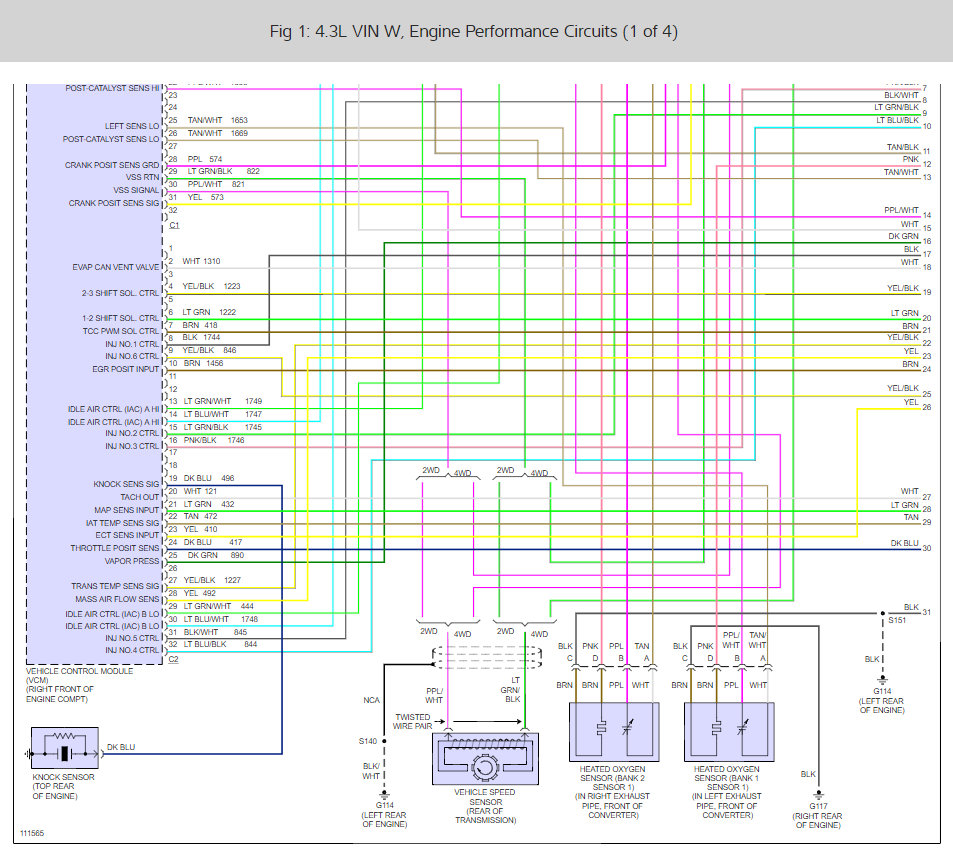

Pic 3
REMOVAL PROCEDURE
TOOL REQUIRED
J 34730-1A Fuel Pressure Gauge
CAUTION: Refer to Battery Disconnect Caution In Service Precautions.
1. Disconnect the negative battery cable.
2. Relieve the fuel system pressure. Refer to Fuel Pressure Relief Procedure.
3. Remove the upper intake manifold assembly.
4. Remove the fuel pressure regulator retainer clip (13).
5. Pull and twist the fuel pressure regulator (14) in order to remove the fuel pressure regulator from the fuel pressure regulator housing using a shop towel to catch any spilled fuel.
6. Remove the regulator seal lower O-ring (18).
7. Remove the regulator assembly filter (17).
8. Remove the regulator seal upper O-ring (16).
9. Remove the regulator seal backup ring (15).
10. Cover the fuel pressure regulator housing to prevent contamination from entering the fuel system.
11. Discard the O-rings.
INSTALLATION PROCEDURE
IMPORTANT: If the fuel pressure regulator is to be reinstalled, inspect the filter screen for contamination. If the filter screen is contaminated, replace the regulator.
1. Lubricate the new O-rings with clean engine oil.
2. Install the regulator seal backup ring (15).
3. Install the regulator seal upper O-ring (16).
4. Install the regulator assembly filter (17).
5. Install the regulator seal lower O-ring (18).
6. Assemble the regulator with the vacuum tube pointing down into the regulator retainer clip.
7. Install the fuel pressure regulator retainer clip (13).
8. Install the upper manifold assembly.
9. Tighten the fuel filler cap.
10. Connect the negative battery cable.
11. Inspect for leaks.
11.1.Turn the ignition switch ON for 2 seconds.
11.2.Turn the ignition switch OFF for 10 seconds.
11.3.Turn the ignition switch ON.
11.4.Inspect for fuel leaks.

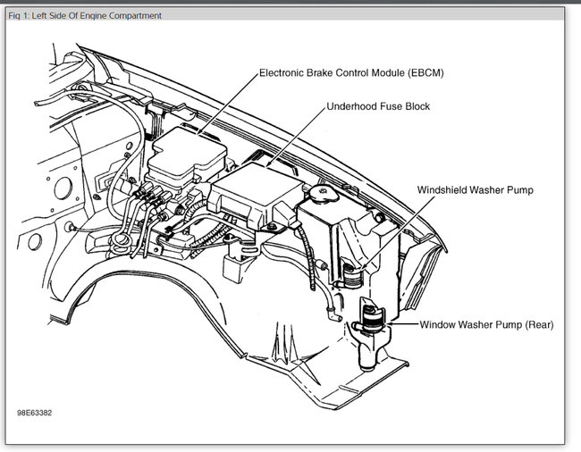

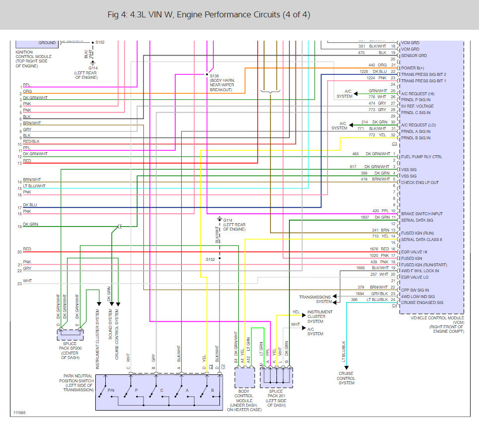

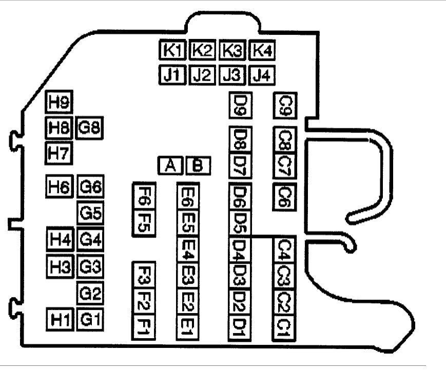

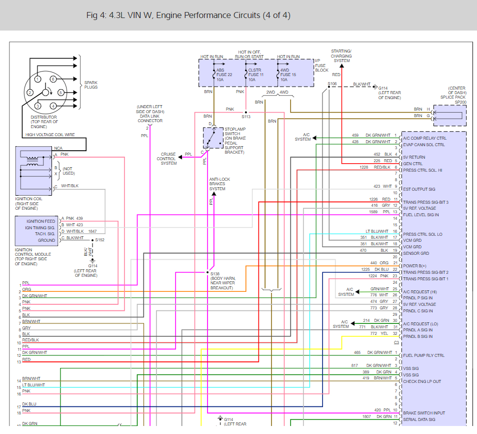

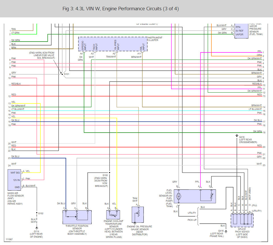

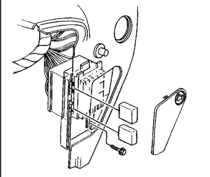

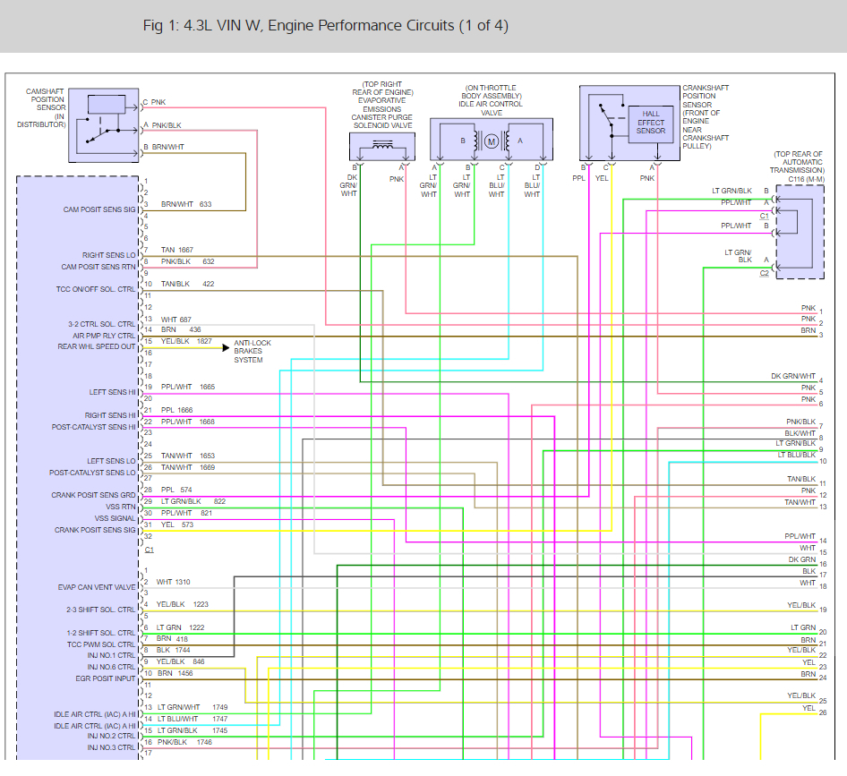

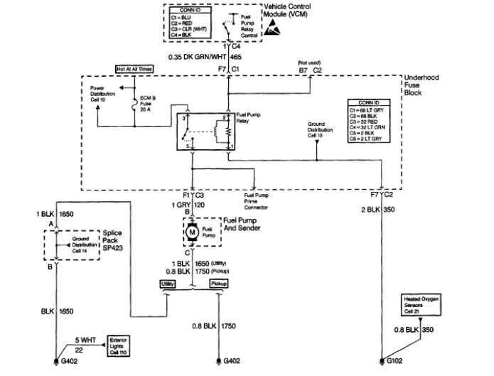

Do you hear the fuel pump come on when key is at run position? If not check the ECM control relay circuit. Have you checked the fuel pump fuse?

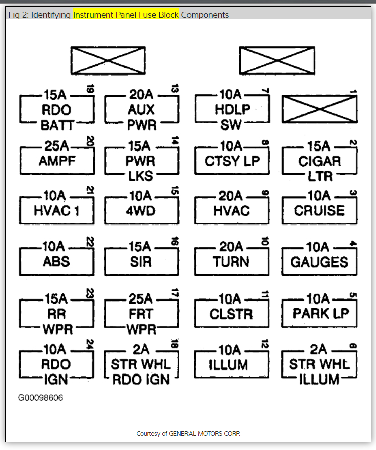

Here are some fuel pump wiring diagrams and a guide to help us get started fixing the problem.
and
There is a year split on the location of the relay so I gave you both.

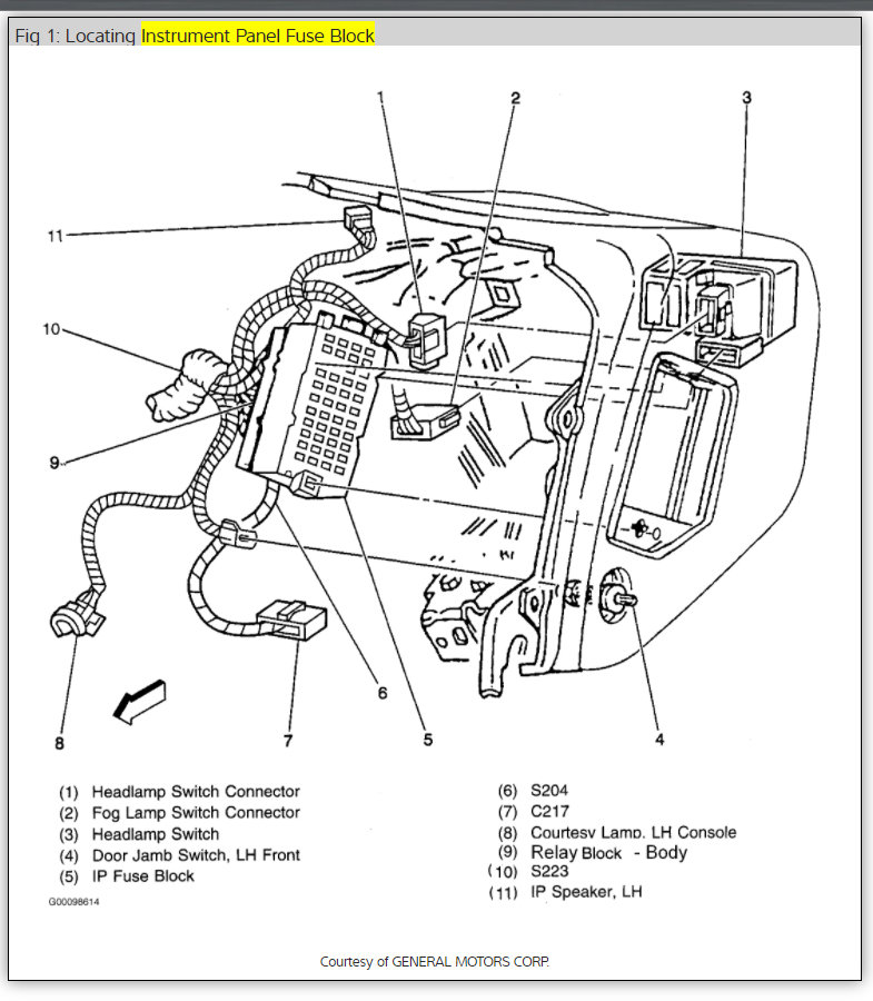

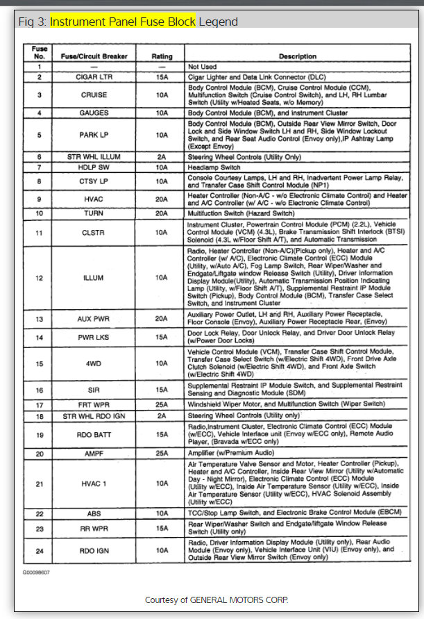

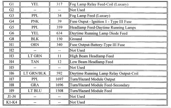

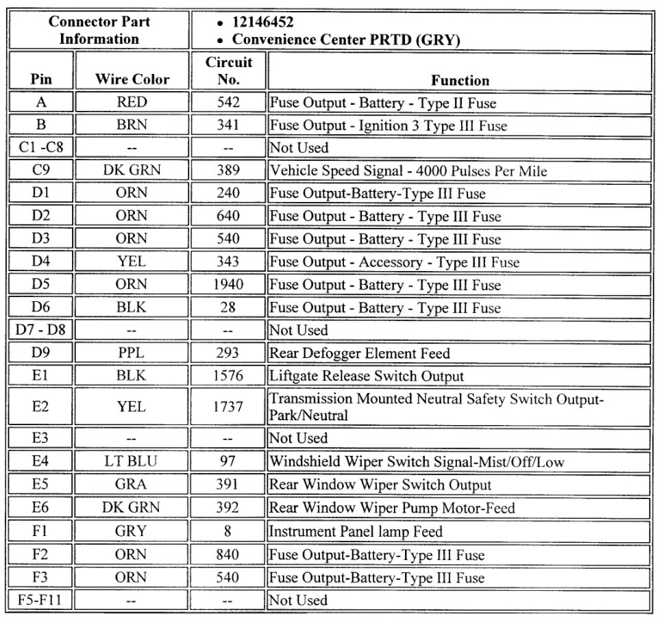

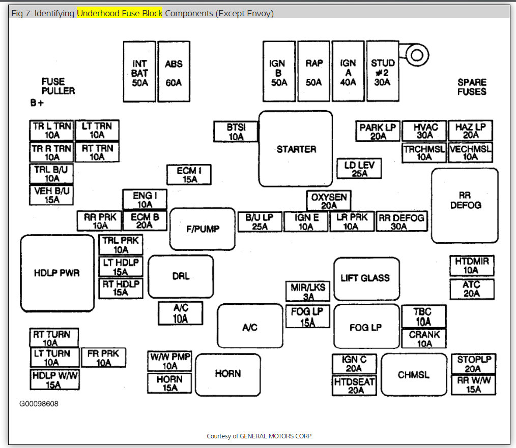

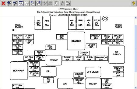

I did not see anything labelled as a fuel pump fuse, only the relay. I have checked all fuses in the engine compartment are there fuses anywhere else? The fuel pump does not come on when key in the on position. No juice getting to connector at fuel tank. All fuses are good ECM circuit is good. No power at fuel pump test connector(ALCL connector terminal G).
Feb 1, 2021 at 2:25 AM (Merged)
  • 75,988 POSTS
All you got is 2secs to look for power-Be at the fuel pump connector and hook up the voltmeter and have helper turn key to On-do you have power? If not track it back thru the wires and the fuel pump relay. See fuel pump relay below
https://images.2carpros.com/forum/automotive_pictures/12900_fuse_pump_fuse_1.jpg
BETTER IMAGE ABOVE
CBOLLINGER48818

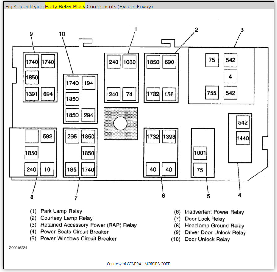

What you are showing me is the diagram of the fuse block.
The one that is labelled fuel pump is a relay (right?).
I am told there is also a relay up by the firewall on the right side of vehicle.
If this is true I have power going to this relay.
Which one is actually the fuel relay ?
If I look up fuel relay on parts stores web sites it shows me the 4 pin that is in the fuse box on left side of engine compartment.
  • 75,988 POSTS
It is the one in the under hood fuse/relay block.

Before I forget, there is a common problem you should be aware of if you have a steel gas tank. The pump is grounded through it to the straps, then to the frame. If the tank gets rusty, that ground can be lost. You'll have that 12 volts on the feed wire, but a faster way to check for this problem is to use a simple test light. Ground it to a good, paint and rust-free point on the body, then place the probe right on the tank. If the test light turns on dimly, drill a small hole in the tank's flange, outside of the weld, then run a screw in there and attach a wire to it and to the frame.
At the pump's connector, you should have been testing on the gray wire for 12 volts. You should normally see 12 volts for one or two seconds after turning on the ignition switch, then again when you're cranking the engine. If you DO see 12 volts for the first couple of seconds, we know the relay and wiring are okay, and the Engine Computer has control of that relay.
If you don't see that initial 12 volts, we're going to have to test at the relay. Either you're going to have to gain access to the underside of the fuse / relay block, or you must find a way to test on the relay's terminals while it's still plugged in. You might be able to lift the relay just enough so you can poke the test light's probe in there, or you can insert little pieces of wire to use as test points. You have to be careful though to not put enough pressure on the terminals in the socket that they become stretched. That will cause them to make intermittent contact.
To start with, you can remove the relay completely, then test at each terminal with the test light. There should be one with 12 volts all the time. If you're doing this underneath, that will be on the orange wire.
Next, move the test light's ground clip to the battery's positive post so we can test for grounds. Probe the remaining three terminals in the relay socket. One will make a bright test light. That's the ground wire for the relay and is black. Now look for a second terminal like that. That is a green / white wire. The test light should light up but it will be relatively dim because you're also reading to ground through the pump motor.
If those three circuits are okay, we have to determine why the computer isn't turning the relay on.

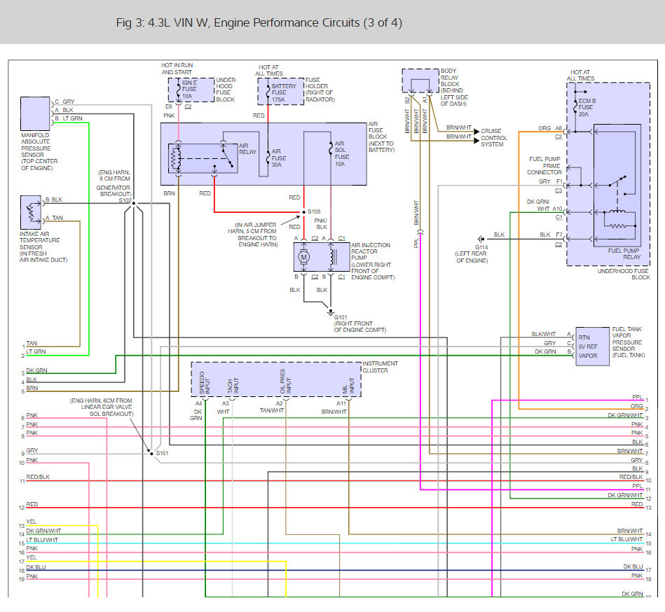

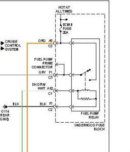

Did you check for power at the pump? Wire diagram attached.
Feb 1, 2021 at 2:29 AM (Merged)
ZOOMER55
There is no power at the fuel pump all the fuses are good. When the key is on there is power to three of the legs on the relay. There has been a couple of times when there was power back at the pump but only a few times. Tried adding a ground but that didnt help.Was wondering if the ecm may not be sending signal to the fuel pump?Kind of at a loss on this one.
thanks in advanced for your help

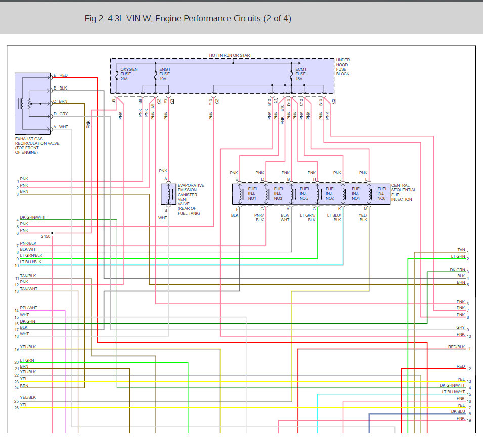

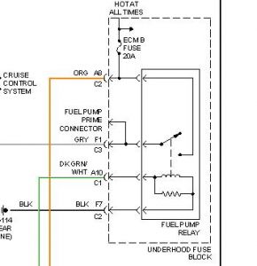

from relay orange wire/relay pin A6/C2 is HOT all times to PCM 12volts grey wire/relay pin F1/C3 is feed to pump dark green white wire/relay pin A10/C1 is fuel pump control signal from PCM which would then put power to grey wire/relay pin F1/C3 black wire/relay pin F7/C2 is ground could you tell me what color wires you have at the pump ... my diagram is showing.. grey .. relay feed wire, hot @ key on for 2 seconds then hot @ cranking and hot @ engine running .. then 2 black wires which are grounds .. and a purple wire going to the PCM which is fuel level signal .. if you are hot @ the relay you must have a break/short in the wire between relay and pump .. let me know ..
https://images.2carpros.com/forum/automotive_pictures/266999_fuel_8.jpg

https://images.2carpros.com/forum/automotive_pictures/170934_blazer_fuel_pump_1.jpg
The green wire with the white tracer is voltage for coil side of relay, hot for a few seconds when you you turn key on, no crank. Engine cranking, should be hot all the time. If nothing there, take circuit loose at both ends, check for continuity, if no continuity, replace wire. If continuity ok, check for pin voltage for that wiring circuit at the pcm. It may not be 12 volts, it maybe 5 or 6? If no voltage when there should be, you need to check the pcm.
