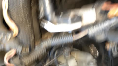

The shop that she was at before I had her towed home said they did a pressure test. They stated that the pressure was at 60 (which is where it should be they said.) Then when it then dropped to zero and would stall out. Their diagnosis was fuel pressure regulator. That was replaced but was not the issue of the knocking or running rough.

I did remove the spark plug wires from each cylinder while she was running. The sound did not go away. It sounded different today though. Kind of sounds like lifter ticking.

I showed the video to a mechanic friend. He says its knocking from the bottom. I'm going to assume it's the rod that comes up from the bottom of the engine. Which makes me think the engine is toast.

It turns out it was a bottom end rod knock. So I sold her to a guy who's going to drop in a V8 engine.
