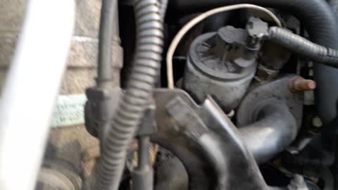

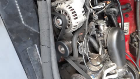

Loud spark knock engine running so bad the whole truck shakes
1999 CHEVROLET S-10
288,000 MILES • 4.3L • V6 • 2WD • AUTOMATIC
NEPHALIMTEARS
  • 26 POSTS
I was driving home suddenly the truck didnt want to go past 55. Loss of power, random misfirmes, shaking, sputtering, hesitation especially going from a stop.
I took her to the mechanic. He said my fuel pressure would hit zero. Said it was the regulator. I had it changed. Still has the same issues.
My scan tool said EGR failure. It doesn't have a code.
Could this cause the issues im having?

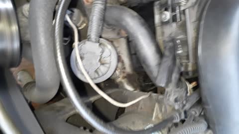

The mechanic who did the regulator said it sounded to him like a spark knock. For a while i did drive it with bad O2 sensors (replaced them 3 times each time they did not register the forth time they finally got a signal then 2 days later this happened.)
Currently the battery is drained or i would do it.

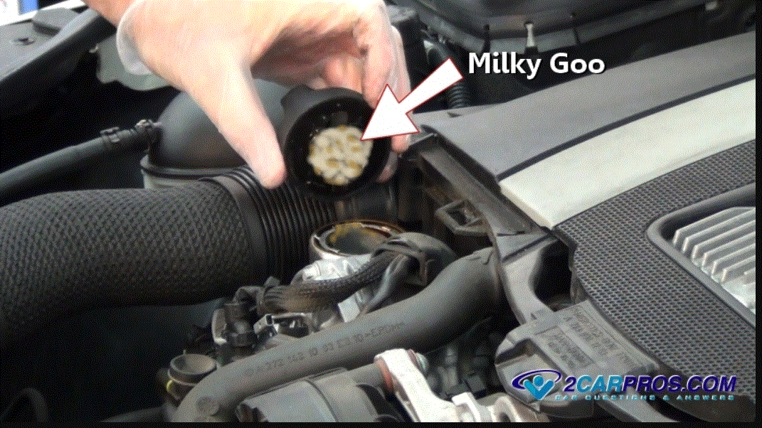

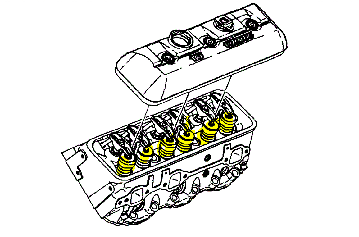

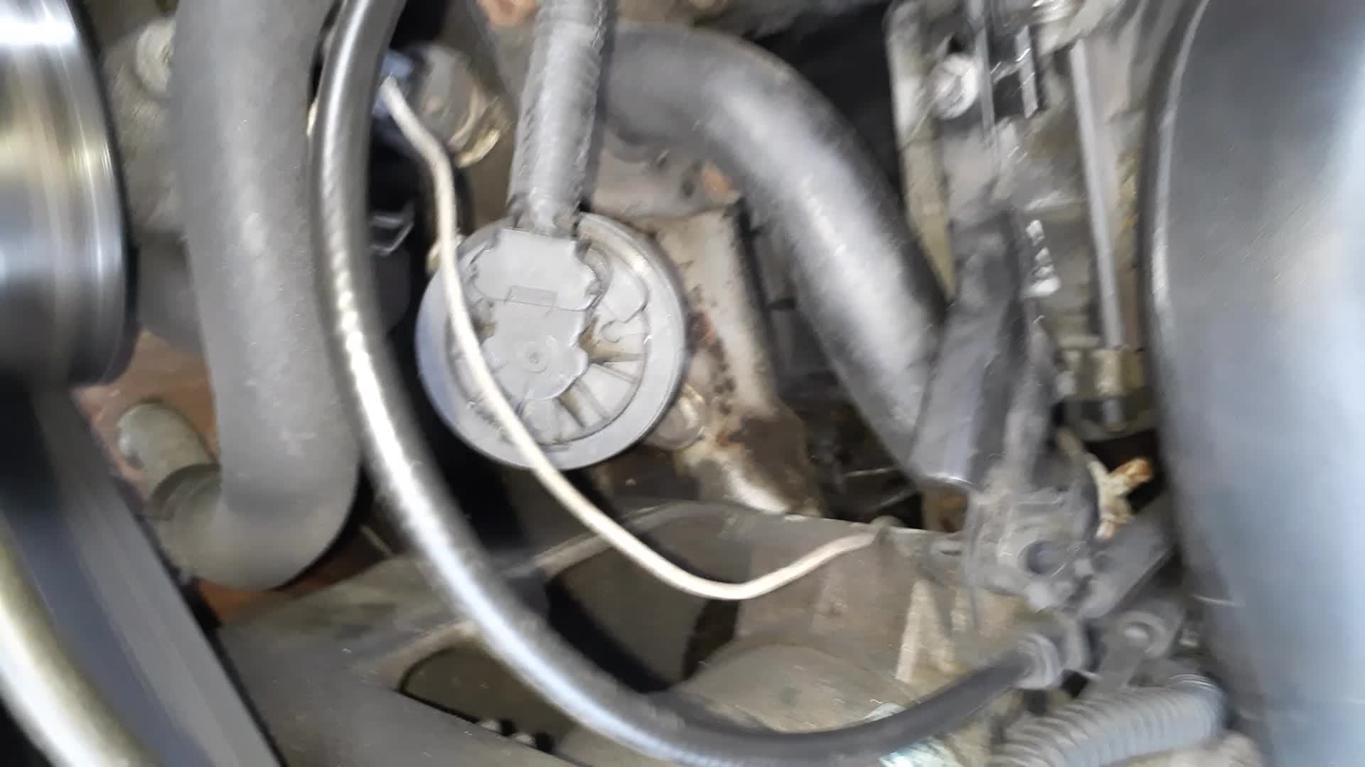

Did the smoke come from under the hood or the exhaust? Also, take a look at the attached pic. Do you see anything like that mixed with the oil?
Feb 4, 2021 at 9:53 AM
NEPHALIMTEARS
  • 26 POSTS
It comes from under the hood. No creamer looking goop. It just looks like slightly used oil. Oil change was due in about 1,000 miles. I use 5w30 full synthetic.
Radiator has antifreeze in it. Nothing milky in it either.
Once the regulator was changed it smoked again but this time it was due to the coolant hose being removed and leaking slightly on the engine block.

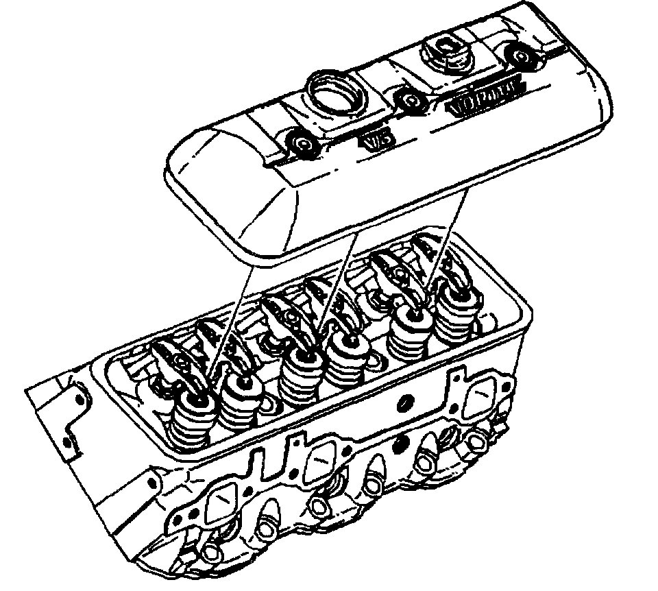

I just sent this to the site owner. He feels it could be a broken valve spring or even a flat spot on the cam. Let's do this. Let's remove the valve covers and check for a broken spring.
Here are the directions for both sides. Remove them and see if there are any broken springs. The attached pics correlate with the directions.

Valve Rocker Arm Cover Replacement (Right)
Vehicle Engine, Cooling and Exhaust Engine Cylinder Head Assembly Valve Cover Service and Repair Procedures Valve Rocker Arm Cover Replacement (Right)
VALVE ROCKER ARM COVER REPLACEMENT (RIGHT)
Removal Procedure

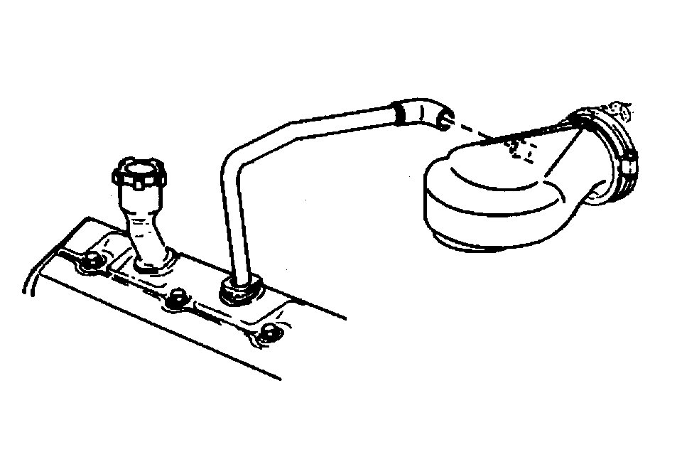

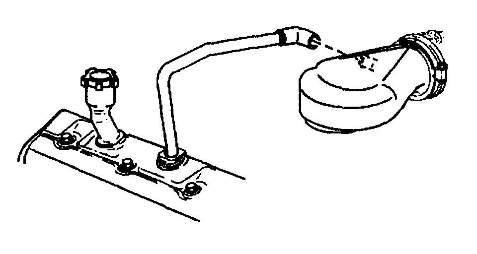

pic 1

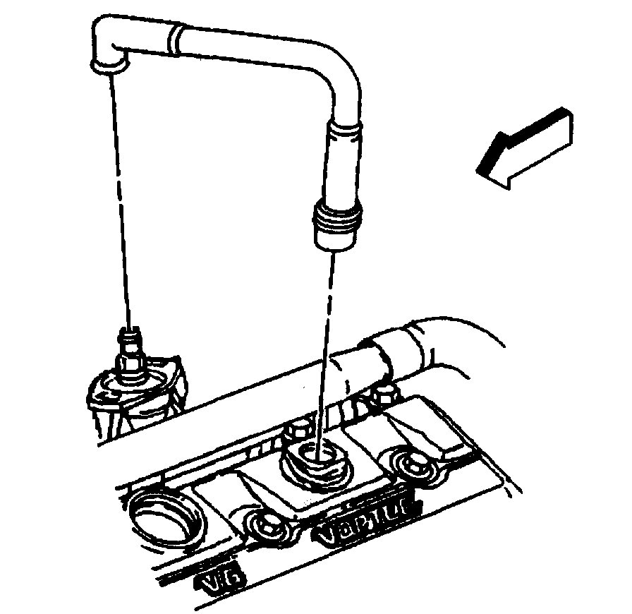

1. Remove the PCV tube from the air cleaner outlet duct and the valve rocker arm cover.
2. Disconnect the spark plug wires from the spark plugs for the right side of the engine. Refer to Spark Plug Wire Harness Replacement in Powertrain Management.
3. Remove the EVAP canister purge solenoid valve. Refer to EVAP Canister Purge Solenoid Valve Replacement in Powertrain Management.
4. Unfasten the heater hose retainer above the valve rocker arm cover.
5. Move and secure the heater hoses aside.

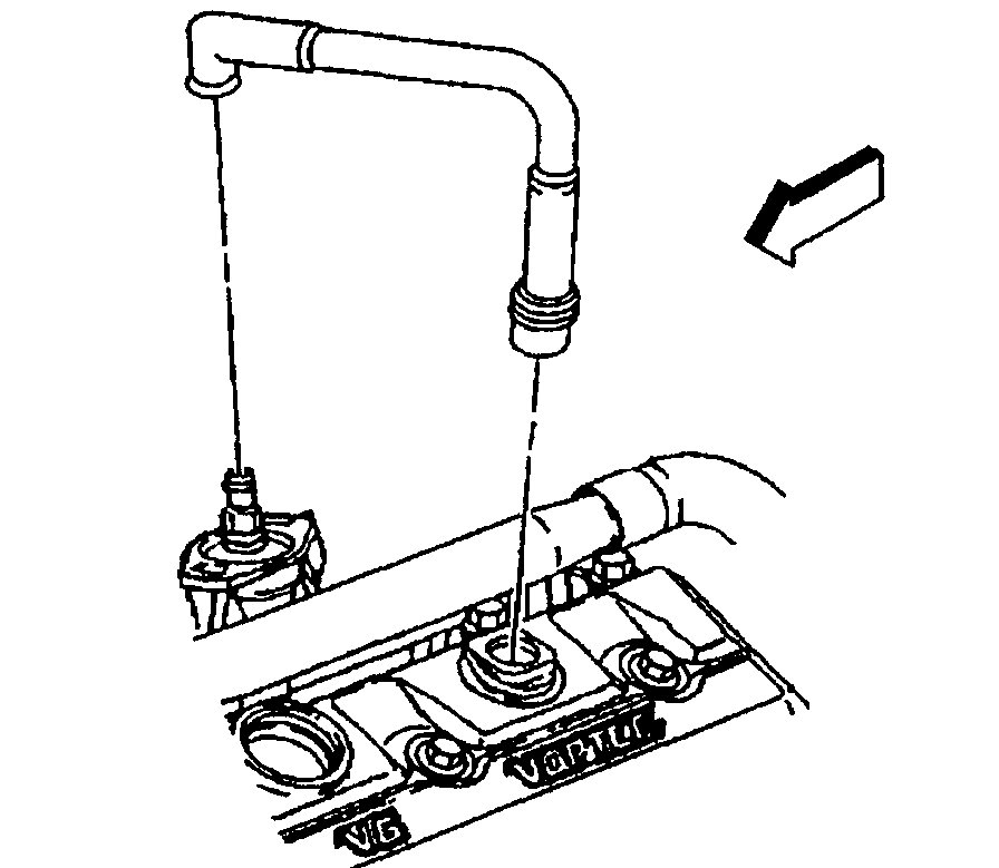

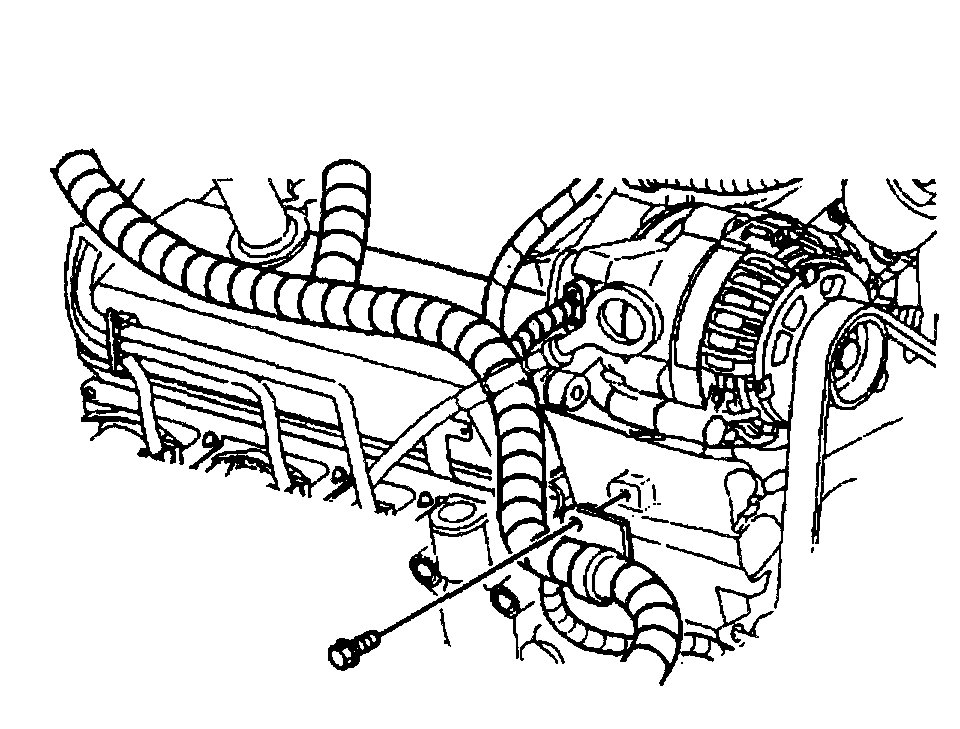

pic 2

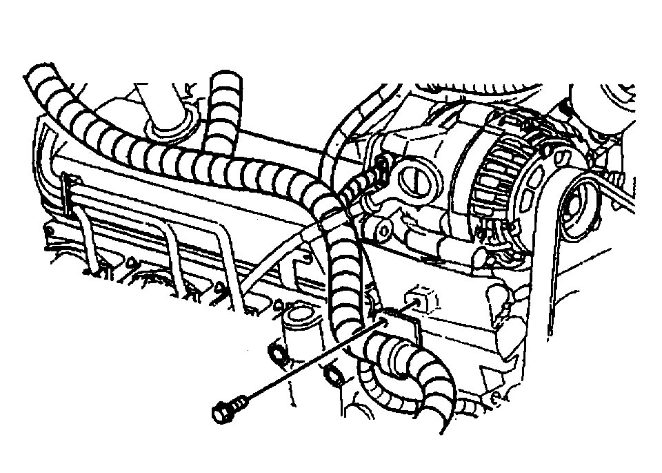

6. Remove the bolt holding the engine wiring harness bracket to the generator.
7. Disconnect the Crankcase Position (CKP) sensor electrical connector.
8. Move and secure the engine wiring harness aside.

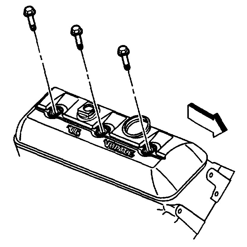

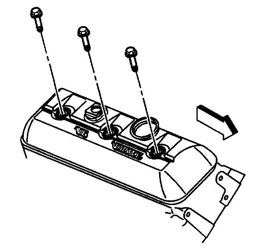

pic 3
9. Remove the bolts and the right valve rocker arm cover.
10. Clean all sealing surfaces. Refer to Valve Rocker Arm Cover Clean and Inspect

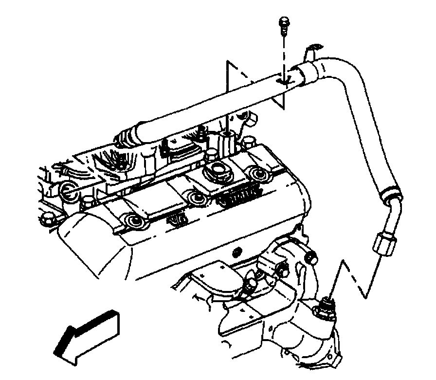

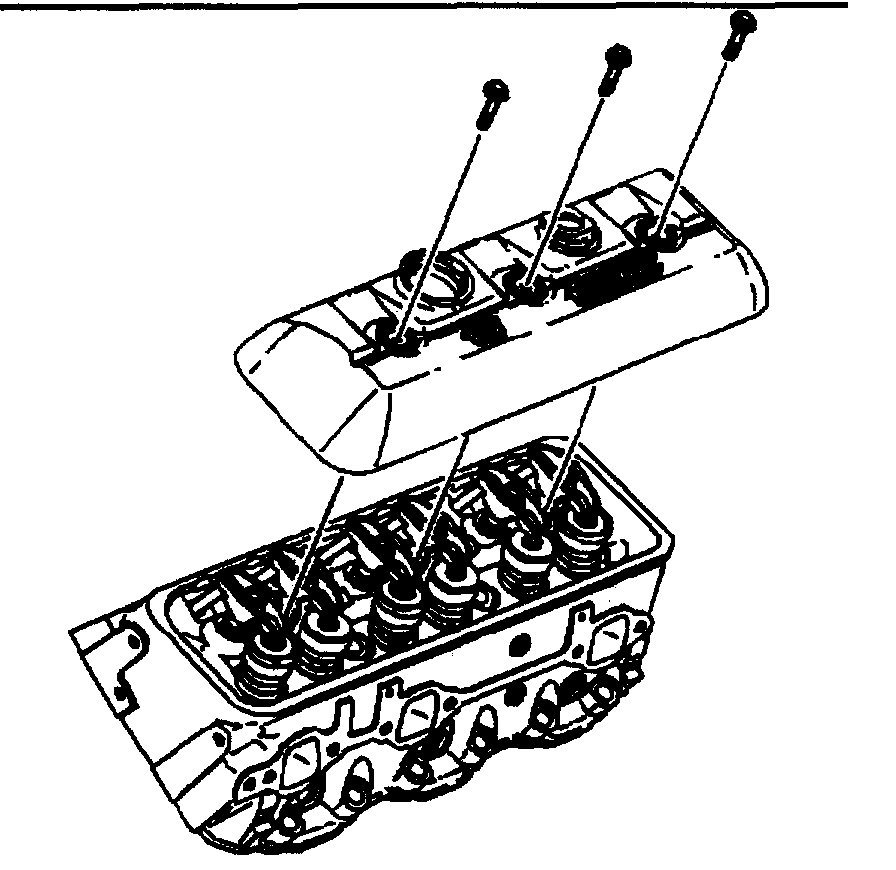

pic 5
2. Position the engine wiring harness.
3. Connect the CKP sensor electrical connector.
Notice: Refer to Fastener Notice in Service Precautions.
4. Install the engine wiring harness and bolt to the generator mounting bracket.
^ Tighten the engine wiring harness bolt to 25 Nm (18 ft. lbs.).
5. Position the heater hoses.
6. Install the heater hoses in the retainer above the valve rocker arm cover.

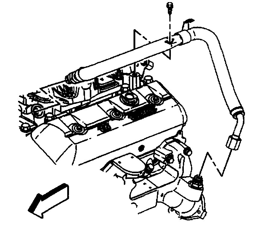

7. Install the EVAP canister purge solenoid valve. Refer to EVAP Canister Purge Solenoid Valve Replacement in Powertrain Management.

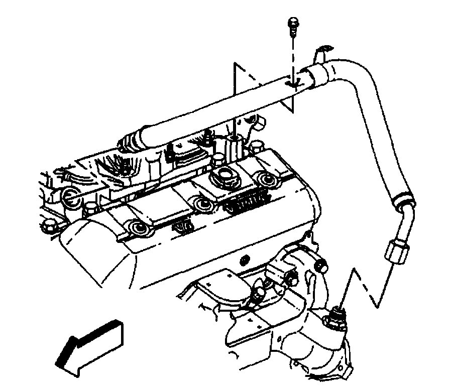

pic 6
8. Connect the spark plug wires to the spark plugs for the right side of the engine. Refer to Spark Plug Wire Harness Replacement in Powertrain Management.
9. Install the PCV tube to the air cleaner outlet duct and the valve rocker arm cover.

If you look at the last pic, I highlighted the valve springs.
Also, I would suggest checking engine compression. That can tell us a lot as well. Here is a link showing how that is done.
____________________________________
One last check. Once the valve covers are off, have a helper crank the engine while you make sure all of the valves are moving up and down. If they are, great. If you find one that isn't, that would likely mean one of the lobes is worn on the camshaft.

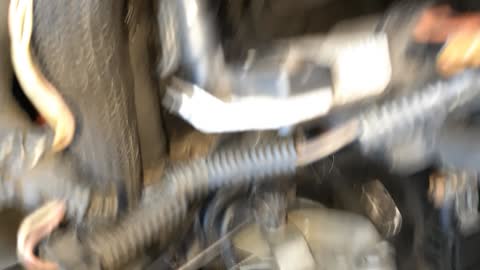

The longer it went the worse it started to sound. I have a second video of where the sound is coming from. It sounds like it's coming from the right side of the engine if you are facing it.

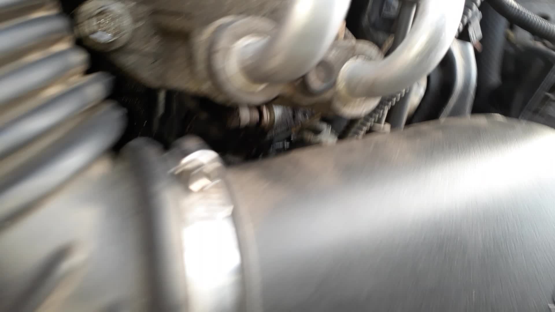

Second video with the area i think the sound is coming from.

there is only a light ticking now and when i rev the engine the ticking gets faster and when the engine slows down it stops. Why/how it went from being super loud ticking to a milder ticking after the scan tool was hooked up i don't. Maybe just a fluke. She did start to sputter (all while idling) and did shut off once with a few almost shutting off to until the PCM changed the timing because it did speed back up.
I drove it like 20 feet to a better parking spot. All sounds went away when she was in reverse.
All 4 of these videos were taken in a 30 minute period.

Listening to that video, it does sound like it is a valve spring. Have you removed the valve covers yet? It does sound like it's from the top end.

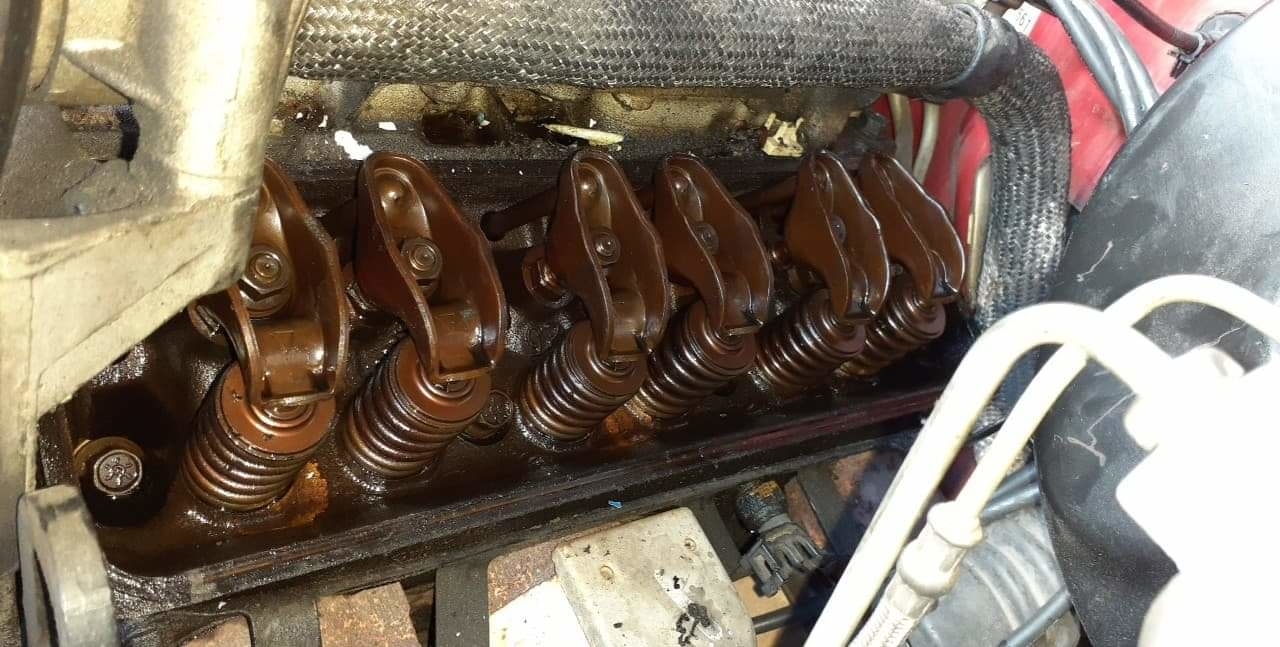

Well, i didn't see your message until i tore her apart. No broken springs on the right side.

I removed the right side. No broken springs. Everything was tight. Next is to remove the left side probably in a couple of days.
