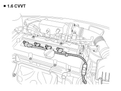

2008 Kia Rio L4-1.6L
Repair Procedures

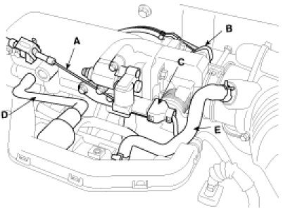

Vehicle Engine, Cooling and Exhaust Engine Intake Manifold Service and Repair Removal and Replacement Repair Procedures
REPAIR PROCEDURES
REMOVAL
1. Remove the engine cover(A).
Pic 1

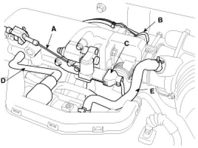

2. Remove the accelerator cable(A).
3. Disconnect the TPS (Throttle Position Sensor) connector (B).
4. Disconnect the ISA(Idle Speed Actuator) connector(B).
5. Disconnect the PCV(Positive Crankcase Ventilation) hose(D) and breather hose(E).
Pic 2

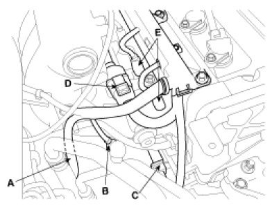

6. Disconnect the injector connector (No. 3, 4) (A).
7. Disconnect the injector connector (No. 1, 2) (B).
Pic 3

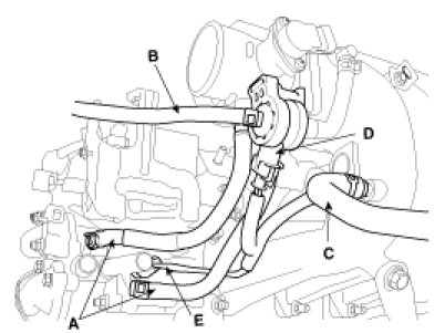

8. Remove the heater hose(A), PCSV(Purge Control Solenoid Valve)(B) and the brake vacuum hose(C) from throttle body and intake manifold.
9. Disconnect the PCSV(Purge Control Solenoid Valve) (D) and water temperature sensor connector(E).
Pic 4

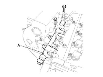

10. Remove the delivery pipe(A).
Tightening torque :
18.6 - 27.5N.M (1.9 - 2.8kgf.M, 13.7 - 20.3lb-ft)

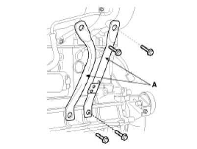

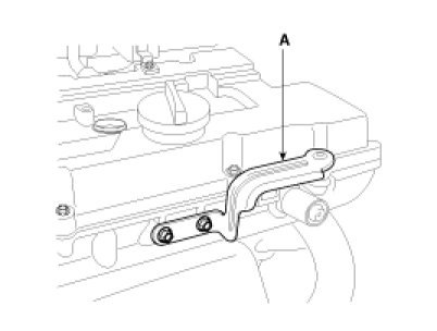

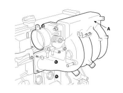

11. Remove the intake manifold stay(A).
Tightening torque :
17.7 - 24.5N.M (1.8 - 2.5kgf.M, 13.0 - 18.1lb-ft)
pic 6
12. Remove the intake manifold.

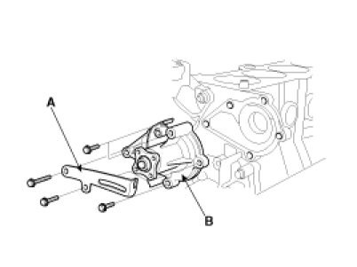

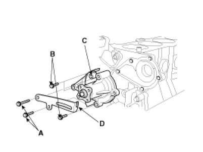

Here are the directions for the pump. This is a bigger job than normal because the pump is run by the timing belt. I will include directions for timing belt removal and replacement last.
_________________________________________________
Repair Procedures
Vehicle Engine, Cooling and Exhaust Engine Water Pump Service and Repair Removal and Replacement Repair Procedures
REPAIR PROCEDURES
REMOVAL
WATER PUMP
1. Drain the engine coolant.
WARNING:
System is under high pressure when the engine is hot.
To avoid danger of releasing scalding engine coolant, remove the cap only when the engine is cool.

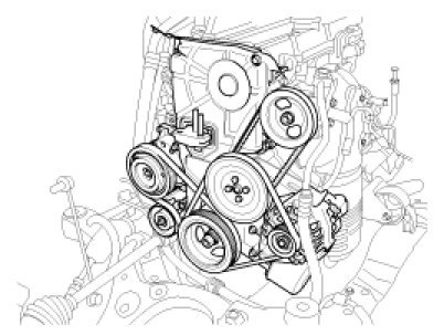

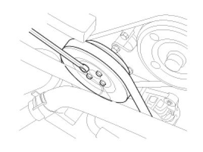

2. Loosen the water pump pulley bolts.
3. Remove the drive belts.
Pic 8
4. Remove the water pump pulley.
5. Remove the timing belt.
6. Remove the timing belt idler.
7. Remove the water pump.
(1)Remove the 2 bolts and alternator brace(A).
(2)Remove the 3 bolts and remove the water pump(B) and gasket.
Pic 9

1. Install the water pump.
(1)Install the water pump(C) and a new gasket with the 3 bolts(B).
Tightening torque :
11.8 - 14.7 N.M (1.2 - 1.5 kgf.M, 8.7 - 10.8 lb-ft)
pic 10
(2)Install the alternator brace(D) with the 2 bolts(A).
Tightening torque :
19.6 - 26.5N.M (2.0 - 2.7kgf.M, 14.5 - 19.5lb-ft)

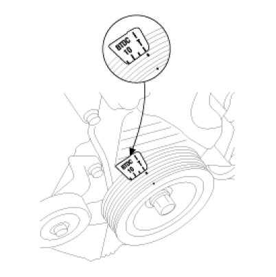

Timing belt
Repair Procedures
Vehicle Engine, Cooling and Exhaust Engine Timing Components Timing Belt Service and Repair Removal and Replacement Repair Procedures
REPAIR PROCEDURES
REMOVAL
Engine removal is not required for this procedure.

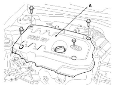

Pic 11

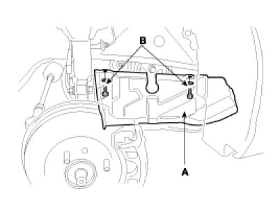

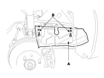

2. Remove the RH front wheel.
3. Remove the 2 bolts(B) and RH side cover(A).
Pic 12
4. Temporarily loosen the water pump pulley bolts.
Pic 13
5. Remove the alternator drive belt(A).
Image 6. Remove the air conditioner compressor drive belt(B).
7. Remove the power steering pump drive belt(C).
8. Remove the 4 bolts and water pump pulley.
9. Remove the 4 bolts(B) and timing belt upper cover(A).
Pic 14

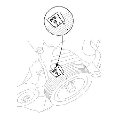

10. Turn the crankshaft pulley, and align its groove with timing mark "T" of the timing belt cover. Check that the timing mark of camshaft sprocket is aligned with the timing mark of cylinder head cover. (No.1 cylinder compression TDC position)
pic 15
pic 16

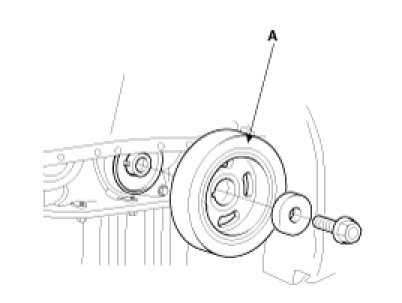

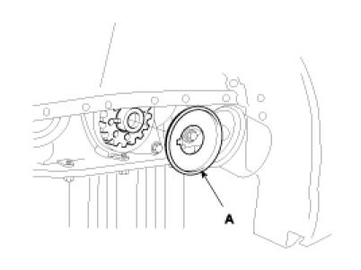

11. Remove the crankshaft pulley bolt and crankshaft pulley(A).
Pic 17
12. Remove the crankshaft flange(A).
Pic 18

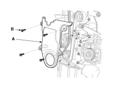

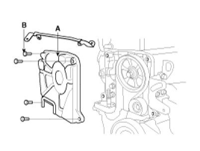

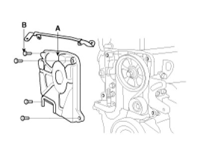

13. Remove the 4 bolts(B) and timing belt lower cover(A).
Pic 20

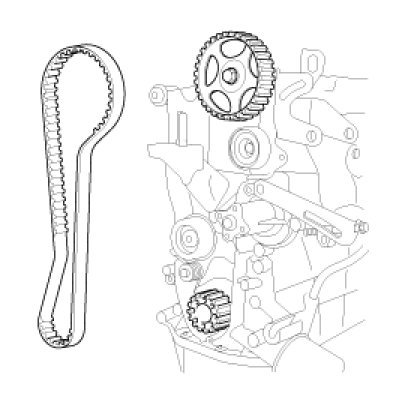

14. Remove the timing belt tensioner(A) and timing belt.
Pic 21
pic 22

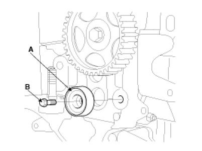

15. Remove the bolt(B) and timing belt idler(A).
Pic 23

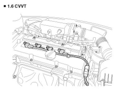

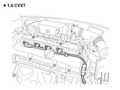

17. Remove the cylinder head cover.

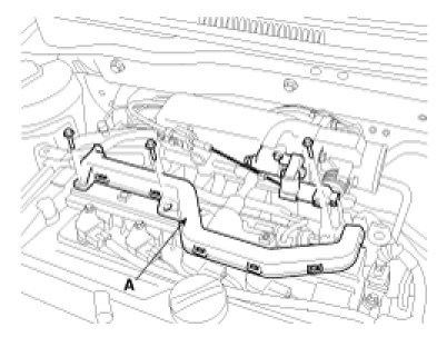

(1)Remove the wire harness bracket(A).
Image (2)Remove the ignition coil.
Pic 25

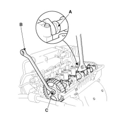

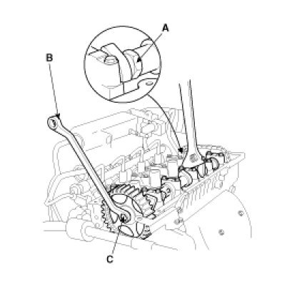

18. Remove the camshaft sprocket.
(1)Hold the portion(A) of the camshaft with a hexagonal wrench, and remove the bolt(C) with a wrench(B) and remove the camshaft sprocket.
Pic 29
CAUTION:
Be careful not to damage the cylinder head and valve lifter with the wrench.

1. Install the camshaft sprocket and tighten the bolt to the specified torque.
(1)Temporarily install the camshaft sprocket bolt(C).
(2)Hold the portion(A) of the camshaft with a hexagonal wrench, and tighten the bolt(C) with a wrench(B).
Tightening torque :
78.5 - 98.1N.M (8.0 - 10.0kgf.M, 57.9 - 72.3lb-ft)
pic 30

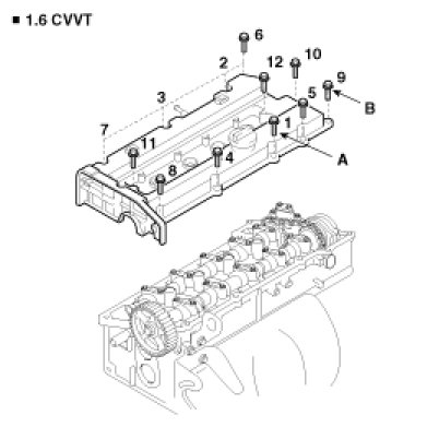

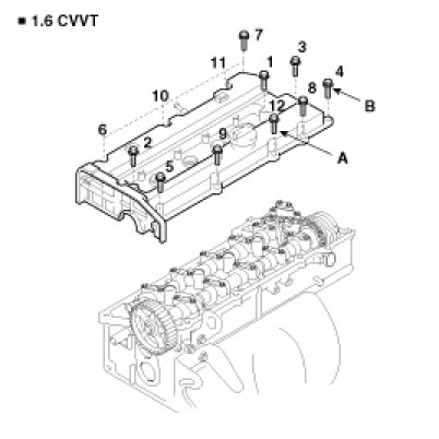

2. Install the cylinder head cover.
(1)Install the cylinder head cover(A) and bolts(B).
Tightening torque :
7.8 - 9.8N.M (0.8 - 1.0kgf.M, 5.8 - 7.2lb-ft)
pic 31

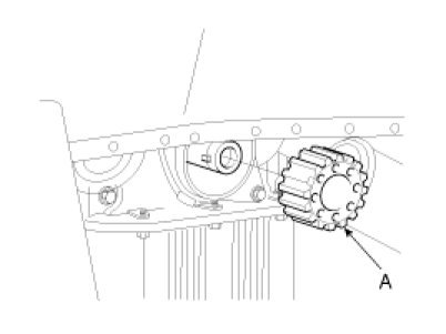

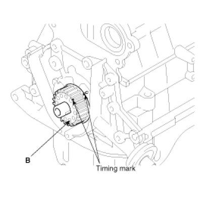

3. Install the crankshaft sprocket(A).
Pic 35

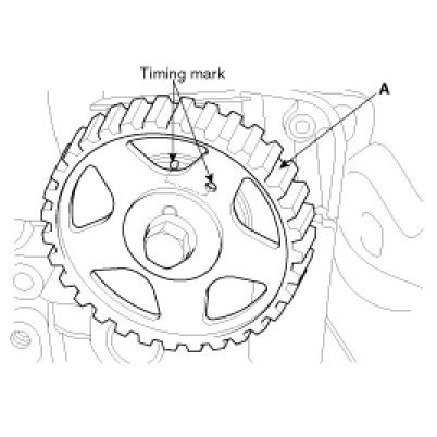

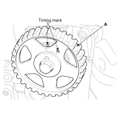

4. Align the timing marks of the camshaft sprocket(A) and crankshaft sprocket(B) with the No.1 piston placed at top dead center and its compression stroke.
Pic 36
pic 37

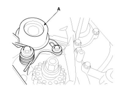

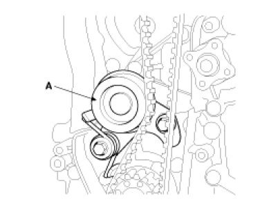

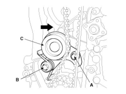

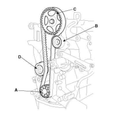

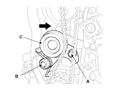

6. Temporarily install the timing belt tensioner(A).
Pic 39
7. Install the belt so as not give slack at each center of shaft. Use the following order when installing timing belt.
Crankshaft sprocket(A) ->idler pulley(B) ->camshaft sprocket(C) ->timing belt tensioner(D).
Pic 40

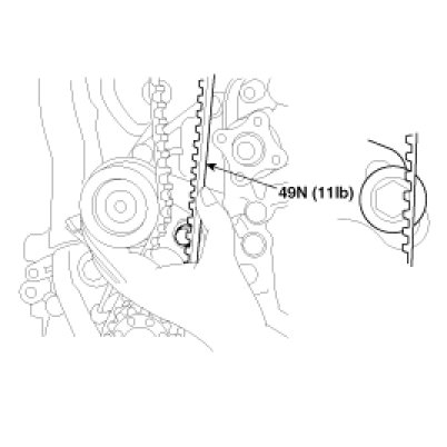

8. Adjust the timing belt tension.
(1)Loosen the tensioner pulley mounting bolt and apply tension to the timing belt.
Pic 41
(2)After checking the alignment between each sprocket and each timing belt tooth, tighten the mounting bolt (A) and (B) one by one.
Tightening torque :
(3)Then recheck the belt tension.
Verify that when the tensioner and the tension side of the timing belt are pushed in horizontally with a moderate force [approx. 49N (11lb)], the timing belt cog end is approx. 1/2 of the tensioner mounting bolt head radius (across flats) away from the bolt head center.
Pic 42

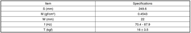

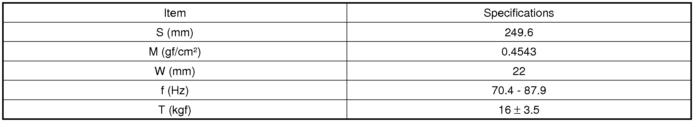

(4)Timing belt tension measuring procedure
(by a sonic tension gauge)
Rotate crankshaft in clockwise direction to set 1st piston on top dead center (TDC) and rotate crankshaft in counterclockwise to 90° then measure the belt tension in the middle of tension side span (in arrow direction of above illustration) by free vibration method.
CAUTION:
Avoid rotating the crankshaft in a counter clockwise direction.
Engine damage could occur.
Conversion equation of frequency into tension :
T = (4 / 9.8) x S2 x M x W x f2 / 100000000
S : Measured belt span (mm)
M : Unit weight of belt (kgf/cm2)
W : Belt width (mm)
f : Transverse natural frequency of belt (Hz)
Timing Belt Specifications
pic 43

11. Install the flange and crankshaft pulley(A), and then tighten crankshaft pulley bolt.
Make sure that crankshaft sprocket pin fits the small hole in the pulley.
Tightening torque :
137.3 - 147.1N.M (14.0 - 15.0kgf.M, 101.3 - 108.5lb-ft)
pic 45

19. Install the engine cover with bolts.
Tightening torque :
3.9 - 5.9N.M (0.4 - 0.6kgf.M, 2.9 - 4.3lb-ft)
pic 49
