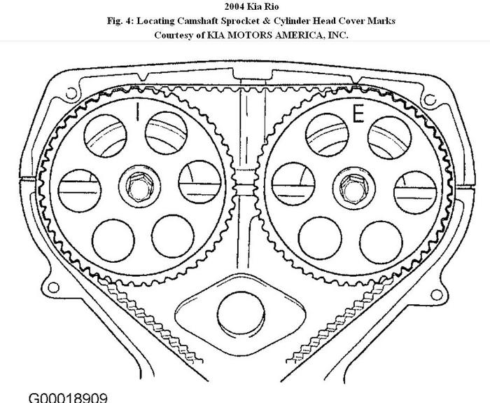

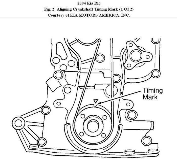

9. Turn crankshaft so that timing mark on timing belt pulley is aligned with timing mark on engine. . .
10. Check that "I" mark on intake camshaft pulley is aligned with mark on seal plate and "E" mark on exhaust camshaft pulley is aligned with mark on seal plate. . .

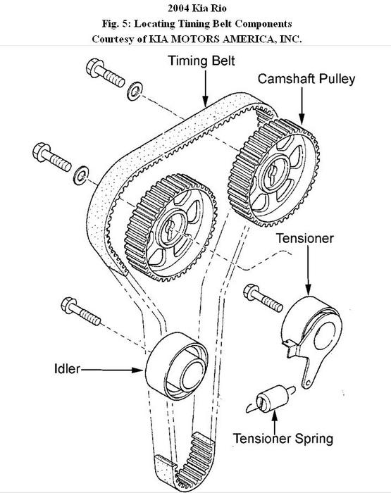

1. Install tensioner pulley. . .
NOTE: Replace tensioner spring whenever timing belt is replaced. . .

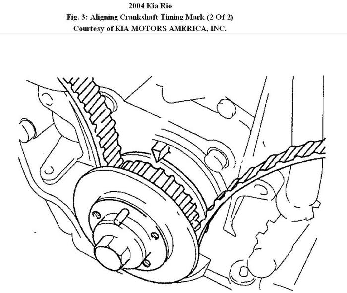

3. ck that timing mark on timing belt pulley is aligned with timing mark on engine. . .
4. Check that "I" mark on intake camshaft pulley is aligned with mark on seal plate and "E" mark on exhaust camshaft pulley is aligned with mark on seal plate. . .

5. Install timing belt onto timing belt pulley first, then idler pulley, exhaust camshaft pulley, intake camshaft pulley, and tensioner pulley in that order. . .
6. Check that there is no looseness in belt between idler pulley and exhaust camshaft pulley or between intake and exhaust camshaft pulleys. . .

9. Rotate crankshaft two full revolutions (clockwise only) and align timing mark on timing belt pulley with timing mark on engine block. . .

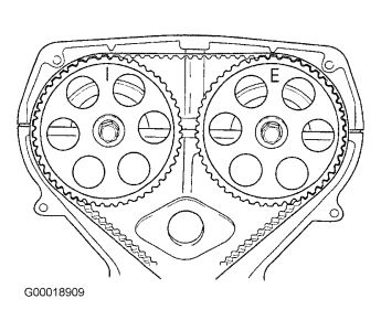

  • 75,992 POSTS
https://images.2carpros.com/forum/automotive_pictures/12900_timingbelt1_1.jpg
Removal 1.Disconnect negative battery cable.
https://images.2carpros.com/forum/automotive_pictures/12900_timingbelt2_1.gif
2.Loosen power steering lock bolts and nuts accordingly and remove tension from power steering (P/S) and/or air conditioning (A/C) compressor drive belt. 3.Remove P/S and/or A/C drive belt. 4.Loosen generator mounting bolts and adjusting bolt. 5.Remove generator bolts. 6.Remove water pump pulley. 7.Remove crankshaft pulley and timing belt guide plate. 8.Remove upper and lower timing belt covers. 9.Turn crankshaft so that timing mark on timing belt pulley is aligned with timing mark on engine.
https://images.2carpros.com/forum/automotive_pictures/12900_timingbelt3_1.gif
10.Check that "l" mark on intake camshaft pulley is aligned with mark on cylinder head cover and "E" mark on exhaust camshaft pulley is aligned with mark on cylinder head cover. Notice : Do not move camshaft or crankshaft once timing marks have been correctly positioned.
https://images.2carpros.com/forum/automotive_pictures/12900_timingbelt4_1.gif
11.Loosen tensioner pulley lock bolt. 12.Protect timing belt with a rag. 13.Remove tensioner pulley. 14.Remove timing belt. Notice: Mark the direction of timing belt rotation (on the timing belt) for proper reinstallation. Inspection Notice: Never forcefully twist, turn inside out or bend timing belt. Do not allow oil or grease to come in contact with timing belt. 1.Replace timing belt if it is contaminated with oil or grease. 2.Check timing belt for uneven wear, fraying, peeling, cracking and hardening. Replace timing belt as necessary.
https://images.2carpros.com/forum/automotive_pictures/12900_timingbelt5_1.gif
3.Bend timing belt into a "U" shape as shown in figure. Distance "A" must be at least 1.0 in (25 mm).
https://images.2carpros.com/forum/automotive_pictures/12900_timingbelt6_1.gif
4.Inspect both idler pulley and tensioner pulley for uneven wear a rid smooth bearing operation.
https://images.2carpros.com/forum/automotive_pictures/12900_timingbelt7_1.gif
5.Inspect camshaft pulleys and timing belt pulley for broken teeth or damage. Notice : Replace any component that shows damage, excessive wear, or that appears prone to a possible failure. Installation 1.Install tensioner pulley. Notice : Replace tensioner spring whenever timing belt is replaced.
https://images.2carpros.com/forum/automotive_pictures/12900_timingbelt8_1.gif
2.Pull tensioner pulley to its furthest point and tighten lock bolt. 3.Check that timing mark on timing belt pulley is aligned with timing mark on engine.
https://images.2carpros.com/forum/automotive_pictures/12900_timingbelt9_1.gif
4.Check that "I" mark on intake camshaft pulley is aligned with mark on cylinder head cover and "E" mark on exhaust camshaft pulley is aligned with mark on cylinder head cover. Notice : If existing timing belt is being reused, install belt in proper rotation direction marked prior to removal. 5.Install timing belt onto timing belt pulley first, then idler pulley, exhaust camshaft pulley, intake camshaft pulley, and tensioner pulley in that order. 6.Check that there is no looseness in belt between idler pulley and exhaust camshaft pulley or between intake and exhaust camshaft pulleys. 7.Loosen tensioner pulley lock bolt and allow tensioner spring to apply tension to timing belt. Notice: Do not add additional tension. 8.Tighten tensioner pulley lock bolt to specified torque. Tightening torque: 28 - 38 ft. lbs. (38 - 51 Nm, 3.9 - 5.2 kg-m) 9.Rotate crankshaft two full revolutions (clockwise only) and align timing mark on timing belt pulley with timing mark on engine block. 10.Check that "I" mark on intake camshaft pulley "E" mark on exhaust camshaft pulley are aligned with marks on cylinder head cover. 11.If they are not aligned, remove timing belt and start process from tensioner installation. 12.Measure timing belt deflection by applying moderate pressure midway between camshaft pulleys. If deflection is not correct, repeat from tensioner installation. Deflection pressure: 22 lb. (98 N, 10 kg) Deflection: 0.39 - 0.50 inch (11 - 13 mm) 13.Install lower and upper timing belt covers in that order. Tightening torque: 70 - 96 ft. lbs. (7.9 - 10.7 Nm, 0.8 - 1.1 kg-m) 14.Install timing belt guide plate and crankshaft pulley. Tightening torque: 9.0 - 12.6 ft. lbs. (12.3 - 17.2 Nm, 1.3 - 1.8 kg-m) 15.Install water pump pulley. Tightening torque: 9.0 - 12.6 ft. lbs. (12.3 - 17.2 Nm, 1.3-1.8 kg-m)
https://images.2carpros.com/forum/automotive_pictures/12900_timingbelt10_1.gif
16.Install generator belt and adjust the tension. 17.Install P/S and/or A/C drive belt and adjust the tension. 18.Connect negative battery cable.

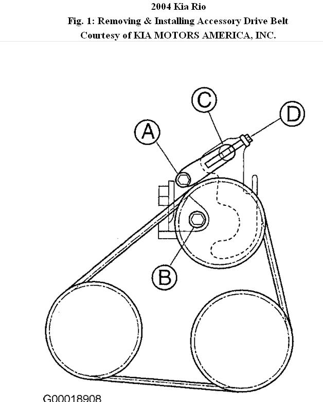

FAMMECH
Has anyone actual done this because the instructions don't say how to remove harmonic balancer

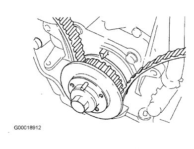

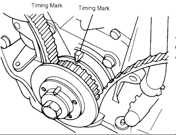

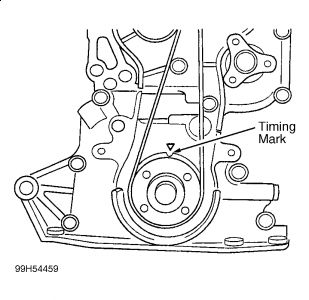

I am looking the timing marks for t.d.c.
Mar 30, 2019 at 8:01 AM (Merged)
BLUELIGHTNIN6
  • 16,542 POSTS
https://images.2carpros.com/forum/automotive_pictures/261618_Graphic_96.jpg
https://images.2carpros.com/forum/automotive_pictures/261618_2_54.jpg
https://images.2carpros.com/forum/automotive_pictures/261618_3_25.jpg

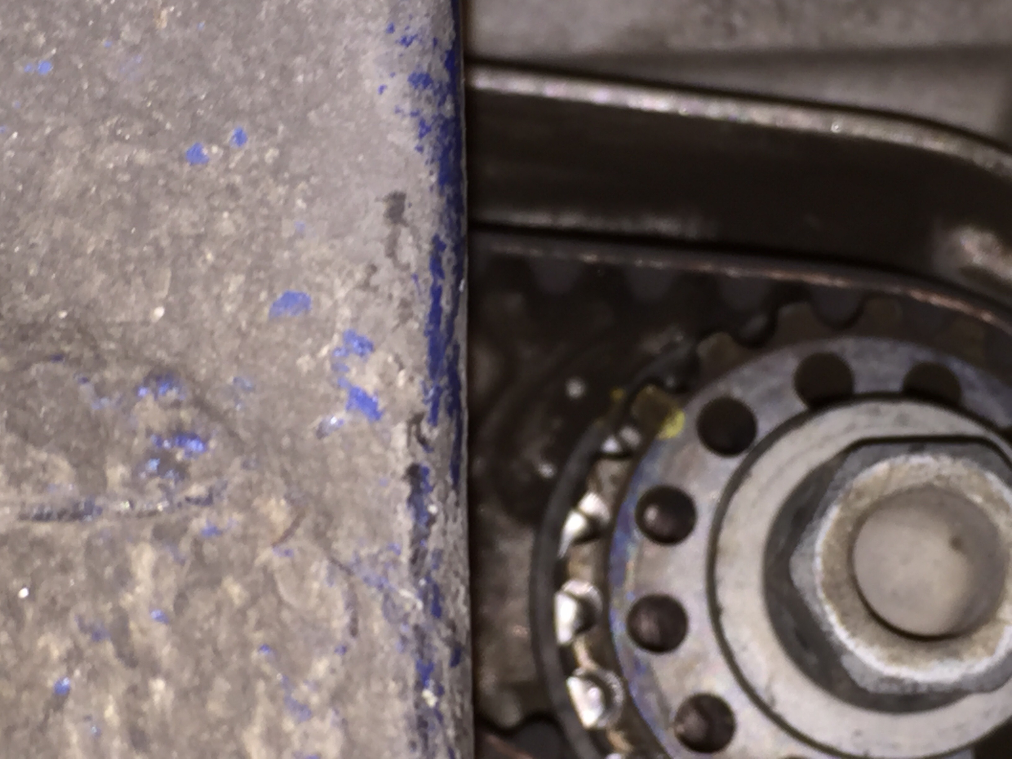

TWIZTIDBADHABITS

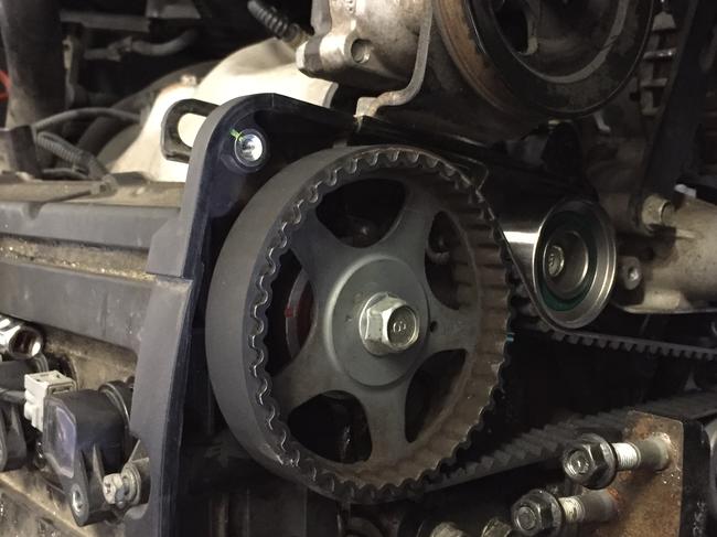

Timing belt snapped while driving I replace the timing belt I thought I wanted up bright started up it ran rough as hell took everything back off look at the timing the top crank pulley or shaft is off by half turn how do I correct this how do I set the timing
WRENCHTECH
  • 20,761 POSTS
You aren't off half a turn. If you rotate the engine one more turn it will be in time. It's a 2:1 ratio crank to cam. What you likely do have is bent valves.because that DOHC is an interference engine.

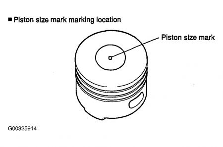

BRADP59
Engine Mechanical problem
2003 Kia Rio 4 cyl Two Wheel Drive 80000 miles
Replacing the head with a rebuilt. Planning to replace Pistons, rings, main bearings, rod bearings, oil pump, timing belt and tensioner.
Should I worry about the rods?

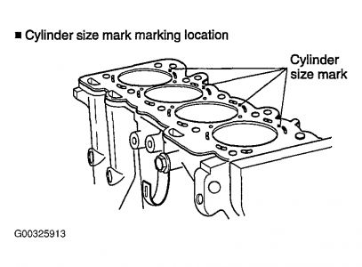

BRADP59
Thanks for the reply
Pistons were removed by teen age son and he did not keep track of which cylinder they came out of. The pistons have a front and back and two rods appear to be one direction and the other two reversed. Any ideas as to which cylinder should have which arrangement? The rods seem identical any harm if they go back in a different cylinder?
BLUELIGHTNIN6
  • 16,542 POSTS
the pistons have size marks on them that match up with their respective cylinder, the cylinders also have size marks on them. just match them up and you're good to go..
https://images.2carpros.com/forum/automotive_pictures/261618_Graphic_473.jpg
https://images.2carpros.com/forum/automotive_pictures/261618_Graphic2_68.jpg
