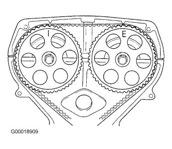

The information I'm looking for is which way does the pulleys actually go back on each cam? When looking at pictures 100_1377, 1378, and 1379, the pins on each cam and the "I" and "E" on the pulleys. The pulleys can either go on the cam facing the "I" or the "E".
I understand how to align the pulleys with the timing mark after the pulleys are on. But attaching the pulleys to the cam, do I also do the same for each pulley with the cam pins? Meaning, while putting pulley on the back cam or Intake cam, do I also put the cam pin facing the "I"? And the same for Exhaust "E" on the right cam?
hey man thanks again..
OHIO28
Oct 29, 2018 at 11:56 AM (Merged)
RACEFAN966
  • 5,029 POSTS
Ok here is a pic of what it should look like when they are installed. Hope this helps. Thanks.
https://images.2carpros.com/forum/automotive_pictures/249564_Graphic_60.jpg
OHIO28
  • 16 POSTS
racefan966---Sorry this is not what I'm asking. The picture 2CARPROs keep showing is the timing mark allignment after the pulleys are installed. I need information for installing the pulleys on the cams. See the pulleys can either go on at 12 or 6 o'clock. Which would effect the timing mark (the picture you attached).
I need the picture for putting on the pulleys on each cam. I wrote, "The information I'm looking for is which way does the pulleys actually go back on each cam? When looking at pictures 100_1377, 1378, and 1379, the pins on each cam and the "I" and "E" on the pulleys. The pulleys can either go on the cam facing the "I" or the "E".
I understand how to allign the pulleys with the timing mark after the pulleys are on. But attaching the pulleys to the cam, do I also do the same for eah pulley with the cam pins? Meaning, while putting pulley on the back cam or Intake cam, do I also put the cam pin facing the "I"? And the same for Ehaust "E" on the right cam?"
Please re-read the above question, yal have been great help in the past. Thank you
OHIO28.....
RACEFAN966
  • 5,029 POSTS
The guide slots are pointed down best I can tell. Here is the only other pic I can find.
https://images.2carpros.com/forum/automotive_pictures/249564_Graphic_62.jpg

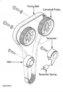

BMRFIXIT
  • 19,053 POSTS
TIMING BELT
Removal
Disconnect negative battery cable. Loosen power steering lock bolts and nuts, and remove tension from power steering and air conditioning compressor drive belt. Remove power steering and air conditioning drive belt.
Loosen and remove generator bolts. Remove water pump pulley. Remove crankshaft pulley and timing belt guide plate. Remove upper and lower timing belt covers.
Turn crankshaft so that timing mark on crankshaft sprocket is aligned with timing mark on engine.
Ensure "I" mark on intake camshaft sprocket is aligned with mark on cylinder head cover, and "E" mark on exhaust camshaft sprocket is aligned with mark on cylinder head cover. See Fig. 4 .
CAUTION:DO NOT move camshaft or crankshaft once timing marks have been correctly positioned.
Loosen tensioner pulley lock bolt.
While protecting timing belt with a rag, remove tensioner pulley. If belt is to be reused, mark direction of timing belt rotation for proper reinstallation. Remove timing belt.
Installation
Install tensioner pulley. Pull tensioner pulley to its furthest point, and tighten lock bolt. Check that timing mark on crankshaft sprocket is aligned with timing mark on engine.
Ensure that camshaft sprockets are aligned with marks on cylinder head cover.
Install timing belt onto crankshaft sprocket first, then idler pulley, exhaust camshaft sprocket, intake camshaft sprocket, and finally, tensioner pulley.
Ensure there is no looseness in belt between idler pulley and exhaust camshaft sprocket, or between intake and exhaust camshaft sprockets.
Loosen tensioner pulley lock bolt, and allow tensioner spring to apply tension to timing belt. DO NOT add additional tension. Tighten tensioner pulley lock bolt to specification.
Rotate crankshaft two full turns (clockwise only), and align timing mark on crankshaft sprocket with timing mark on engine block.
Ensure that marks on camshaft sprockets align with marks on cylinder head cover.
If marks do not align, remove timing belt and repeat process from tensioner installation.
Measure timing belt deflection by applying moderate pressure midway between camshaft sprockets. If deflection is not 0.39-0.50" (11-13 mm) with 22 lbs. (10 kg) of force applied, repeat installation process from tensioner installation.
Install lower and upper timing belt covers, timing belt guide plate and crankshaft pulley. Install water pump pulley. Tighten all bolts to specification.
Install generator belt and adjust tension. Install power steering and air conditioning drive belt, and adjust tension. Connect negative battery cable.
let me know

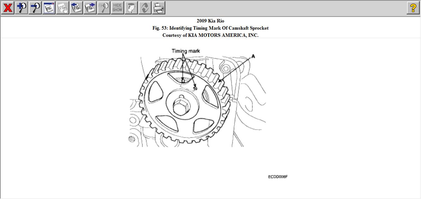

KG6TZE
Im wondering if the timing belt diagram and instructions for my 2009 Kia Rio is the same as all the other diagrams and instructions from differentit years, for changing it.
  • 75,992 POSTS
For what liter engine?
KG6TZE
1.6 dohc
  • 75,992 POSTS
Put piston no.1 on its compression stroke/TDC then align cam and crank sprockets markings indicated it the repair manual-

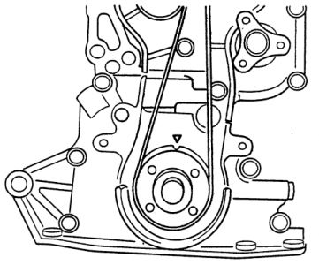

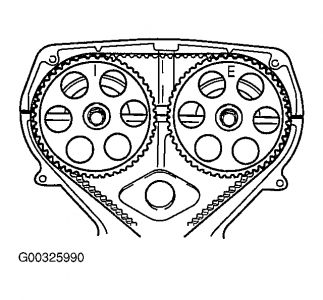

RICKYSAWYER
Engine Mechanical problem
2001 Kia Rio 4 cyl Front Wheel Drive Automatic
Where can I find a diagram for a ignition timing belt replacement indicating timing belt marks?
BLUELIGHTNIN6
  • 16,542 POSTS

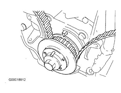

((Crankshaft sprocket timing belt alignment mark))
https://images.2carpros.com/forum/automotive_pictures/261618_0900c1528002849c_1.jpg

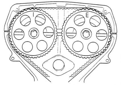

((Camshaft sprocket positioning for timing belt installation))
https://images.2carpros.com/forum/automotive_pictures/261618_0900c1528002849d_1.jpg

Turn crankshaft so that timing mark on timing belt pulley is aligned with timing mark on engine.
Check that "l" mark on intake camshaft pulley is aligned with mark on cylinder head cover and "E" mark on exhaust camshaft pulley is aligned with mark on cylinder head cover.

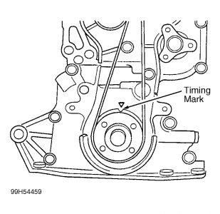

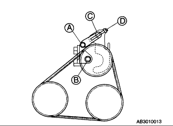

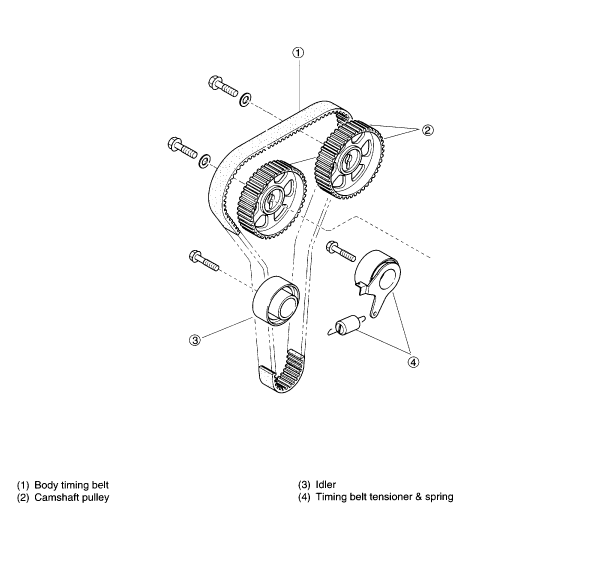

ANNEMURPHEY
I am having a difficult time finding the timing marks for this vehicle...please help.
Thanks,
Anne
BLUELIGHTNIN6
  • 16,542 POSTS
https://images.2carpros.com/forum/automotive_pictures/261618_Graphic_508.jpg
https://images.2carpros.com/forum/automotive_pictures/261618_Graphic2_75.jpg
https://images.2carpros.com/forum/automotive_pictures/261618_Graphic3_13.jpg

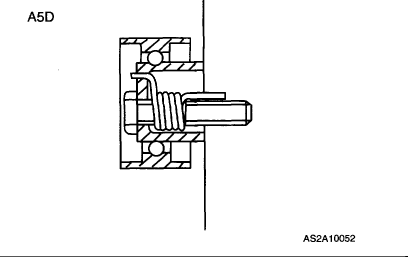

GAINESG
I was told that the timing belt should be changed at 75,000 miles. in addition i was told that the water pump andtensiner should also be changed. What is the average cost of repair for the timing belt? and should these other additions be performed or are there more?

BLUELIGHTNIN6
  • 16,542 POSTS
yes that is a good idea during timing belt replacement..
