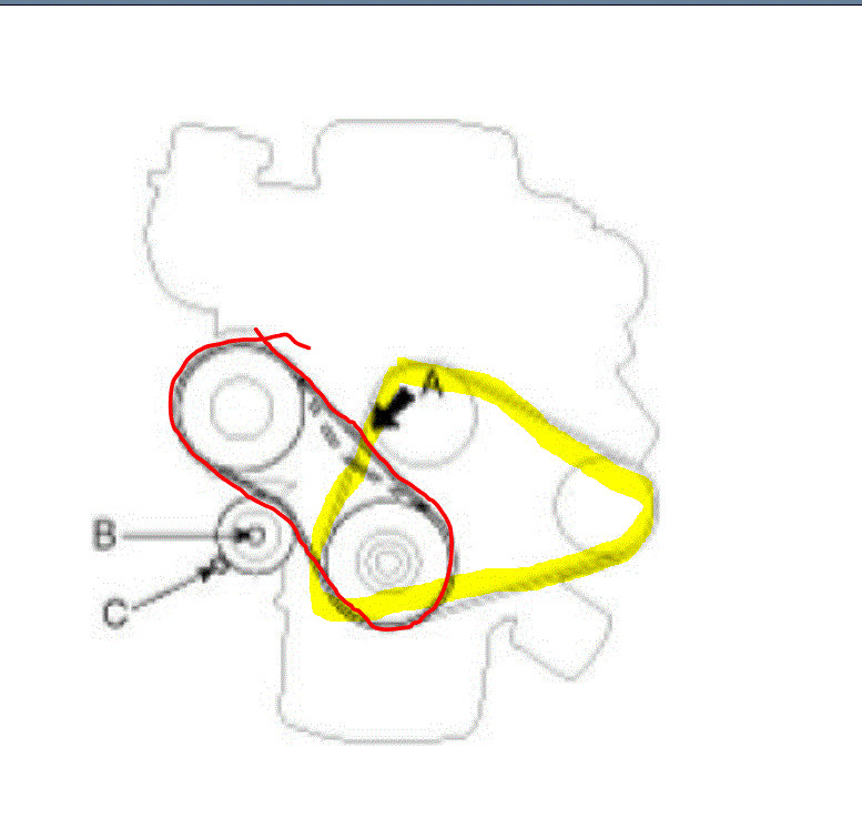

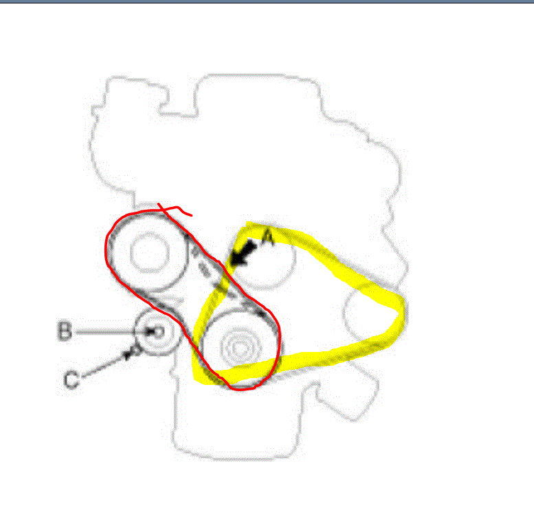

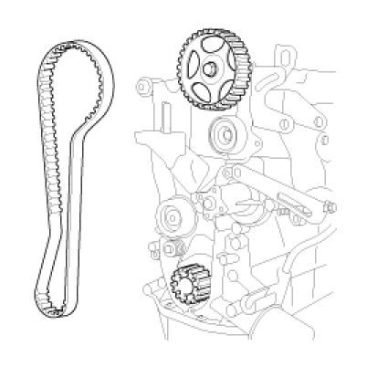

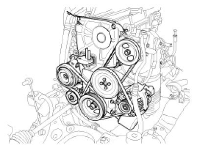

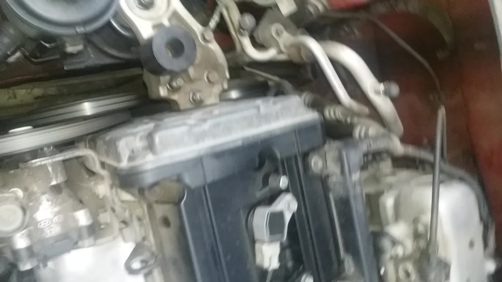

A squealing noise is usually a belt. I realize the A/C belt has been replaced already, but there are two belts on the vehicle that can cause an issue. Also, the A/C belt isn't an automatic tightening belt, so it may have stretched and come loose.
If you take a look at the attached picture, you will see both belts. The one I circled in red is the A/C belt. I need you to check that both are tight. Do this and let me know what you find.

Was only one belt replaced? There are two. Also, is it possible for you to record what you hear with your phone and upload it for me to hear?

Are you saying there is two A/C belts? I also changed the alternator belt and timing belt. I can try to record the noise.

No. There are a total of two accessory drive belts. One for the AS and the other the alt. I didn't realize both were replaced. Also, the timing belt won't squeal. Now, although both accessory drive belts have been replaced, you could have a tension issue. In other words, the belt isn't tight enough.
If possible, record it so I can hear it. I should be able to tell if it is a belt noise.

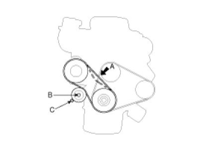

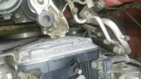

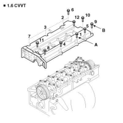

The belts on this vehicle are tightened manually. Here are the directions. The attached pic correlates with the directions.
________________
2008 Kia Rio L4-1.6L
Adjustments
Vehicle Engine, Cooling and Exhaust Engine Drive Belts, Mounts, Brackets and Accessories Drive Belt Adjustments
ADJUSTMENTS
ADJUSTMENT
1. Loosen the tension mounting bolt (B).
2. Turn the adjusting bolt (C) to obtain the proper belt tension, and then retighten the mounting bolt (B).
3. Recheck the deflection of the A/C compressor belt.
Pic 1

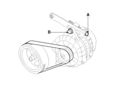

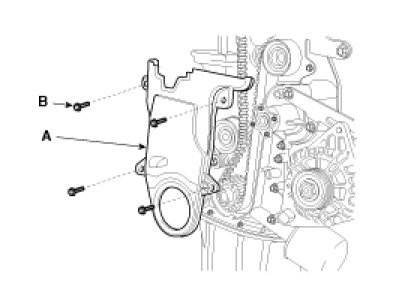

Here are the directions for adjusting the alternator belt.
Alternator
Vehicle Engine, Cooling and Exhaust Engine Drive Belts, Mounts, Brackets and Accessories Drive Belt Testing and Inspection Component Tests and General Diagnostics Alternator
ALTERNATOR
GENERATOR BELT INSPECTION AND ADJUSTMENT
NOTE:

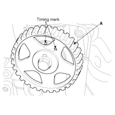

When using a new belt, first adjust the deflection or tension to the values for the new belt, then readjust the deflection or tension to the value for the used belt after running engine for five minutes.
Deflection method:
Apply a force of 98N (10kg, 22lb), and measure the deflection between the generator and the water pump pulley.
Deflection
Used belt: 4.2 - 4.7 mm (0.1654 - 0.1850 in)
New belt: 3.3 - 3.7 mm (0.1299 - 0.1457 in)
NOTE:
If the belt is worn or damaged, replace it.
pic 2

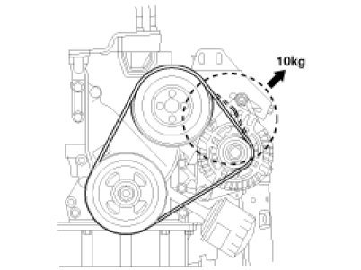

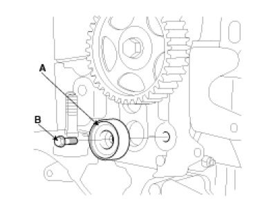

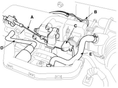

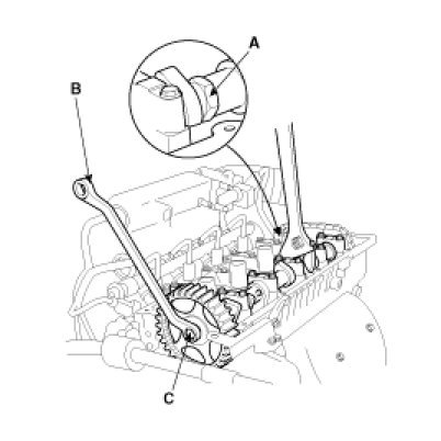

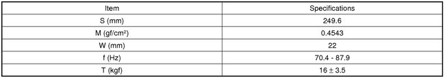

Belt tension gauge method:
Attach the belt tension gauge to the belt and measure the tension. Follow the gauge manufacturer's instructions.
Tension
Used belt: 392.3 - 490.3N (40 - 50kg, 88.2 - 110.2lb)
New belt: 637.4 - 735.5N (65 - 75kg, 143.3 - 165.3lb)
NOTE:
pic 3

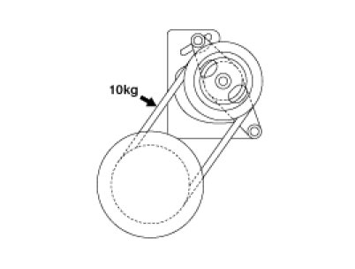

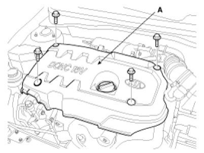

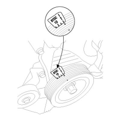

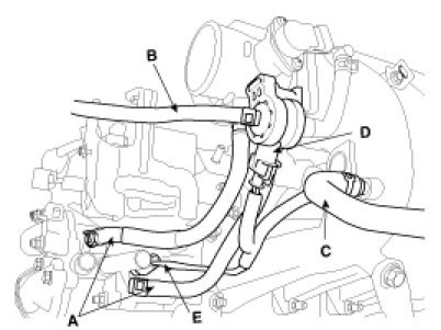

If adjustment is necessary:
1. Loosen adjusting bolt (A) and the lock bolt (B).
2. Move the generator to obtain the proper belt tension, then retighten the nuts.
pic 4
3. Recheck the deflection or tension of the belt.

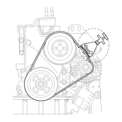

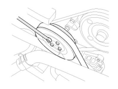

Here are the directions for the power steering.
Steering
Vehicle Engine, Cooling and Exhaust Engine Drive Belts, Mounts, Brackets and Accessories Drive Belt Testing and Inspection Component Tests and General Diagnostics Steering
STEERING
SERVICE ADJUSTMENT PROCEDURE

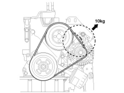

CHECKING POWER STEERING BELT TENSION

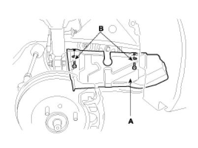

1. Press the V belt, applying a pressure of 98N (10kg, 22lb) at the specified point and measure the deflection to confirm that it is within the standard value.
Standard value
V belt deflection : 7 - 10 mm (0.27 - 0.39 in)
pic 5

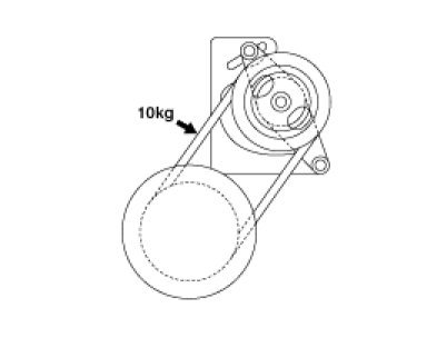

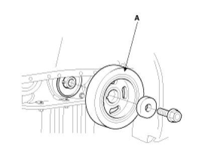

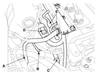

2. If the belt deflection is beyond the standard value, adjust the belt tension as follows.

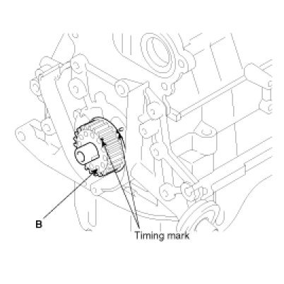

(1)Loosen the bolt(A) adjusting the power steering V belt tension.
pic 6
(2)Put a bar or equivalent, between the bracket and the oil pump and adjust the tension so that the belt deflection is within the standard value.
(3)Tighten the bolt adjusting the power steering V belt tension.
(4)Check the belt deflection and adjust it again if necessary.
CAUTION:
After turning the V belt in the normal rotation direction more than once, recheck the belt deflection.
____________________________
Let me know if this helps. Also, since the belts were replaced, it isn't uncommon for them to stretch a bit. They most likely need readjusted.
Let me know if I can help or if you have other questions.

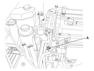

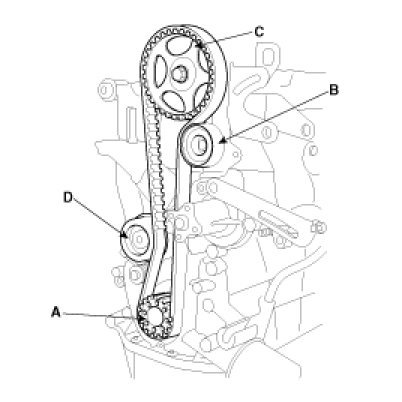

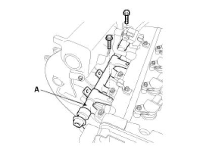

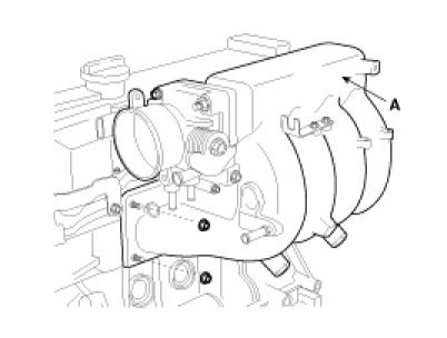

Repair Procedures
Vehicle Engine, Cooling and Exhaust Engine Intake Manifold Service and Repair Removal and Replacement Repair Procedures
REPAIR PROCEDURES
REMOVAL

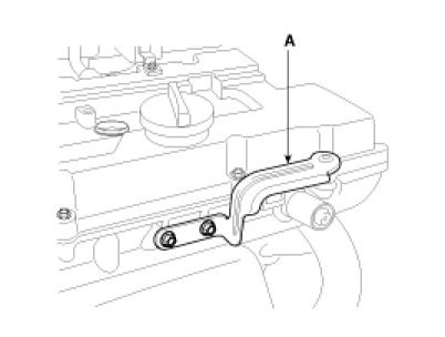

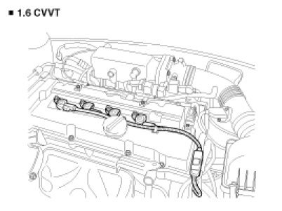

1. Remove the engine cover(A).
pic 1
2. Remove the accelerator cable(A).
3. Disconnect the TPS (Throttle Position Sensor) connector (B).
4. Disconnect the ISA(Idle Speed Actuator) connector(B).
5. Disconnect the PCV(Positive Crankcase Ventilation) hose(D) and breather hose(E).
pic 2

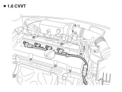

6. Disconnect the injector connector (No. 3, 4) (A).
7. Disconnect the injector connector (No. 1, 2) (B).
pic 3

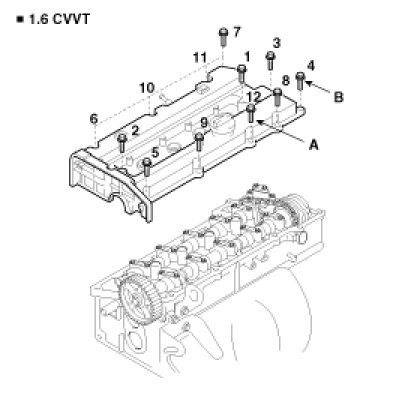

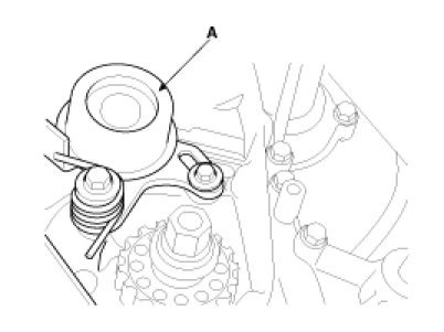

8. Remove the heater hose(A), PCSV(Purge Control Solenoid Valve)(B) and the brake vacuum hose(C) from throttle body and intake manifold.
9. Disconnect the PCSV(Purge Control Solenoid Valve) (D) and water temperature sensor connector(E).
pic 4

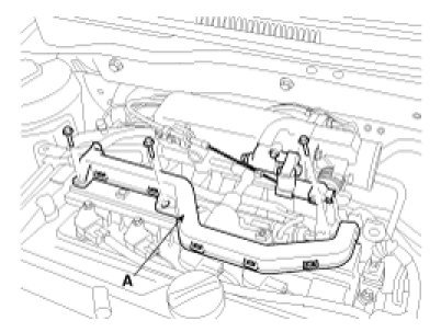

10. Remove the delivery pipe(A).
Tightening torque :
18.6 - 27.5N.m (1.9 - 2.8kgf.m, 13.7 - 20.3lb-ft)
pic 5

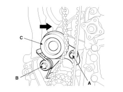

11. Remove the intake manifold stay(A).
Tightening torque :
17.7 - 24.5N.m (1.8 - 2.5kgf.m, 13.0 - 18.1lb-ft)
pic 6
12. Remove the intake manifold.
Tightening torque :
14.7 - 19.6N.m (1.5 - 2.0kgf.m, 10.8 - 14.5lb-ft)
pic 7
13. Installation is in the reverse order of removal with new gasket.

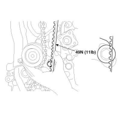

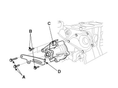

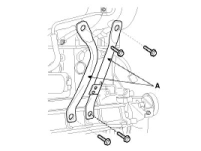

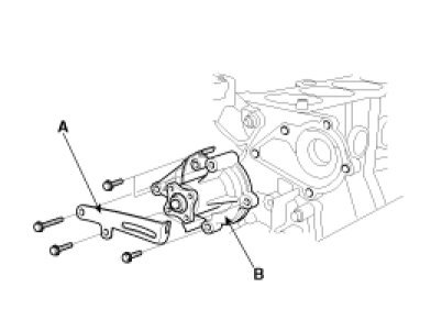

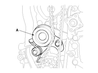

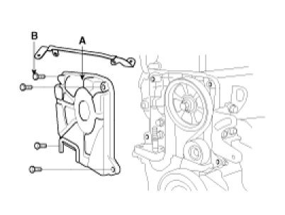

Here are the directions for the pump. This is a bigger job than normal because the pump is run by the timing belt. I will include directions for timing belt removal and replacement last.
_________________________________________________
Repair Procedures
Vehicle Engine, Cooling and Exhaust Engine Water Pump Service and Repair Removal and Replacement Repair Procedures
REPAIR PROCEDURES
REMOVAL
WATER PUMP
1. Drain the engine coolant.
WARNING:
System is under high pressure when the engine is hot.
To avoid danger of releasing scalding engine coolant, remove the cap only when the engine is cool.

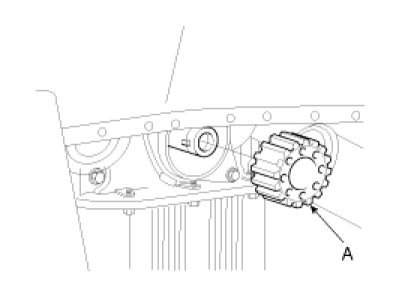

2. Loosen the water pump pulley bolts.
3. Remove the drive belts.
pic 8

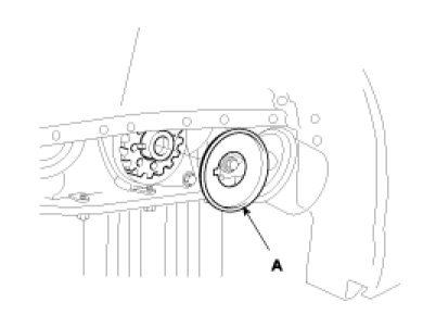

4. Remove the water pump pulley.
5. Remove the timing belt.
6. Remove the timing belt idler.
7. Remove the water pump.
(1)Remove the 2 bolts and alternator brace(A).
(2)Remove the 3 bolts and remove the water pump(B) and gasket.
pic 9
pic 11

3. Remove the 2 bolts(B) and RH side cover(A).
pic 12
4. Temporarily loosen the water pump pulley bolts.
pic 13
5. Remove the alternator drive belt(A).
image 6. Remove the air conditioner compressor drive belt(B).
7. Remove the power steering pump drive belt(C).
8. Remove the 4 bolts and water pump pulley.

10. Turn the crankshaft pulley, and align its groove with timing mark "T" of the timing belt cover. Check that the timing mark of camshaft sprocket is aligned with the timing mark of cylinder head cover. (No.1 cylinder compression TDC position)
pic 15
pic 16
11. Remove the crankshaft pulley bolt and crankshaft pulley(A).
pic 17

13. Remove the 4 bolts(B) and timing belt lower cover(A).
pic 20
14. Remove the timing belt tensioner(A) and timing belt.
pic 21
pic 22

15. Remove the bolt(B) and timing belt idler(A).
pic 23

17. Remove the cylinder head cover.
(1)Remove the wire harness bracket(A).
image (2)Remove the ignition coil.
pic 25
(3)Remove the PCV (Positive Crankcase Ventilation) hose(A) and the breather hose(B) from the cylinder head cover.
pic 26

(5)Loosen the cylinder head cover bolts(B) and then remove the cover(A) and gasket.
pic 28
18. Remove the camshaft sprocket.
(1)Hold the portion(A) of the camshaft with a hexagonal wrench, and remove the bolt(C) with a wrench(B) and remove the camshaft sprocket.
pic 29
CAUTION:
Be careful not to damage the cylinder head and valve lifter with the wrench.

1. Install the camshaft sprocket and tighten the bolt to the specified torque.
(1)Temporarily install the camshaft sprocket bolt(C).
(2)Hold the portion(A) of the camshaft with a hexagonal wrench, and tighten the bolt(C) with a wrench(B).
Tightening torque :
78.5 - 98.1N.m (8.0 - 10.0kgf.m, 57.9 - 72.3lb-ft)
pic 30
2. Install the cylinder head cover.
(1)Install the cylinder head cover(A) and bolts(B).
Tightening torque :
7.8 - 9.8N.m (0.8 - 1.0kgf.m, 5.8 - 7.2lb-ft)
pic 31

(3)Install the PCV(Positive Crankcase Ventilation) hose(A) and breather hose(B) to the cylinder head cover.
pic 33

3. Install the crankshaft sprocket(A).
pic 35
4. Align the timing marks of the camshaft sprocket(A) and crankshaft sprocket(B) with the No.1 piston placed at top dead center and its compression stroke.
pic 36
pic 37
5. Install the idler pulley(A) and tighten the bolt(B) to the specified torque.
Tightening torque :
42.2 - 53.9N.m (4.3 - 5.5kgf.m, 31.1 - 39.8lb-ft)
pic 38
6. Temporarily install the timing belt tensioner(A).
pic 39
7. Install the belt so as not give slack at each center of shaft. Use the following order when installing timing belt.
Crankshaft sprocket(A) ->idler pulley(B) ->camshaft sprocket(C) ->timing belt tensioner(D).
pic 40
8. Adjust the timing belt tension.
(1)Loosen the tensioner pulley mounting bolt and apply tension to the timing belt.
pic 41
(2)After checking the alignment between each sprocket and each timing belt tooth, tighten the mounting bolt (A) and (B) one by one.
Tightening torque :
19.6 - 26.5N.m (2.0 - 2.7kgf.m, 14.5 - 19.5lb-ft)
(3)Then recheck the belt tension.
Verify that when the tensioner and the tension side of the timing belt are pushed in horizontally with a moderate force [approx. 49N (11lb)], the timing belt cog end is approx. 1/2 of the tensioner mounting bolt head radius (across flats) away from the bolt head center.
pic 42
(4)Timing belt tension measuring procedure
(by a sonic tension gauge)
Rotate crankshaft in clockwise direction to set 1st piston on top dead center (TDC) and rotate crankshaft in counterclockwise to 90° then measure the belt tension in the middle of tension side span (in arrow direction of above illustration) by free vibration method.
CAUTION:
Avoid rotating the crankshaft in a counter clockwise direction.
Engine damage could occur.
Conversion equation of frequency into tension :
T = (4 / 9.8) x S2 x M x W x f2 / 100000000
S : Measured belt span (mm)
M : Unit weight of belt (kgf/cm2)
W : Belt width (mm)
f : Transverse natural frequency of belt (Hz)
Timing Belt Specifications

10. Install the timing belt lower cover(A) with 5bolts(B).
Tightening torque :
pic 44
11. Install the flange and crankshaft pulley(A), and then tighten crankshaft pulley bolt.
Make sure that crankshaft sprocket pin fits the small hole in the pulley.
Tightening torque :
137.3 - 147.1N.m (14.0 - 15.0kgf.m, 101.3 - 108.5lb-ft)
