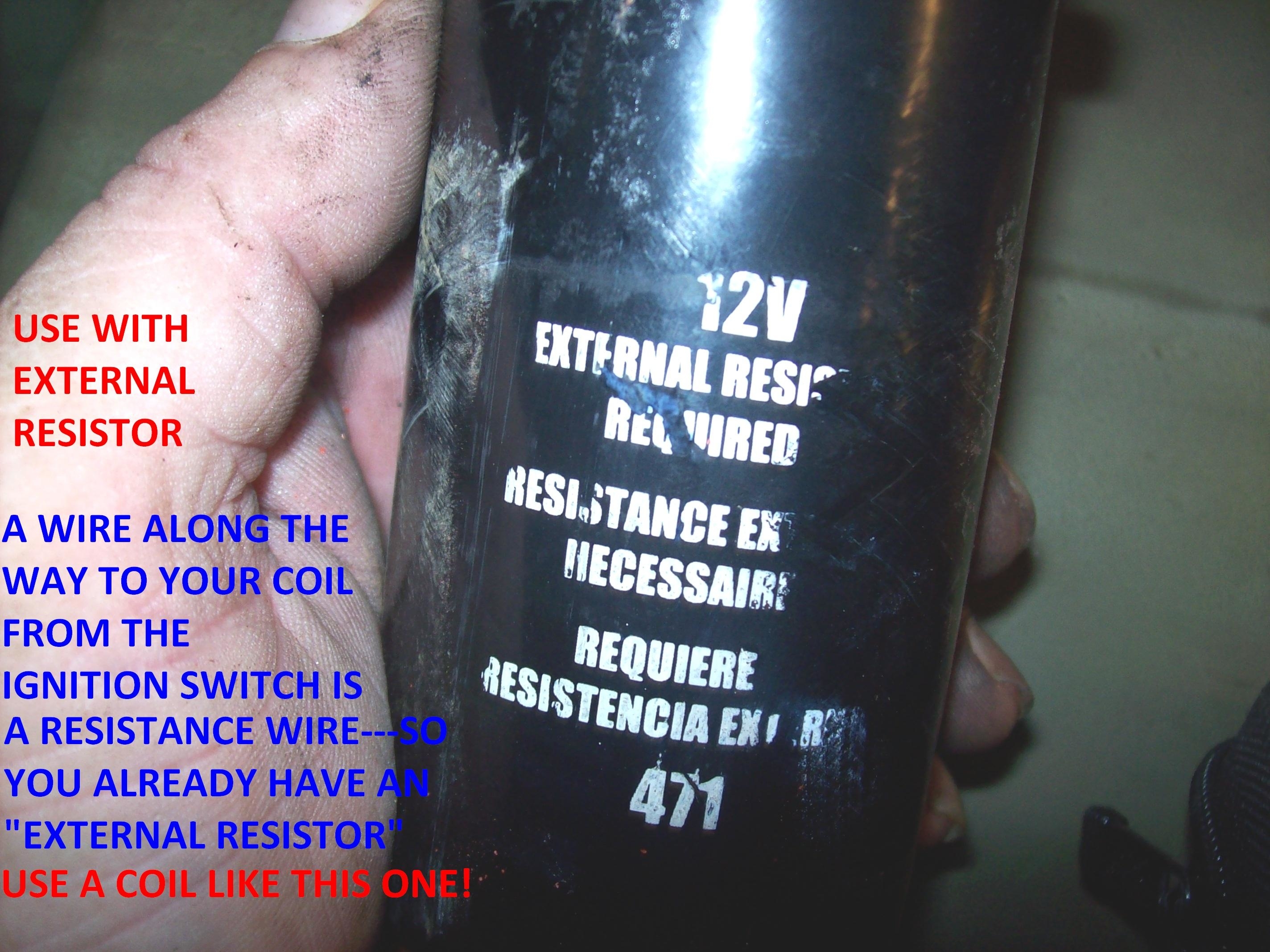

Can you have both modules tested at the parts store? I have gotten New bad modules before, anymore I have them test the new one before I leave the store. (picture 1)
Key on, what is the voltage at the positive side of the coil?

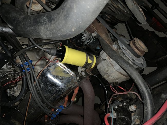

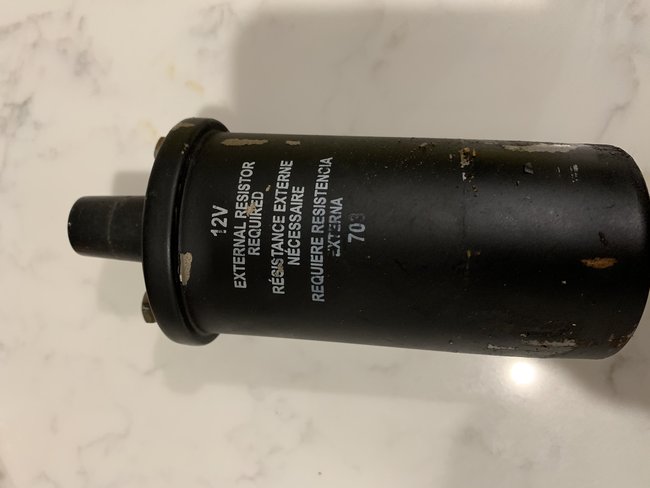

Do you have the correct coil? (picture 2)

I will get the modules checked this week. The coil was replaced today. The yellow coil is new and the black coil was the existing one.
