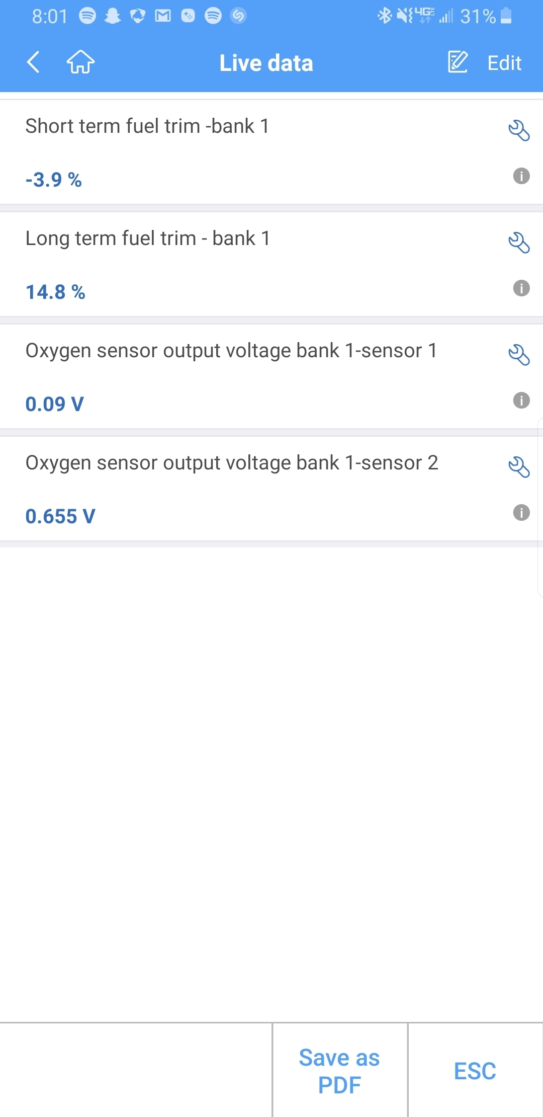

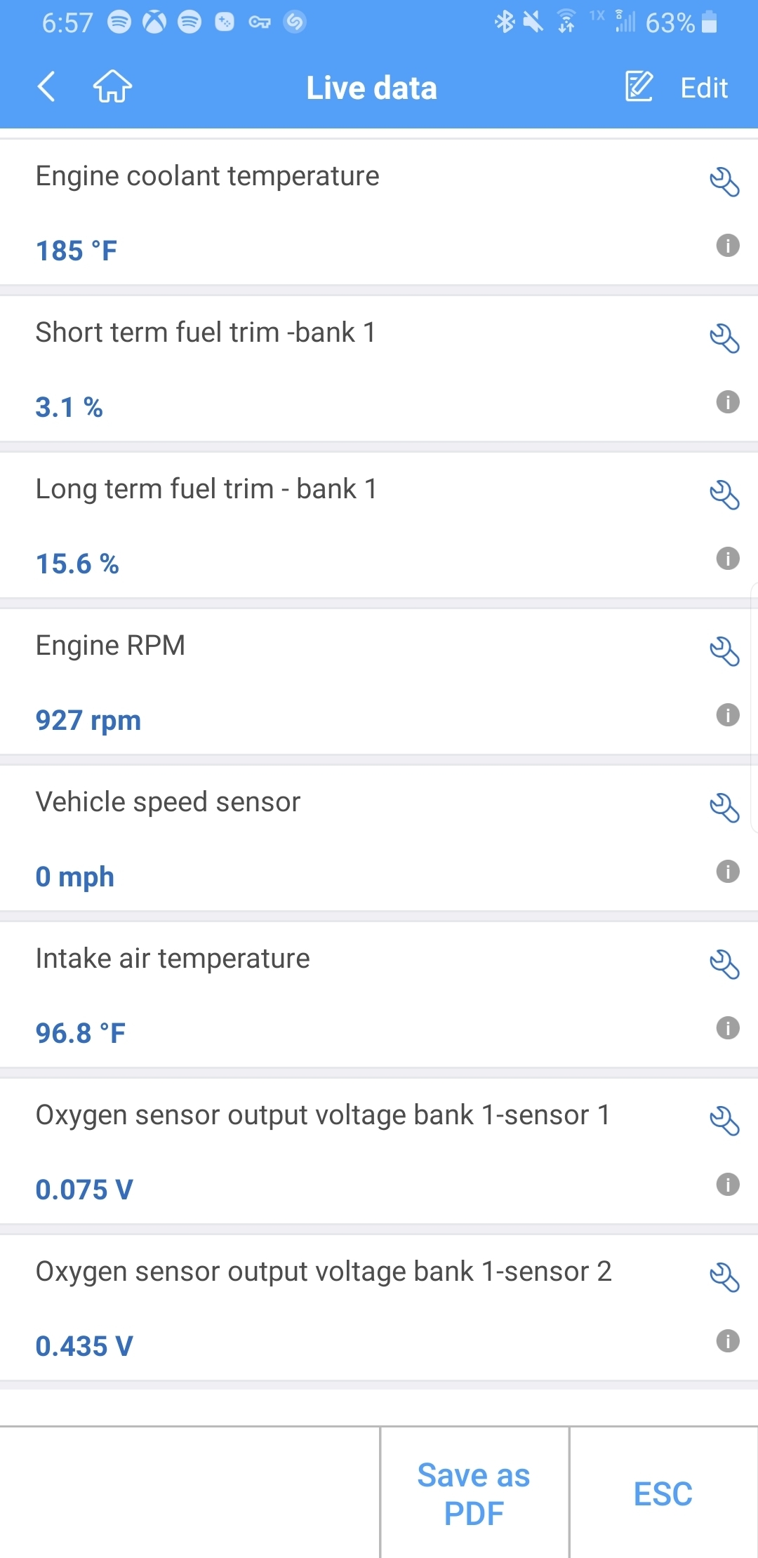

Hi, my car listed above with the 3800 not supercharged motor cranks for about 6 seconds on normal days above 20 degrees F. But during the winter the car wont start at all it will fire on a couple cylinders for the first second then after that i get nothing. no action. Its like if it flooded itself. The only way to start it is if you hold the throttle wide open and start cranking I took a picture of my fuel trims at idle. I am thinking it is a vacuum leak but i cannot find it at all. Because of the positive fuel trims.
I just replaced the fuel pump and filter and we have good fuel pressure and a strong spark on all 6. Thanks

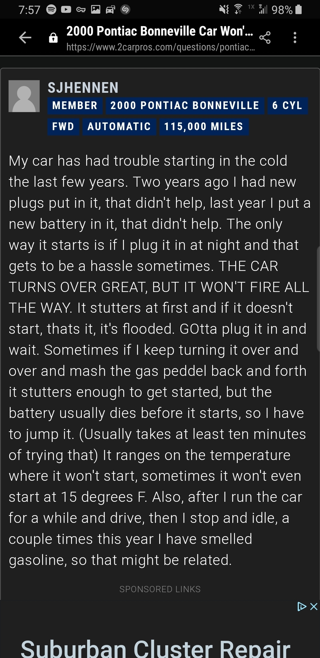

This guy explains exactly what my car does during the winter.

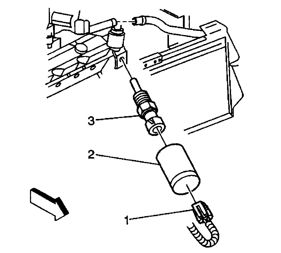

Also, here are the directions for replacing the sensor if you find it is the problem. The attached pic correlates with the directions. Now please keep in mind that the number of miles on the engine may have an affect on engine compression. That too can cause a hard start, especially in cold conditions.
2000 Pontiac Bonneville V6-3.8L VIN K
Engine Coolant Temperature (ECT) Sensor Replacement
Vehicle Power-train Management Sensors and Switches - Power-train Management Sensors and Switches - Computers and Control Systems Coolant Temperature Sensor/Switch (For Computer) Service and Repair Procedures Repair Instructions Engine Coolant Temperature (ECT) Sensor Replacement
NOTE: Use care when handling the coolant sensor. Damage to the coolant sensor will affect the operation of the fuel control system.
pic 1
REMOVAL PROCEDURE
IMPORTANT: Care must be taken when handling the Engine Coolant Temperature (ECT) sensor. Damage to the sensor will affect the operation of the fuel injection system.
CAUTION: Refer to Battery Disconnect Caution in Service Precautions.
1. Disconnect the negative battery cable.
2. Drain the radiator coolant. Refer to Draining and Filling Cooling System in Cooling System.
3. Disconnect the electrical connector (1) from the ECT sensor (3).
4. Remove the ECT sensor shield (2) from around the sensor.
5. Remove the ECT sensor from the engine.
INSTALLATION PROCEDURE
IMPORTANT: Care must be taken when handling the engine coolant temperature sensor. Damage to the sensor will affect the operation of the fuel injection system.
NOTE: Refer to Component Tightening Notice in Service Precautions.
1. Hand-start the ECT sensor (3) into the engine.
2. Tighten the ECT sensor.
Tighten
Tighten the sensor to 25 N.m (18 lb ft).
3. Install the ECT sensor shield (2) around the ECT sensor.
4. Connect the electrical connector (1) to the ECT sensor (3).
5. Refill the radiator with coolant. Refer to Draining and Filling Cooling System in Cooling System.
6. Connect the negative battery cable.
7. Start the engine.
8. Check for coolant leaks
9. Check the coolant level.

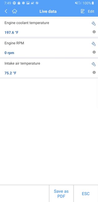

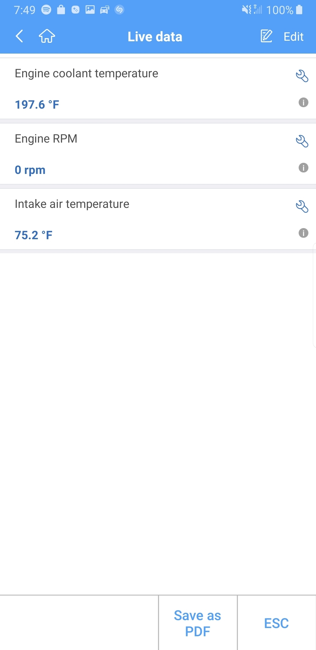

Yes, i do have a live data scan tool. I will let you know tomorrow morning. i just got done driving it so the motor is hot. The vehicle also has a intake air temperature could that also cause the issue if it is bad?

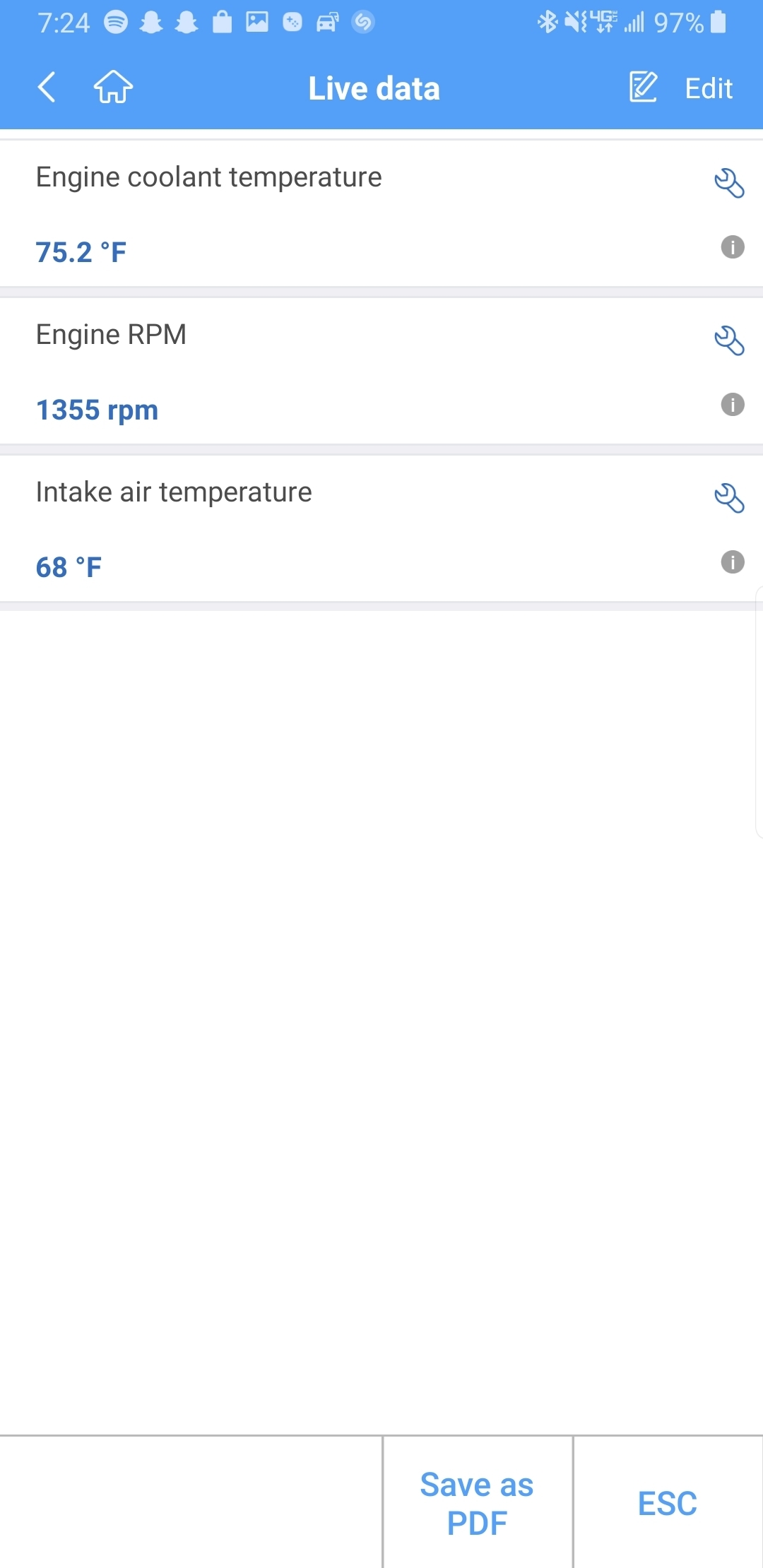

The first one is after a drive and the second one is when the engine is cold in the morning the outside temperature was around 52 degrees Fahrenheit. I am assuming that they are working correctly.

Those look normal. Have you ever checked compression? Does the engine have 200+K miles on it?
As far as the IAT, it looks right also. Were the temps cold approximately what the outside ambient temperature was?

So i just took a picture of the fuel trims at idle and i have done some research. i am told that anything above a 10% for a ltft is not good. And many symptoms of a vacuum leak are what i am experiencing. Can this be true?

In a perfect world, fuel trims should be close to 0. However, long term trims can vary based on driving conditions. The short term ones are the ones of most interest. And yes, it you show a positive trim, you the computer is trying to add fuel due to a lean mixture.
