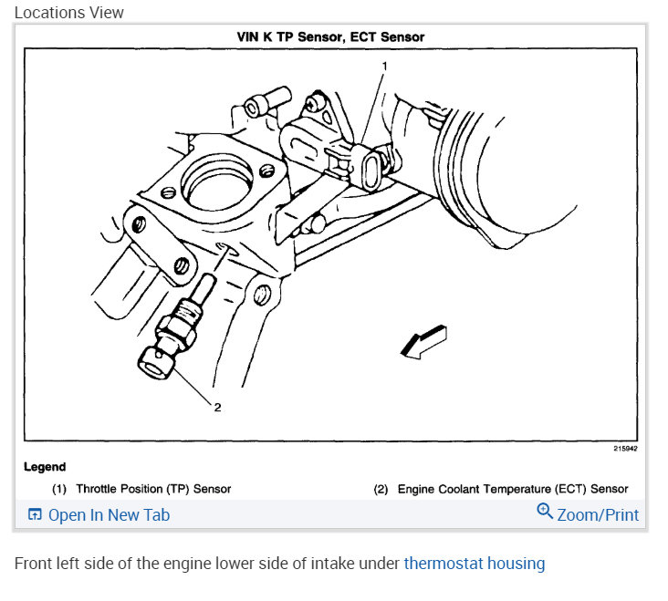

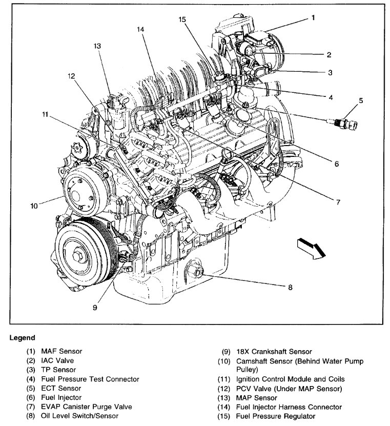

This condition can be caused by a bad engine coolant temperature sensor here is the location so you can change it out to see what happens. This guide will walk you through the steps with diagrams below to show you on your car.
https://www.2carpros.com/articles/coolant-temperature-sensor-cts-replacement
Check out the diagrams (Below). Please let us know what you find.

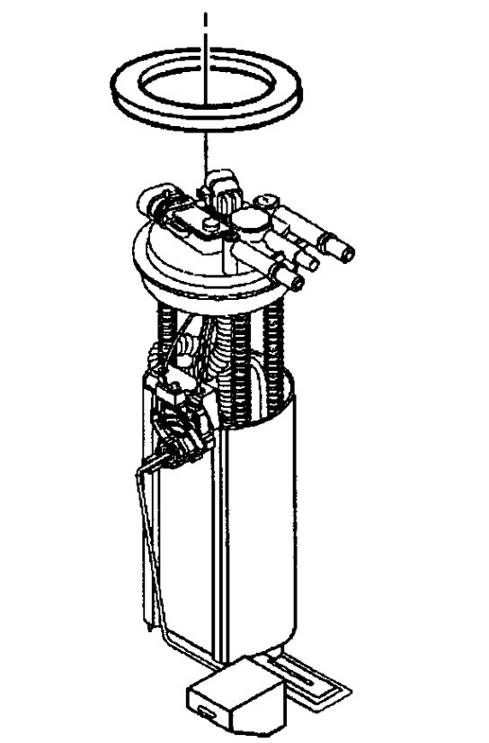

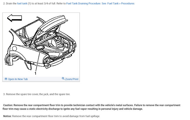

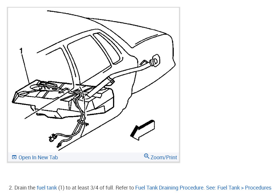

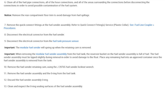

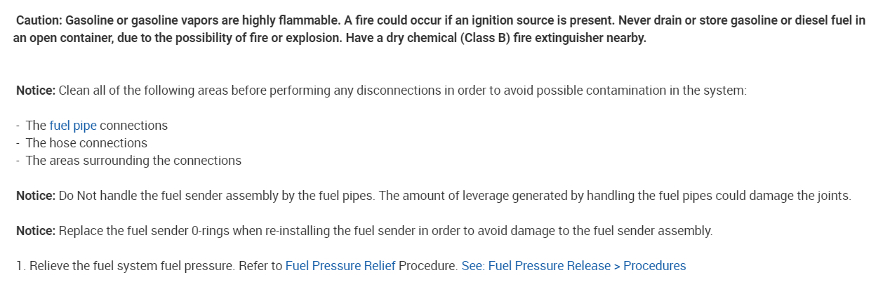

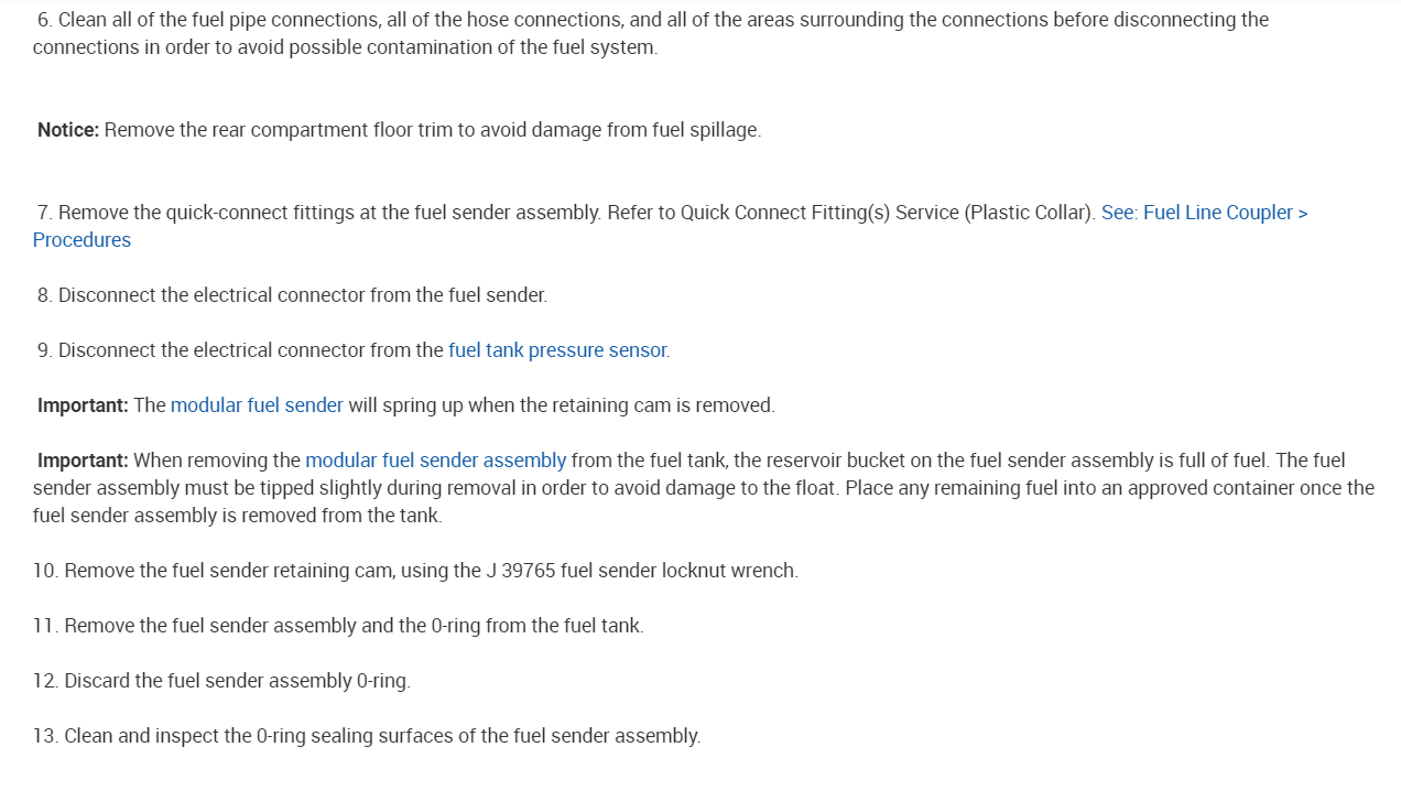

Those compression readings are a little low, did you use OEM sprak plugs? (it makes a difference) Also the fuel pressure is a little low as well which can be the problem. It should be:
Key ON, Engine OFF 48-55 psi
Engine Running Pressure Drop 3-10 psi

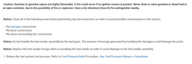

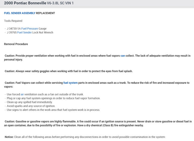

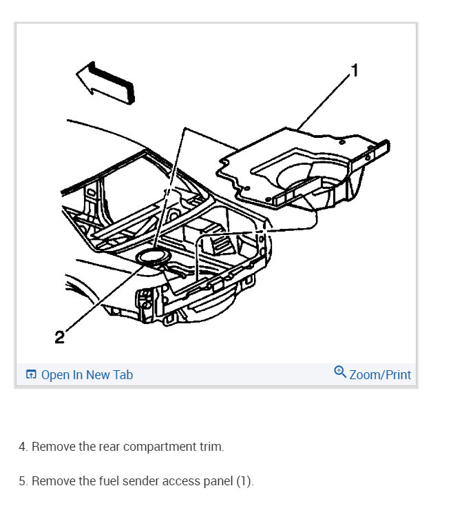

I would replace the fuel pump. here is a guide to help walk you through the steps with diagrams below to show you how on your car. You will need to drain the tank.
https://www.2carpros.com/articles/how-to-replace-an-electric-fuel-pump
and
https://youtu.be/Q5MH2gnyFH0
